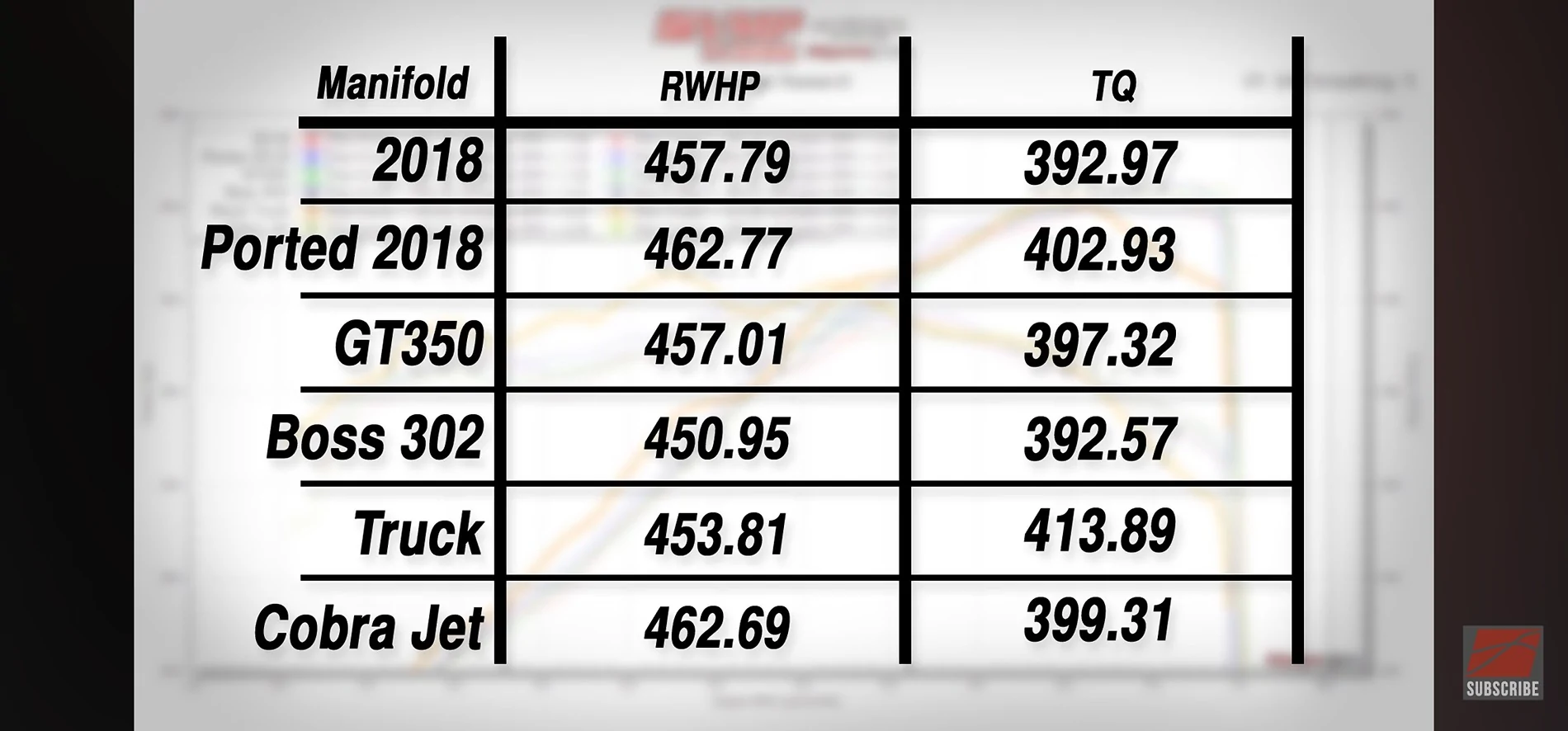

I got my Power Pack 3 NIB used for 850 a few weeks ago. I think ford stopped selling them when the 2018 manifold proved to be a better upgrade(especially if ported). You get gains in HP and torque from the 18. You lose torque with the 350 intake but gain HP and higher redline. But its just my opinion.

I mean it's really only meant for existing GT350 owners to replace a damaged part, and with the low production numbers and discontinuation of the car they figured they could charge a premium. The same thing happened with FP when they took the $500 OEM unit, slapped on a different part number and listed it for $750 on their website.
At this point in the game, it makes almost 0 sense for any GT owner to get it vs. the 18-23 manifold.

(Courtesy of VMP)
The numbers don't lie the redline is one of the big difference too. I am putting on the power pack 3 for the sole reason that cost-wise i get a manifold, CAI (which sucks i know), and tune for less than a 18 swap and tune. If I hadn't found this kit I would be putting a 18 on. But for me 850 was the bargain.
