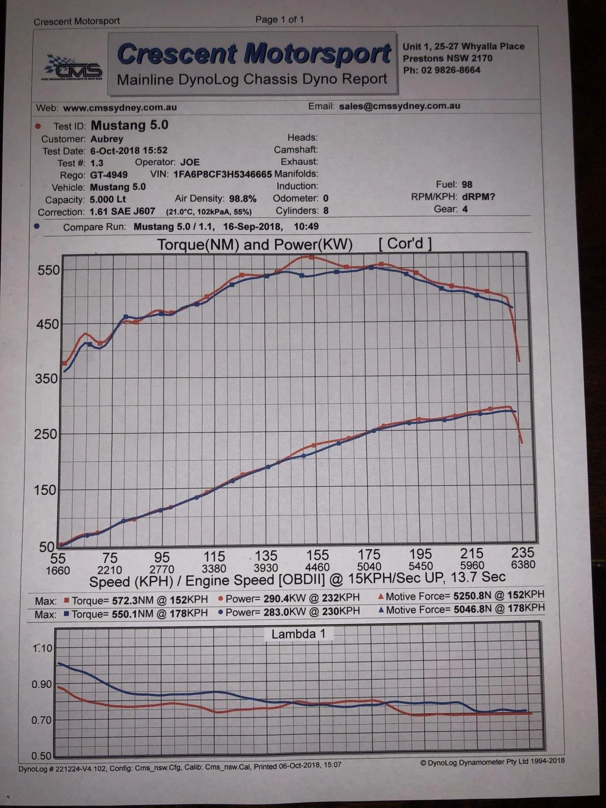

Very happy with my PP2, and dumped the Pedal Commander. It’s what the car should have had from factory, with the Track handling pack.
