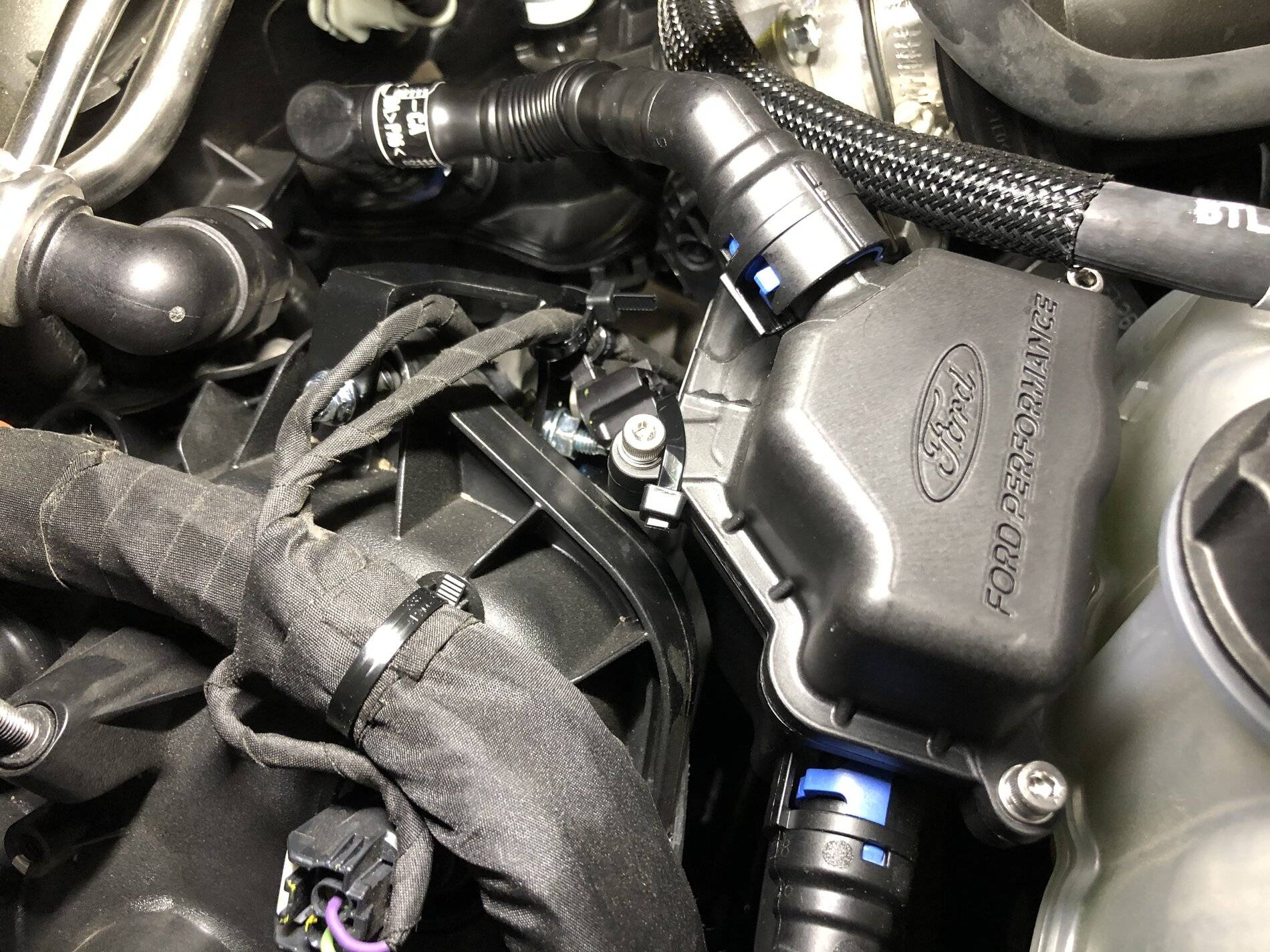

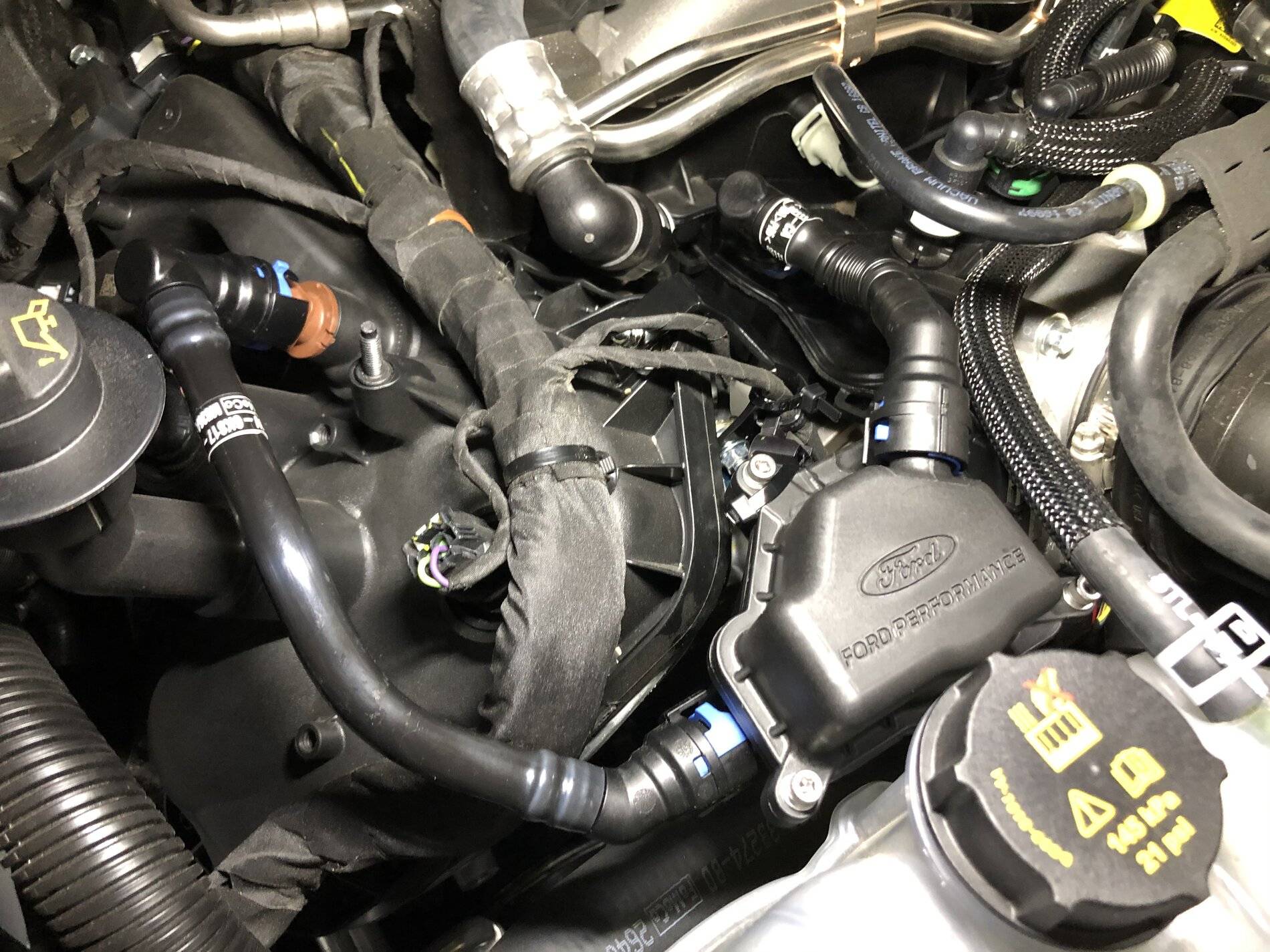

Hey guys,
Just installed a Ford performance passenger side oil separator on my 2020 PP2.

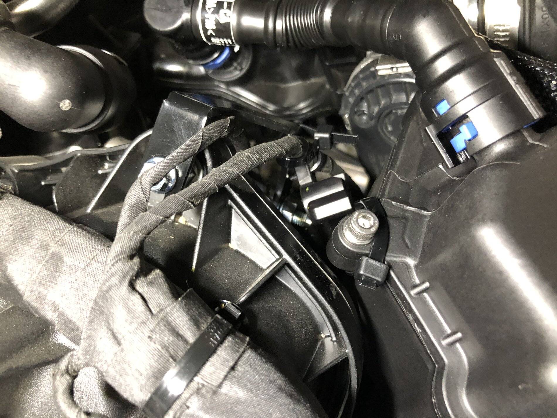

Install went smoothly, did everything by the book. Only thing that has my puzzled is how the separator itself is secured to the provided mount... there is a slot for the separator to slide onto, but it’s quite loose (up and down). The little tension put on it by the hoses won’t allow it to rest securely at the bottom of the mount.
The only thing I could think of was to zip ties it down to keep it from flopping up and down.
Anyone else encountered this? Seems like a strange design. They should have put a little rubber into the slot on the separator to hold it down fully seated into the mount...

Could you explain what you mean by “push clip”? Is it tight fitting. Or locking?
When I say loose. It fits into the slot perfectly, but it wants to sit high in the slot. Even without the hoses connected it’s quite sloppy (up and down). Then when you put the hoses on, it just sits about 1/2” high on the mount. Which can be pushed back down, but it pops back up. The zip tie keeps it down, but seems silly?

I ran into the same issue. Once the hoses are attached the separator would lift a bit. No matter how I adjusted it I would run into the same issue.
Like you, I used a zip tie to hold it down.

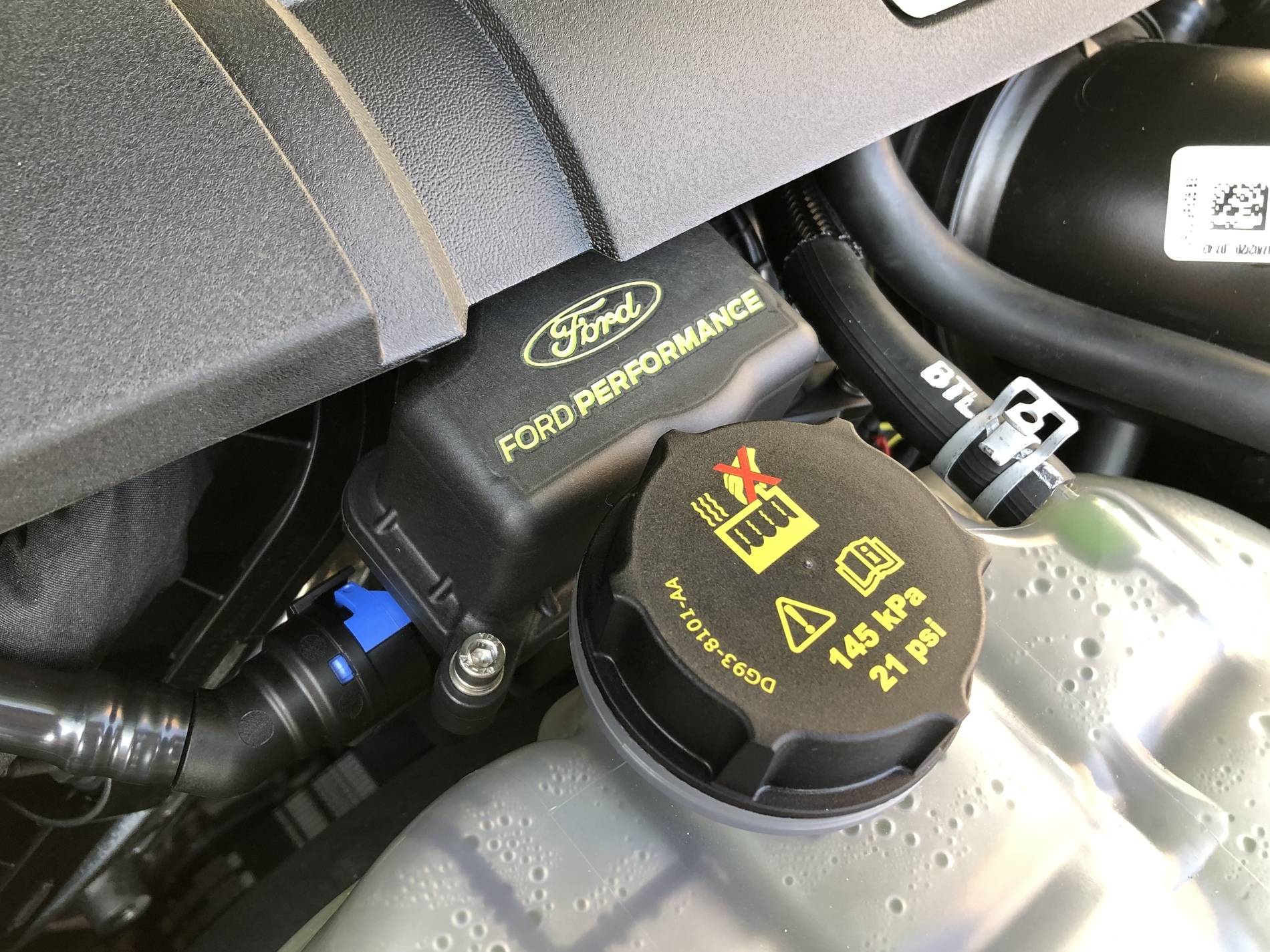

Yeah mine rose up the bracket a little when new - I assume from the fit of the plastic hoses.
It didn't bother me as it wasn't touching the engine cover and the engine cover would prevent it from coming off the bracket anyway.
I think with heat cycles it's now relaxed a little anyway :like:

This was when it first went on :
I think that gap is a little bigger now and the separator never got high enough to touch the cover even when new :like:
