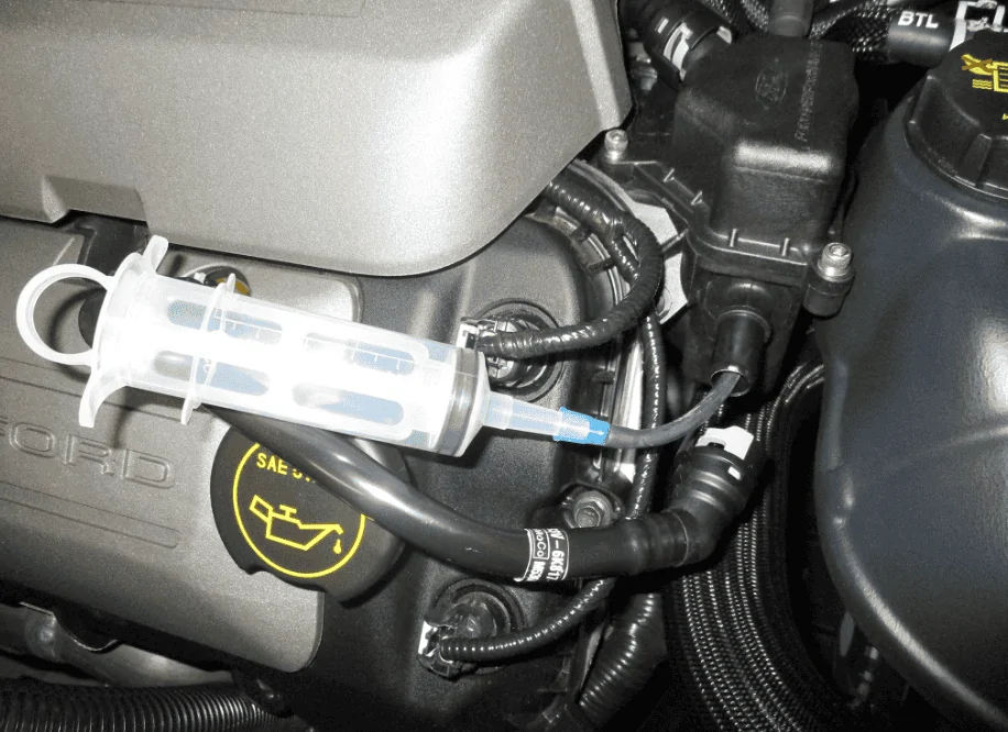

I just ordered one, which is on its way. On the Bullitt, it should be relatively easy to service, since there's no pesky engine cover. Quick question: Which is the best way to empty it? Opening it, or just pouring the oil thru the lower 'nipple'? By the way, mine is going to have the metal bracket(A50A), not the 2 push-pins. Thx.
StangTime
Apr 16, 2019
81
3,594
4,094
Ontario 🇨🇦
Todd
19' GT PP1 Manual
There's really only 2 ways to empty it: Take off the cover and use a syringe to suck up the oil, or pop off the hoses, pull it off the bracket and pour the oil out through the lower port. The latter being easier of the two and with less chance of dropping a screw into the abyss that is the engine bay.

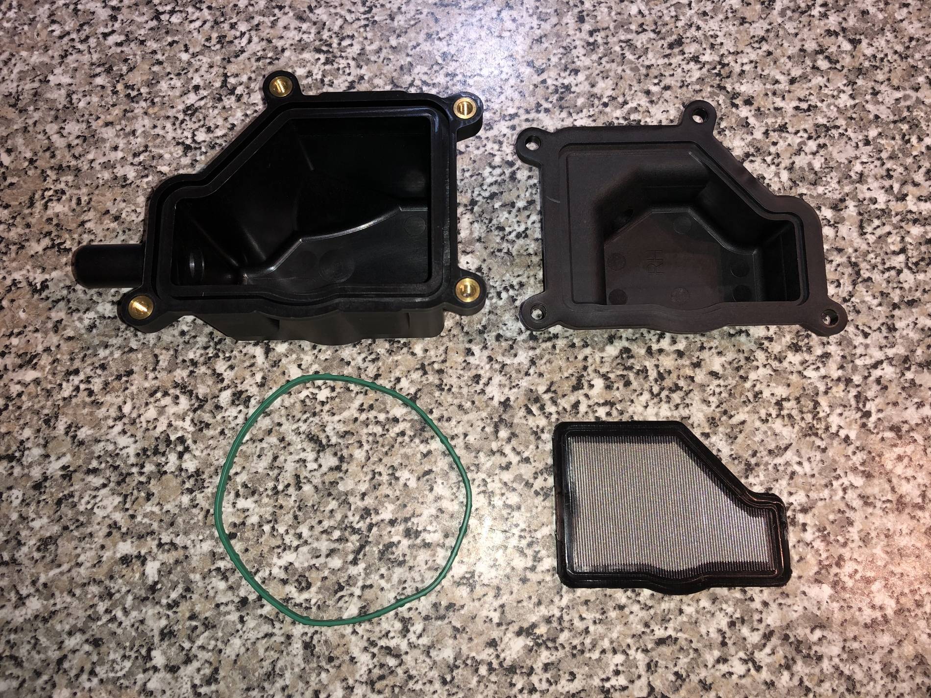

Why not drill a hole in the top? Could easily tap it and use a bolt to plug it up. Then just use a syringe to slurp up the oil via the hole. There really isn't anything special about these, they are just a simple trap, right?

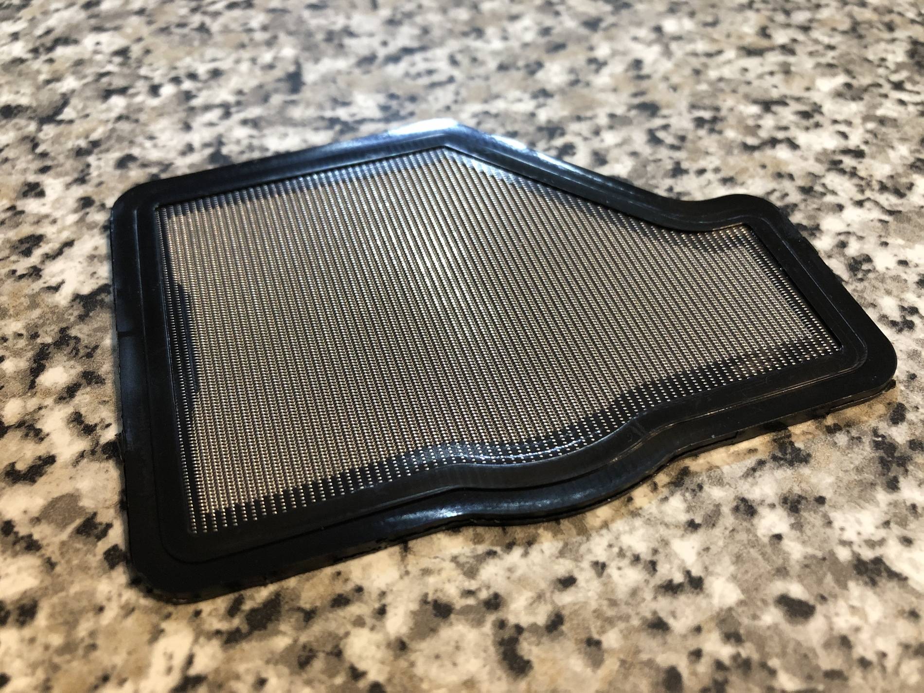

I wouldn't recommend drilling into the top. If you take it apart and look inside you'll see why.
Oil vapors come into the left port off the valve cover, condense on a very fine metal screen, collect there and drip into the collector below. Mostly air is then passed back to the intake on the other side of the screen free of oil vapors. You could drill and tap some sort of valve on the bottom but it might be hard to get at.
