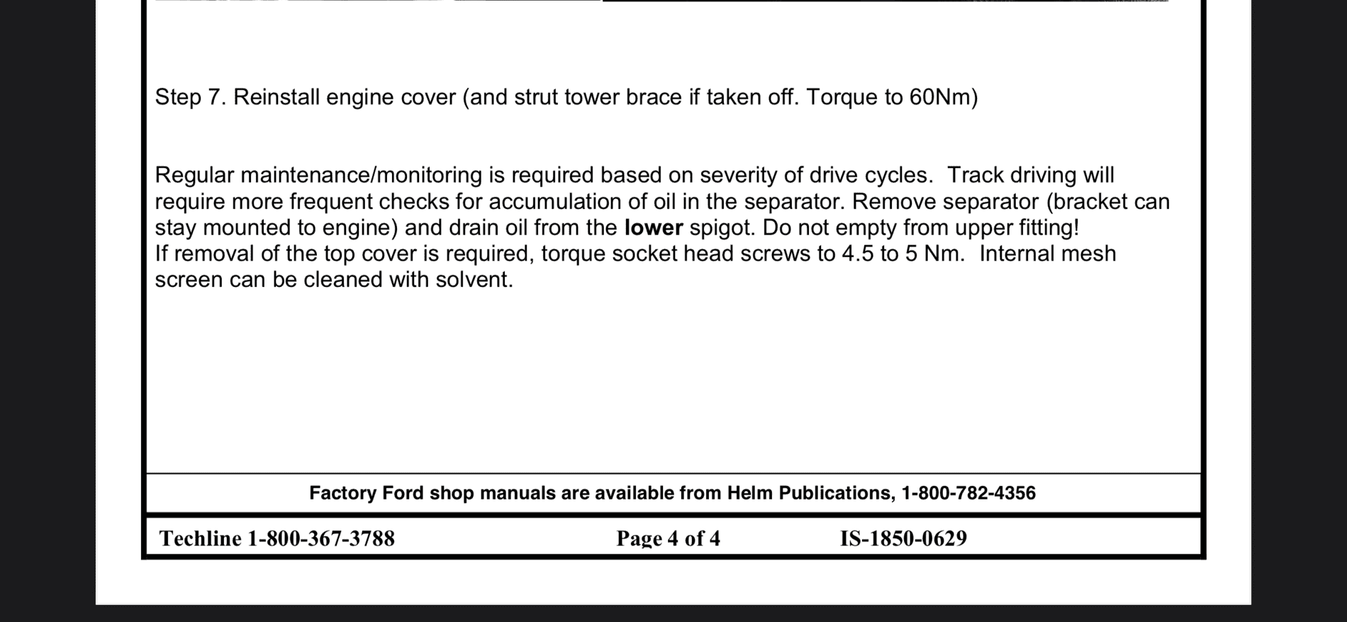

I think you need to balance these kind of questions to car usage though - easy driving v track time etc ...
As a guide mine is road usage, but I like to play and it isn't used for commuting or motorways much, I also like to let it rev.
If mpg can be used as a metric to judge usage, I'm averaging mid 12’s to mid 14’s (and that's a 'large' UK gallon for anyone stateside reading this), I don't doubt that if I was mostly cruising at low revs and highway miles the can would catch a lot less oil :like:
WD :like:
It's actually the other way around. High manifold vacuum conditions are when you'll collect the most oil through the catch can, and this will occur mostly under part throttle driving. So driving around normally on the street or on cruise is when these are needed the most.

OK, I’m going to challenge this - not because I’m being an arse, more for the discussion and my own learning :like:
I accept that the vacuum may be higher under part throttle, but is that not (much) more offset by the increased oil vapour from high crank revs beating the crap out of the oil in the sump and the increased blow by from high rpm and maximum power ?
If not, how come improved breather systems are almost standard on a race cars and they are not more popular on town cars / motorway cruisers ?
I understand about oil surge in race cars and increased blow by on forced induction etc - but for this discussion I’m more interested in the volume of oil vapour / % of oil to air going through the breather when cruising compared to hooning :like:
WD :like:

It's a good question. So this is where the PCV system is misunderstood, and why I'll probably do a video on it soon. The problem is to fully understand it, you sort of do have to go into it depth. Not that it's overly complicated though.
I will begin with this statement. Oil collected in passenger side separator is related to engine vacuum, not crankcase pressure.
Firstly, the PCV system is there because of emissions. Yes, a vacuum is great at pulling vapors, and having a 'free' scavenge system from the intake manifold vacuum is actually helpful. But without emissions, I think the design would be different. More on that later.
So the vacuum that is created by the intake is actually really strong. Imagine attaching a vacuum cleaner to the valve cover. That is exactly what is happening when the intake is under vacuum. This is why there is a PCV valve, and it's not just an open fitting. The PCV valve has a spring-loaded plunger in it, and it rest shut in two conditions. Firstly, when there is no vacuum ie WOT, it will rest shut. Secondly, when the vacuum is very high, the plunger will also shut. This is to manage the amount of air being sucked into the manifold at very high vacuum.
Now, at WOT, when the PCV valve is shut, there is no vacuum being applied to the valve cover. So any excess crankcase pressure will expel itself under atmospheric pressure. Nothing will suck it out, as is with the case under manifold vacuum. Also, because the PCV valve is shut, any excess vapors will be expelled primarily on the drivers side. As there is no vacuum, this becomes a vent, venting to the intake tube, but only under atmospheric pressure. It is not being sucked out. This is why you will get some oil on the intake tube over time, but usually not much. This is why there are driver's side catch cans, and in most conditions they don't collect anything. Now, if you had an excessive blowby issue, or a modified motor that had loose ring gaps, yes, you will get a lot more vapors coming out under WOT conditions, even to the point where they will push the pcv valve open to vent through there if it was needed.
This brings us on to race motors/built motors/big power forced motors. These will produce more crankcase pressure, due to how they are built, the power they are making, the rev range they are sitting at etc. Now the big thing is they don't have to comply with emissions, so using intake manifold vacuum isn't needed as they don't need to recirculate the vapors. So what you will see is two things. Either vented to atmosphere setups, or vacuum pump setups. Nothing beats a vacuum in terms of the amount of vapor you can pull over a set time, and that is why these pumps are used on big power/dollar setups.
So going back to your questions about vacuum being offset by increased vapors under WOT. Under WOT, on a normal or mild modded street motor, you will get some crank case pressure, but this will have to be expelled under atmospheric pressure. Again, this is why a lot of drivers side cans on mustangs appear to not collect anything. If you have normal crankcase operations and not excessive ring blowby, you will hardly see any oil vented without a vacuum. It will never compete with what the PCV system is doing, and this is pulling vapors under a strong vacuum regardless of what is happening inside the motor. Essentially, the reason you are seeing lots of oil in the passenger side on an OEM pcv system is not because of blowby or crankcase pressure, but because of vacuum. And because of this, the amount of oil on the passenger side will be related to each persons driving conditions, and the amount of time they stay in the intake manifold's vacuum range.

So going back to my question i.e. oil collected under high rev / high load conditions compared to that for cruising - is Ford incorrect to quote this wording in the instructions ?
Surely if cruising collected more oil than hooning, would the instructions not be worded in a way to reflect that ?

Yeah look I don't know why they put that there or the reasoning behind it. Maybe it's just a warning to make sure people are checking it.
But actually just thinking about it, under WOT at high RPM you will have a large amount of oil in the heads. When you come off WOT, you will get a strong vacuum, and coupled with the extra oil in the heads, you might be got a lot of oil sucked into the separator that otherwise would not happen if you weren't at a high RPM. So yeah under high RPM driving you might get more oil in the separator, but this would be due to the extra oil and high vacuum, not the excess crankcase pressure. That is just me thinking out loud.
