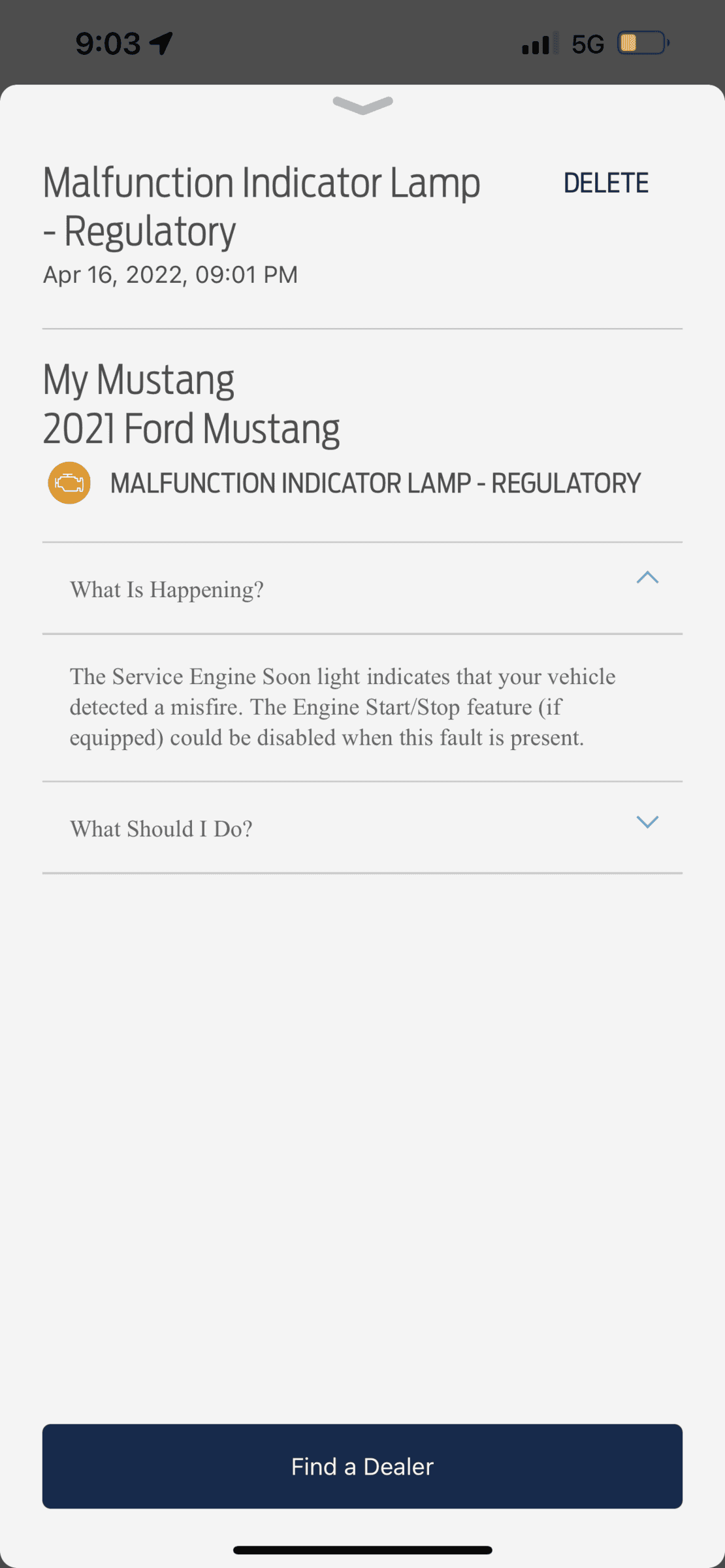

Received this message on my fordpass app, about 3 hours after the cel flashed. Car drove fine tonight. It will be looked at Monday morning I'll update this thread. Hoping it's nothing serious
