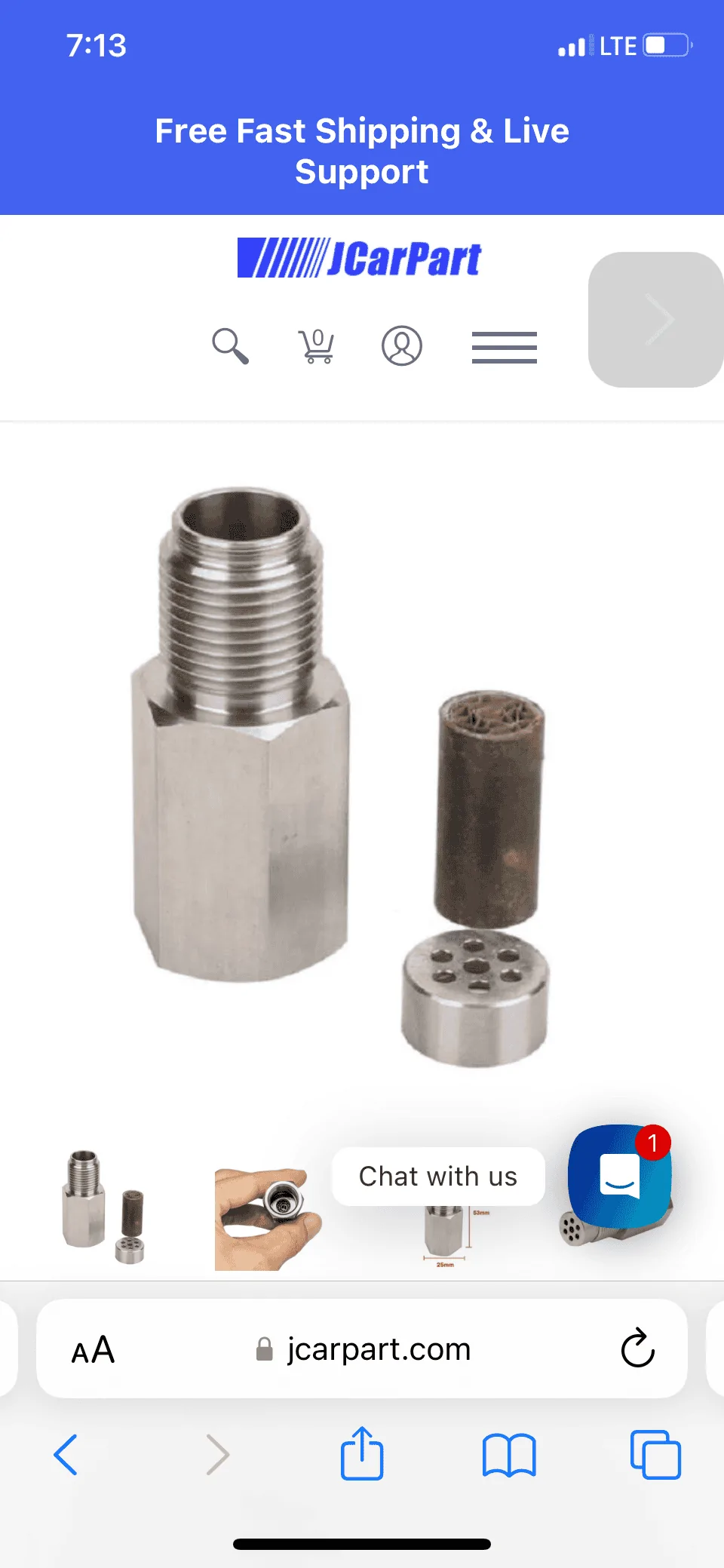

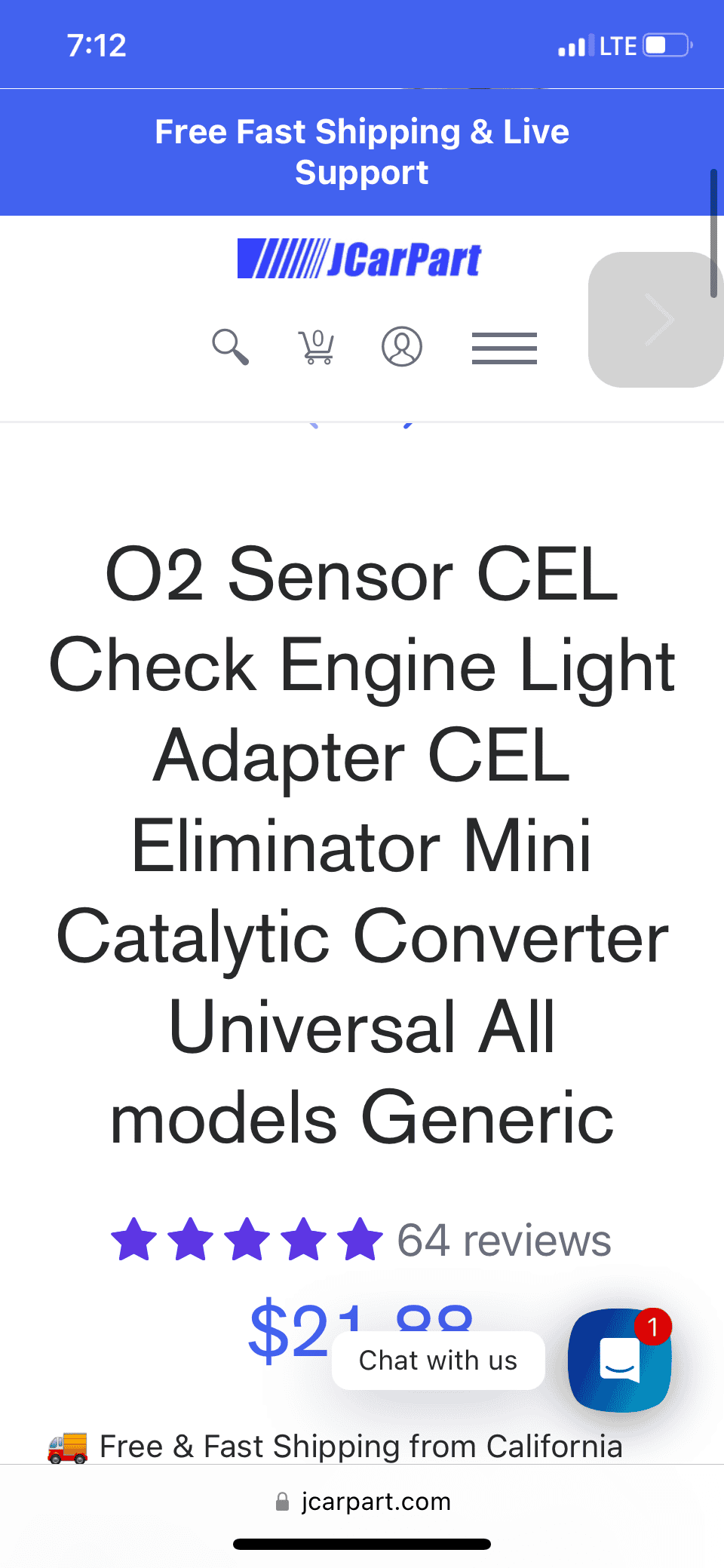

all fixed after getting these. i appreciate everyones help and sorry for late reply. just bought a house this month and its been a trip.
hope this helps others pass their inspections
To note...using these nonfoulers/extenders are ONLY good if your inspection does NOT include a visual inspection. These will not pass a visual inspection if they are seen (at least not in many places).

I'm using stainless steel ones with mini cats built in with my Kook's green cats. Haven't thrown a CEL since my first one after the header install the next day. They work.
