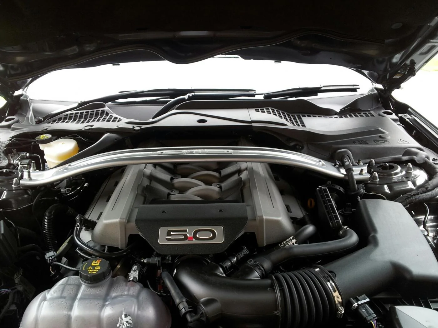

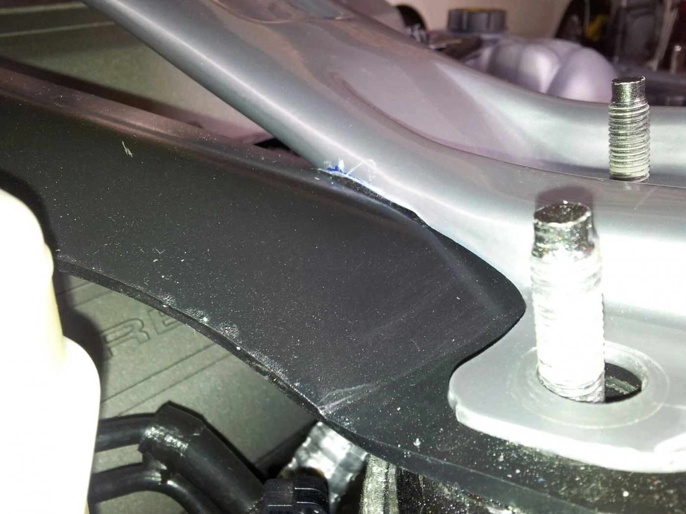

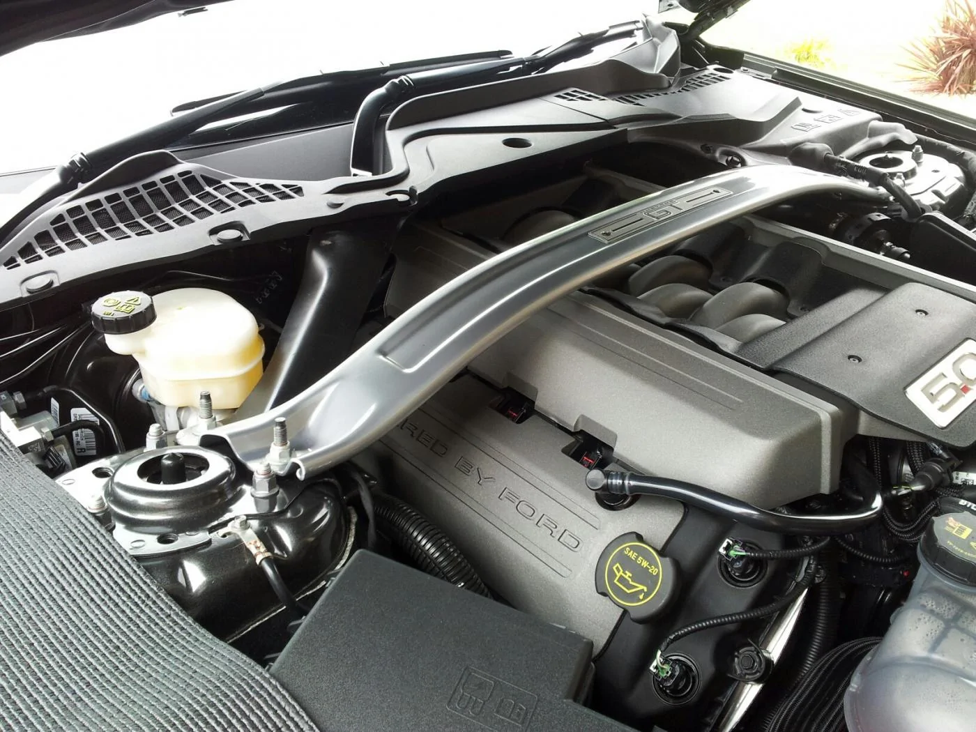

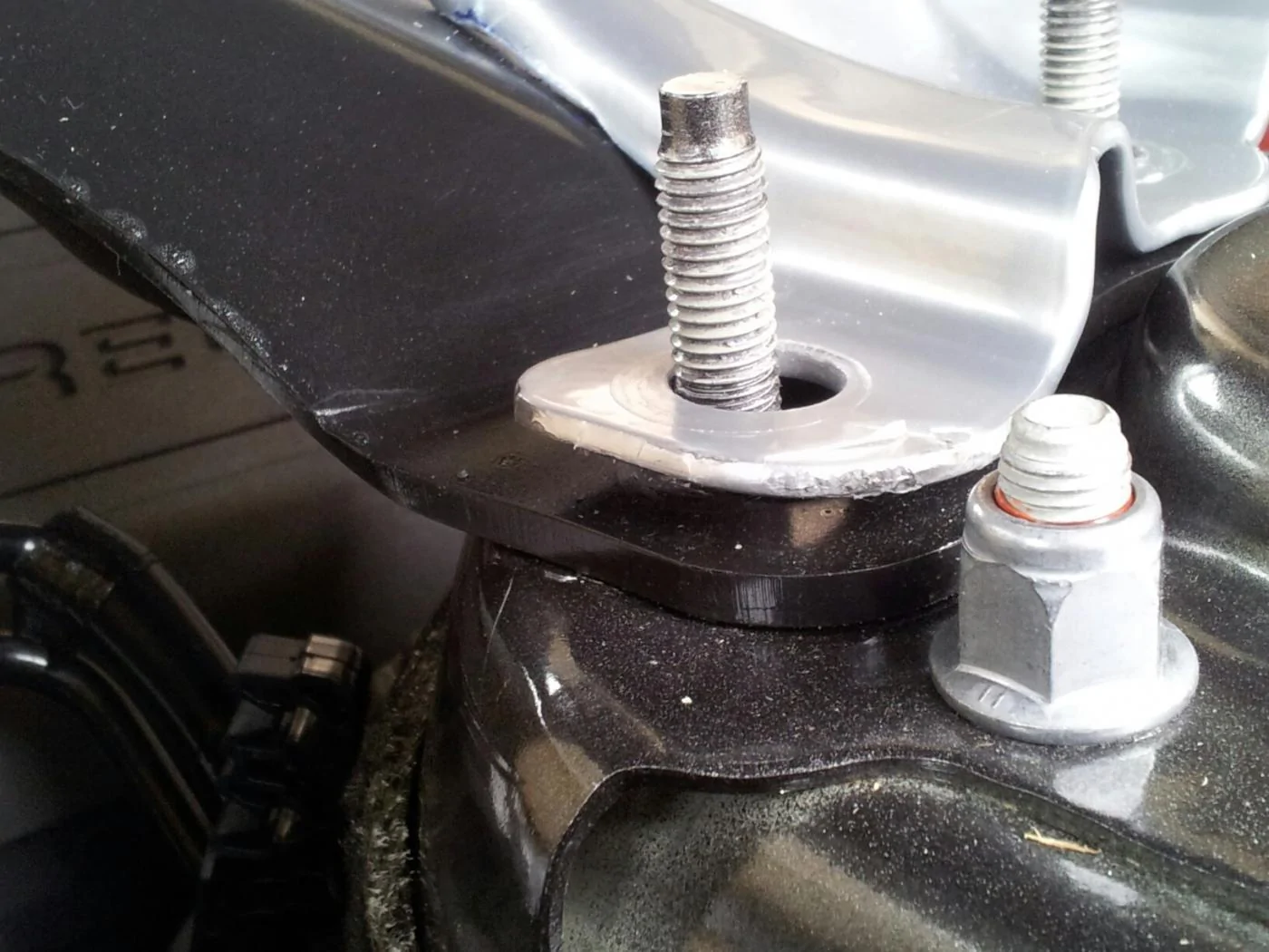

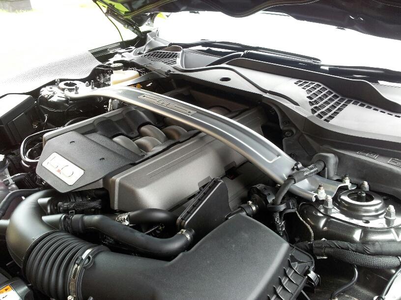

Ok - success at last. after some grinding of the drivers side of the brace - it now fits.
see following pictures:

Nice work Aussie Mate...doesn't look like it needed much......was there enough free play in the battery cable to slip the brace under or did you have to undo the cable to fit it?

No there sufficient play in the cable loom for it to fit under. There is a loom fitment point in the way but that is simple to undo and sits ok on top.
The longest part was the grinding as there was a fair amount to remove.

Ian - I dont think that it weakened the brace at all, while about 2-3mm was taken off, along a 7-8 cm length.
The result: - I took it for a test drive afterwards - and to me it felt much tighter and more responsive in the front - almost too much.
Anyway it looks great and I'm happy with it.

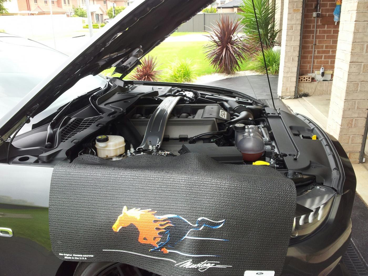

Glued on?? - not on my car.
The wiring loom just had a securing clip that was pushed into a hole on the body. I pull the clip out and there was more than enough room to put the brace under the loom.
you can see this in the last pictures that I posted.
