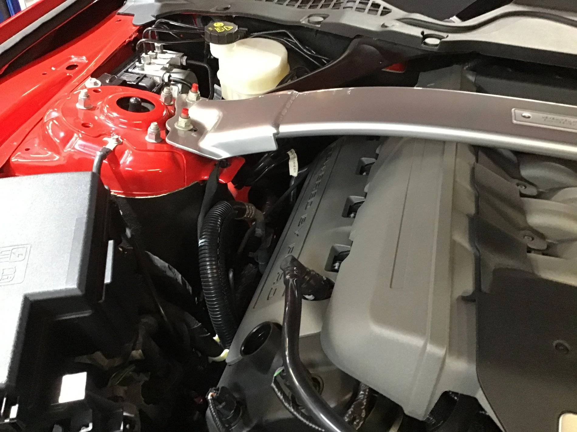

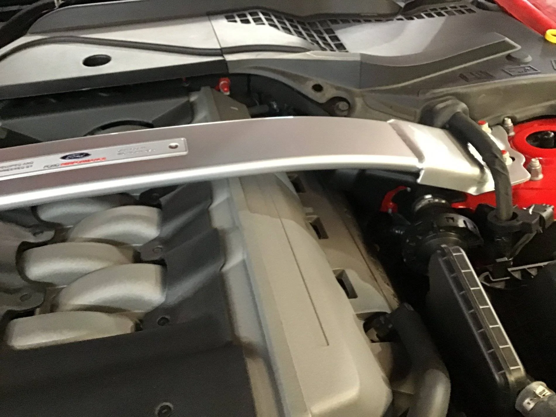

Yes all Australian Mustangs have the K brace. I fitted the stock Mustang GT Tower brace, I purchased from PJ Pony Parts when the A$ was stronger for less than half of the local asking price. I fitted it in 10 minutes, with some perfectly sized washers to lift it maybe 5 - 10mm for clearance purposes. Easy as and looks great, I also thought it tightened up the front end a smidgen more.

Thanks Phil. Yes I was looking at the Mishimoto tower brace but it appears that it conflicts with the k-brace on Australian cars. I very much prefer the look of the slimmer rounded brace similar to those on the early Mustangs but I don't think it is worth it to take the k-brace off.

No, do not take off the K brace, 1. I think it would be a big job and, 2. I think it adds much needed front end tightness
