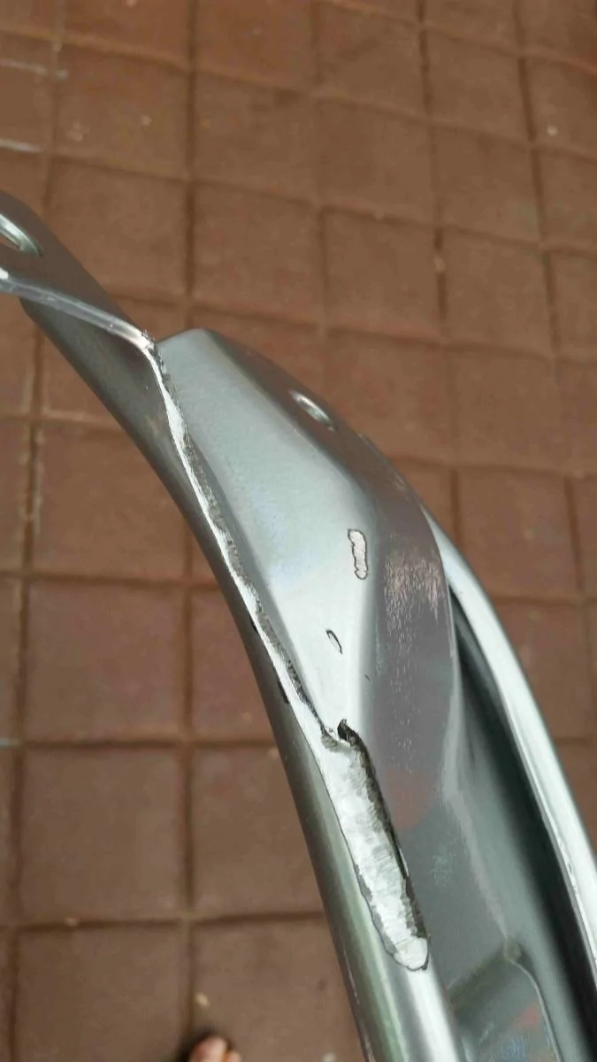

Used the bolts there. I did a bit of grinding and painted the exposed bit, no drama
