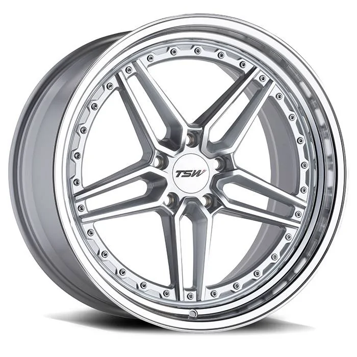

I’ve finally found the wheel that I want. It’s available in couple of offsets and I need help picking out a offset that won’t be a problem for my current suspension set up.
Suspension Set Up: Steeda ProAction shocks and struts with Eibach Sportline springs.
According to Eibach I’m looking at 1.5 in drop up front and 1.3 in the rear.
Wheels
Front 20x9 +20 on a 285/30
Rear 20x10.5 +40 on a 305/30
can someone give me some kind of idea of what kind of fitment I’m looking at here.

TSW Ascari. Their website recommended those sizes for the car. The 20x9 wheel can be had in different offsets, the 20x10.5 only comes in +40 offset apparently.

That is a nice-looking wheel. That lip is what causes them to have to offer those low offsets and widths.
