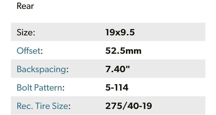

Will these fit on the front of my 18 Gt ?

Those would be very very close to the front struts on the inside of the wheel. You might need to run a small 5mm spacer to get clearance.

So it’s the offset that is making it close?

Offset and wheel width, or backspace if you prefer.
