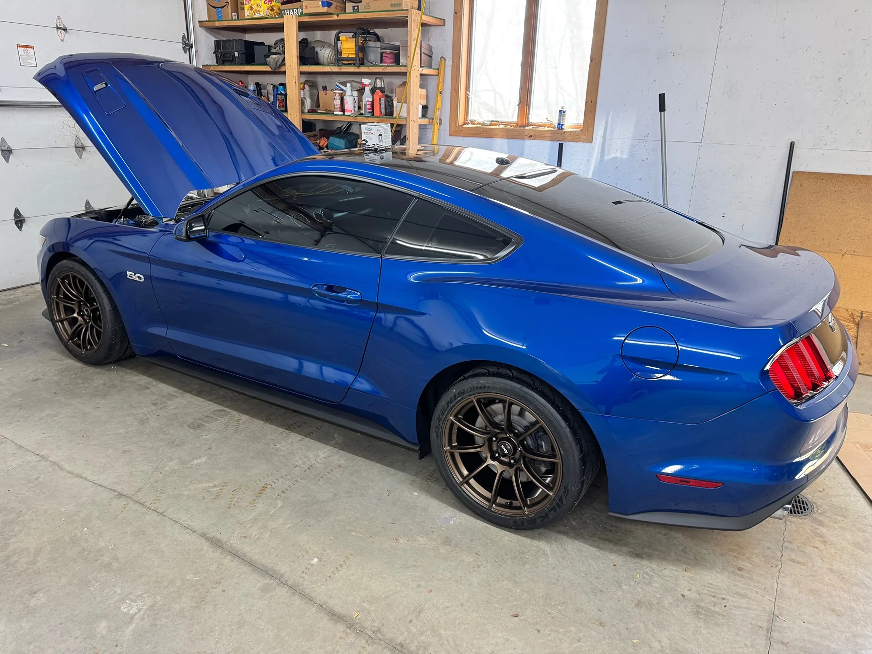

That’s crazy that you are able to get a 315 up front. I assume your ride height isn’t too low?
I am using BMR SP083 handling springs which are advertised as less drop. Supposedly .875” front and .75” rear, I never measured.
im also running 18” wheels, so the overall tire diameter may be slightly less, although again I didn’t measure.
I do run quite a bit of camber up front so the tires don’t end up hitting the fenders under compression but that’s desirable for handling/autocross anyways.
Appearance wise the car doesn’t sit low.
That rear tire looks tiny

You posted a tiny ass tire in a wheel/tire fitment thread. Looks bad/weird. Not the look people want. Lots of fender gap.
See it now?

I picked up a set of used 18x10.5 HRE wheels with Nitto NT01 305/35/18 from a 2013 GT500. The issue is I can fit the 18” HRE’s on the rear just fine, however the front is a whole other issue. I have to run a 1” spacer to fit them and not hit the coilovers. Unfortunately, that then makes the wheel poke on the front beyond the fender about an inch.
My help and pics are obviously relevant.
I’m building a car for Autocross and possibly track use. Aesthetics take a back seat to function, clearly not everyone understands that… 18" is a very common size for track use.
The car looks great on these wheels, you’re the only person to try and say otherwise, it’s not being assembled for your opinion anyways.
His question was about tire clearance which I answered in a picture with a tire size and then he asked if the car sits low, so I proceeded to provide another picture. Try to follow along.
I’m aware that the car doesn’t sit that low… fender gap takes a back seat to the right tire fitting and not rubbing the strut, hitting parts of the car, rubbing on brake lines, etc. Fitment goals are going to move around depending on use. Wheel size can also be dictated by what is available for tires.
