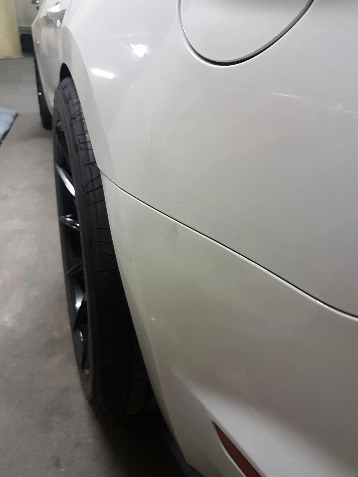

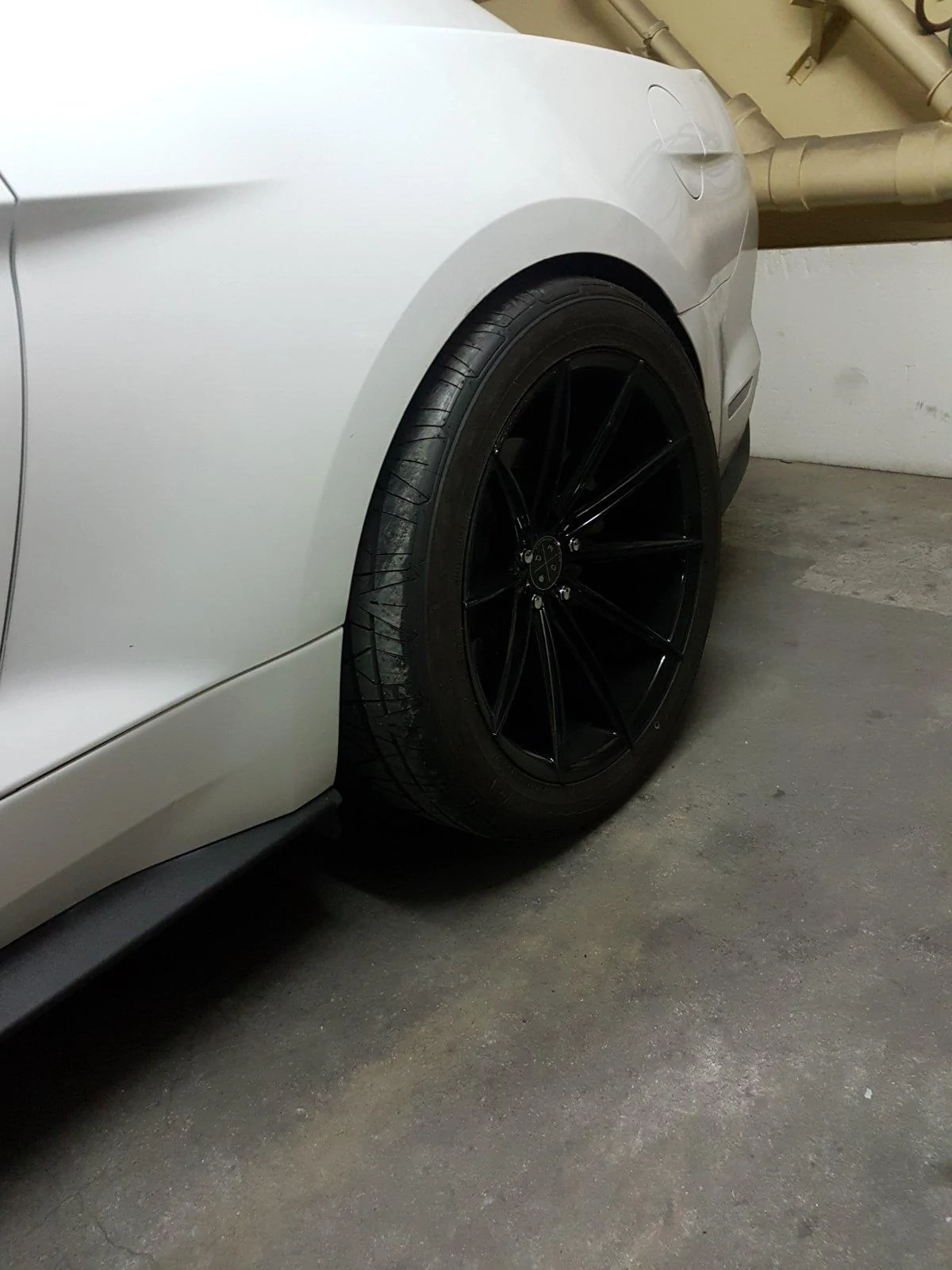

Hello experts
Need help with my wheels....
I have a setup of 20x10 front +35 and 20x11 in the rear +33. The rear wheels are poking out so how can i flush it? I have uploaded some pics.

Not much you can do. Its easy to push wheels out more with spacers, but not much you can do to bring the wheels in. You can't really modify the wheels safely without removing material that might be structurally important.
You can add some negative camber in the rear which will pull the tops of the wheels in a bit, but it will only help a little and you'd be sacrificing straight line grip for acceleration and (to a degree) braking. Its worth doing, but it won't help a ton, maybe 1 cm.
Beyond that, it looks like going to a narrower tire would help slightly, but again, you'd be sacrificing grip to get a specific look.
You could look at getting some fender flares and cutting up your sheet metal.
But what I would do is just sell those wheels to someone with a car that they would fit on, and take the money to buy a set of wheels with correct offsets for the S550. You might not loose much in the trade depending on how valuable those wheels are.

I am running 315 35r20 in the rear so if i get down to 305 30r20 or 295 35r20 will it help me
