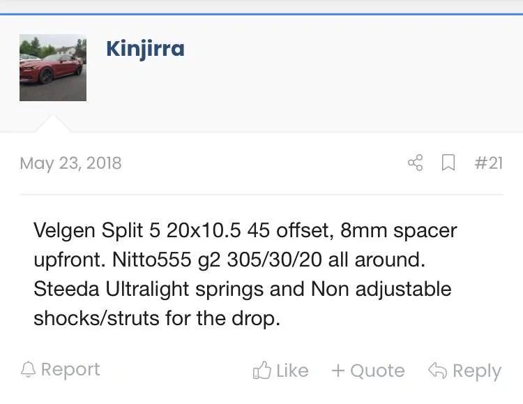

Someone told me a 5 mm spacer with a 275/35 in front. If I use a 15 mm spacer would it look funny, not even with the back? I guess what I’m asking is will the front stick out further than the back?
This was from another post, granted its an S550

8 /= 5. A 8mm will be shaving it very very closely on the inside. You are also sitting at or just below the threshold for safe thread engagement with a 8mm spacer and stock studs, which is why I don’t recommed it. Spacers wider than 5mm really need extended studs. No sense if cutting your safety margin there and loosing a wheel. I’ve seen that happen to a friend’s car. It made the worse noise as his subframe and rotor scraped across the pavement and luckily he didn’t slide into anything

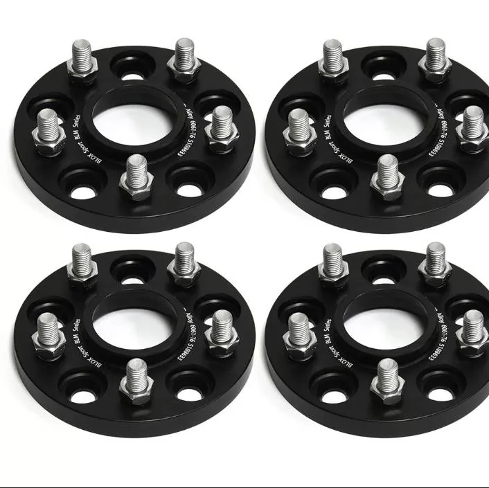

I don don't know of any bolt on spacers in the 10-15 range that will normally work. The wheels need a recess for the stock studs, and the narrower the spacer, the larger the recess required.
You'll have to consult someone else who actually uses bolt on spacers, I don't use those, but IIRC you'll have to step up to at least an (edit) 23mm spacer (or something like that), and that's entering poke territory if you're running stock camber. With a 20mm bolt on spacer you have to trim the stock lugs or something.
The wheel is just an awkward offset for a front wheel on these cars. If you invest in replacing the studs with 0.5-1" longer replacement studs, you can run a slip on spacer which would be ideal. Most people won't make the effort to do that.

I’ve used spacers before and on the new wheel there is sufficient opening for stock studs. If it don’t work I’ll have 2 rims for sale lol
