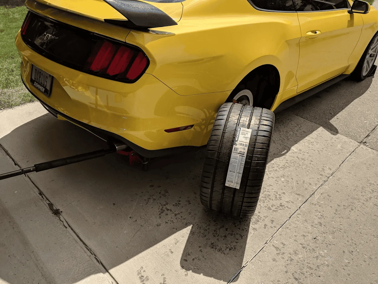

I got 285's front and 325's rear.
Forgestar F14 Wheel Gunmetal in 19x9.5 +30 mm offset for 2015 Mustang
Forgestar F14 Wheel Gunmetal in 19x11 + 53 mm offset for 2015 Ford Mustang

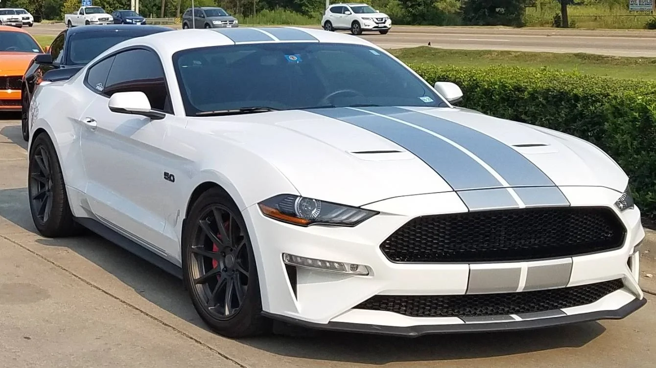

This is 19x9.5 +33 with 275/40. It's flush in the rear but a slight tuck in front.
