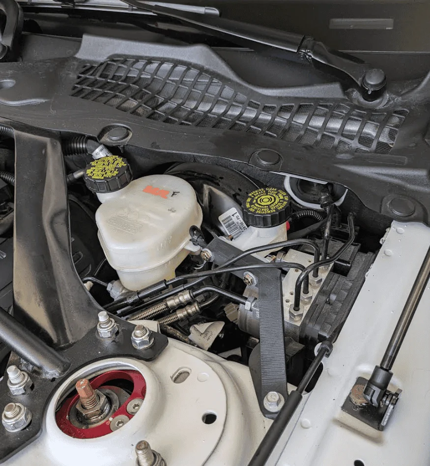

I just divorced mine, and TMO has a 3D print file you can use to make a nicer looking bracket.

Any chance you could link this please?
https://trackmustangsonline.com/threads/3d-printed-s550-brake-fluid-divorce-bracket.19543/
Here it is on my car:
OP, I wouldn't stress about divorcing them before your event. If you do, you need to find a plug for the clutch line hole on the brake reservoir that A) is secure, B) can hold up to the temps of the engine bay, and C) not get broke down by the brake fluid.
I found an auto reservoir on the interwebs and swapped it. Then grabbed a GM clutch reservoir.

Oh I'm definitely not saying don't ever do it. But since OP is trying to be ready in less than a day, I would spend my time checking/changing all fluids (Diff, oil, trans, coolant), tires, alignment, checking any bolts I've touched under the car, getting the seat in the right spot, camera/data tracking set, cleaning windows, tire pressures, those sorts of things.
What I would be really curious about is how much mixing of fluids the clutch actually gets. Maybe it's a lot. Maybe it's nothing. But yeah, definitely a good idea to make the change in the long run. And it's cheap.
