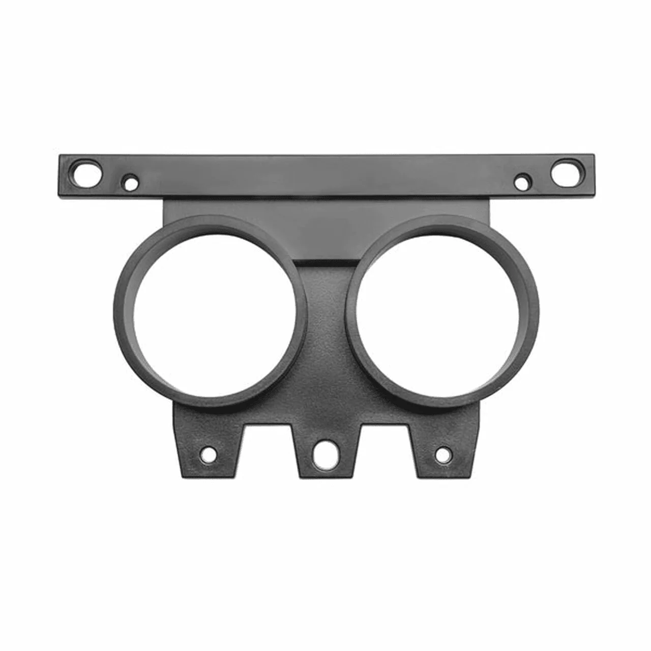

Probably already in the previous 25+ page list. I wish they would have dumped the vacuum gauge and given us a proper oil temp gauge. Anyone know if the GT500 center gauge cluster would work as direct plug and play? I know someone has put the GT350 one in, but lighting does not match the later model cars.
https://www.google.com/url?sa=i&url=https://www.glowshiftdirect.com/dual-gauge-dashboard-bracket-pod-for-2015-2021-ford-mustang-gt-performance-package/&psig=AOvVaw3cOWv1lMwwS0vtkb7tfhrt&ust=1643208251228000&source=images&cd=vfe&ved=0CAgQjRxqFwoTCPjd_PORzfUCFQAAAAAdAAAAABAD
You can add this from glowshift and add your own gauges. When my Mach arrives, I will be adding mechanical gauges, to replace the factory ones.

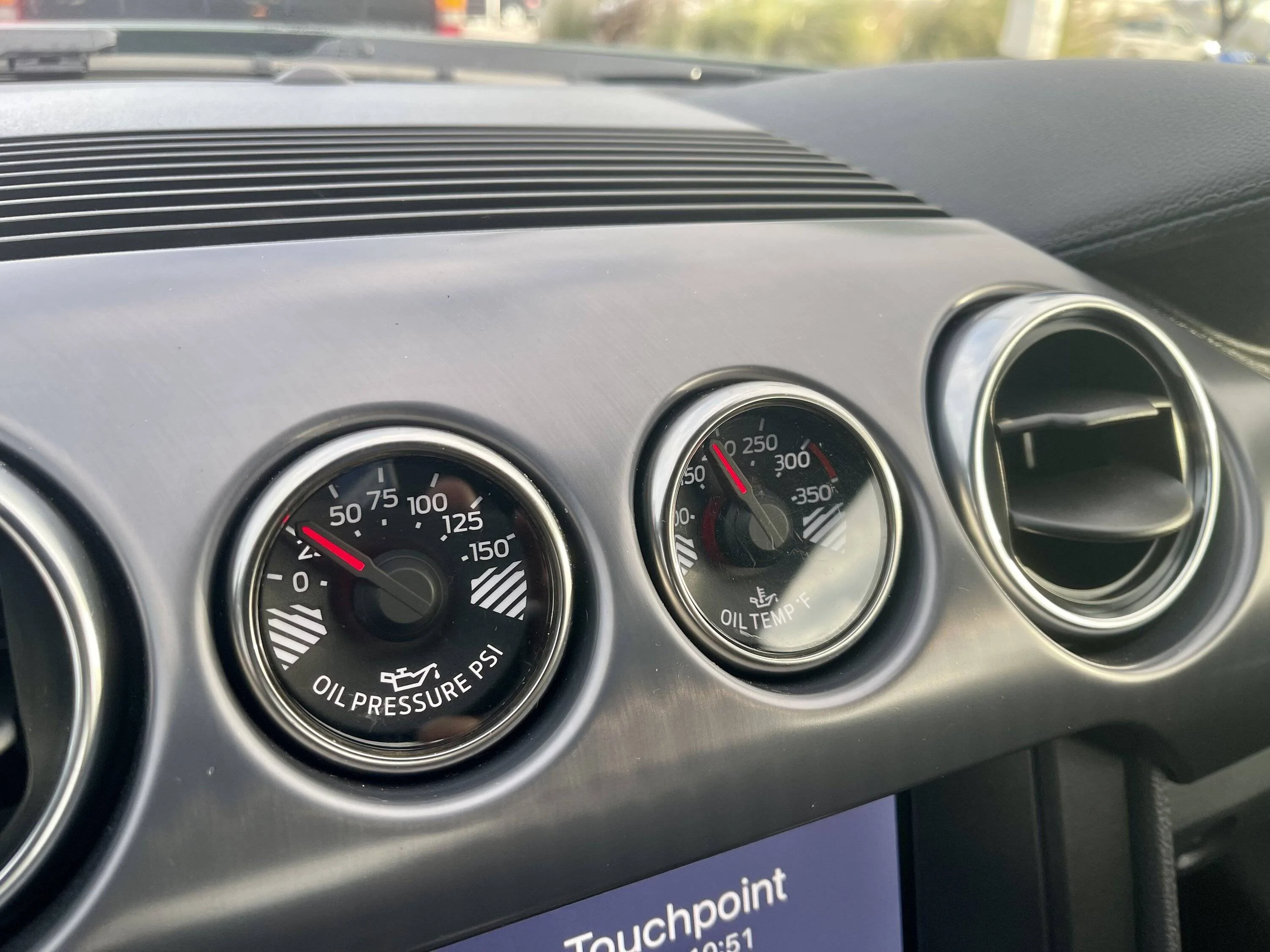

I installed them yesterday, as stated the my-color option does not work so they are just white with red needles all the time, but other than that they are plug and play. The oil-pressure goes to 150psi but the reading seems to be correct. I believe this is just a simulated # from the ECU and not actual pressure but I’m not totally sure. Mine was used from a wrecked GT500 so the chrome bezel is slightly darker but it’s hardly noticeable, you can swap the face (bezel and lenses) pretty easily if you want. Overall a very easy swap and I can now see when the oil-temp hits 200*, that’s right inline with the cylinder head temp without having to pull up that gauge on the cluster.

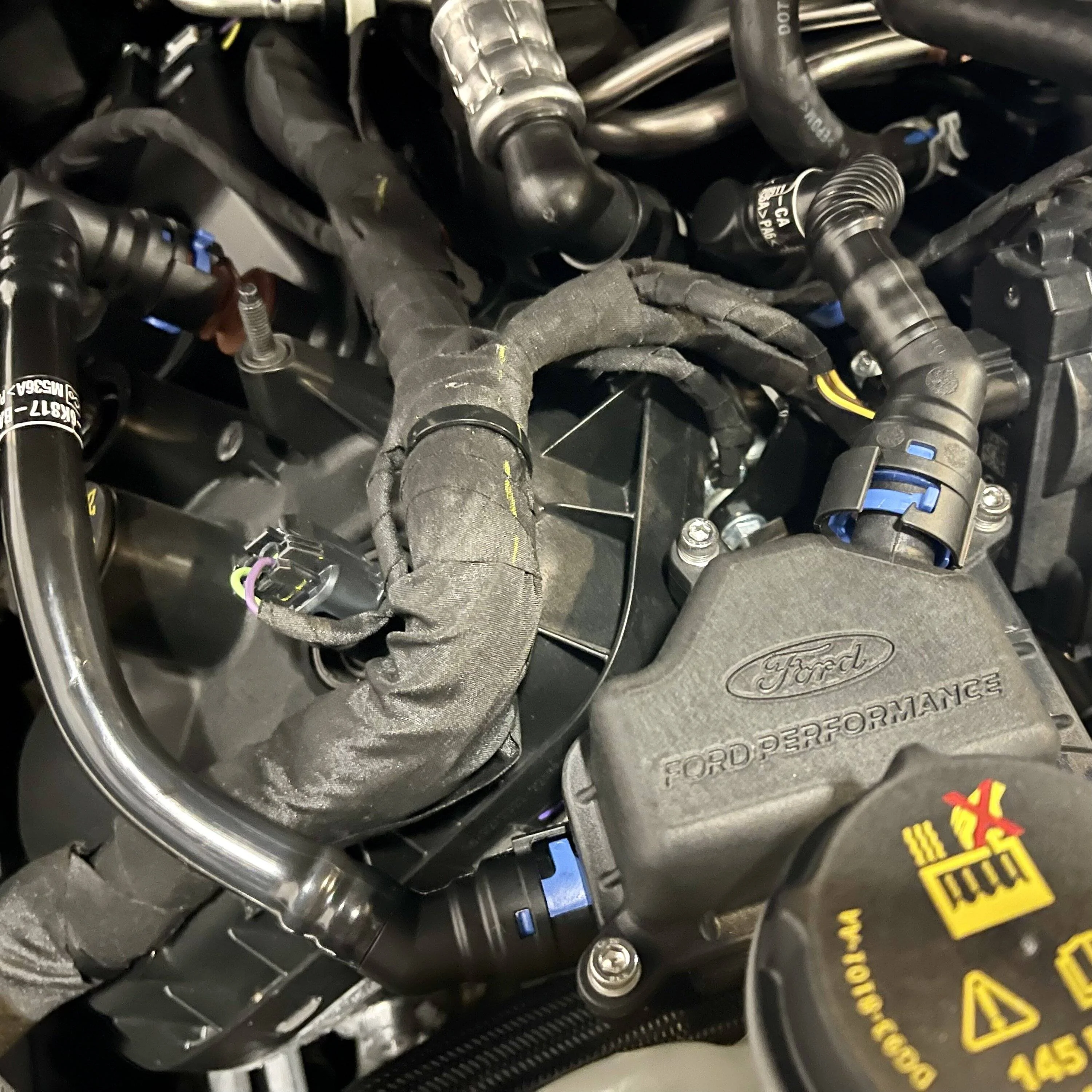

I also install the passenger side Ford Performance oil catch-can and removed the ‘22 carbon trap on the intake. Both easy jobs although I want check the intake-manifold side after some heat cycles cause the hose fits a little weird.
1776 miles when I did the work and the hose from the breather was bone dry, also have not burned any oil as the level is at the same spot on the dip stick as the morningI picked up the car
The GT500 bezel is just slightly darker than the stock/air vents.
I believe there is no oil temp sensor per se in Mustang, so the gauge is probably showing some simulated value as well, probably derived from cylinder head temp.
