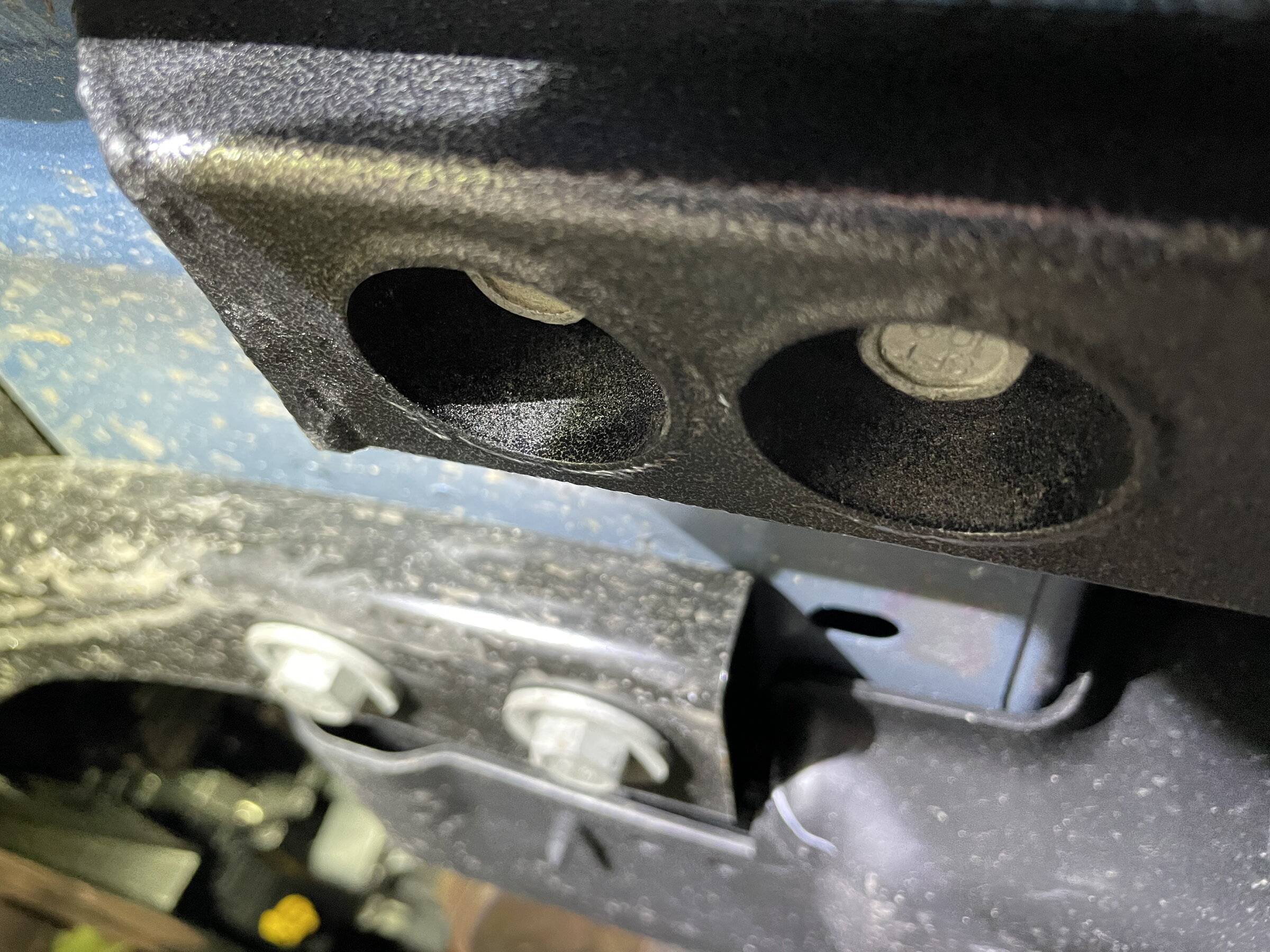

Got the BMR jack rails installed today. Purchased them before I got the car.
Gave me something to do. With the COVID closures not much to do. Plus I am awaiting a bunch of parts. So I have the time to install them now but the supply chain issues make it a waiting game. I bet I will receive my parts when everything opens again :(

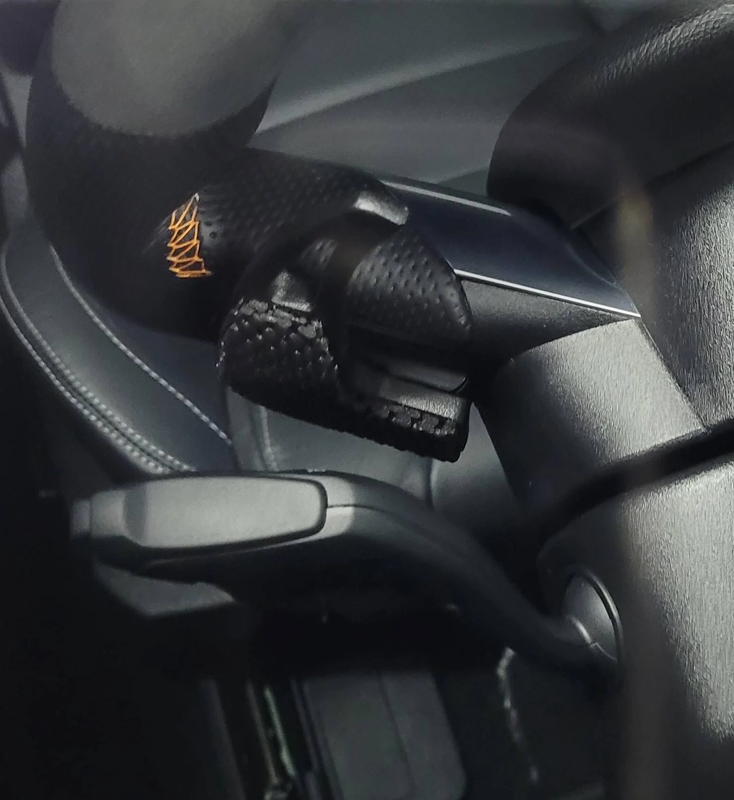

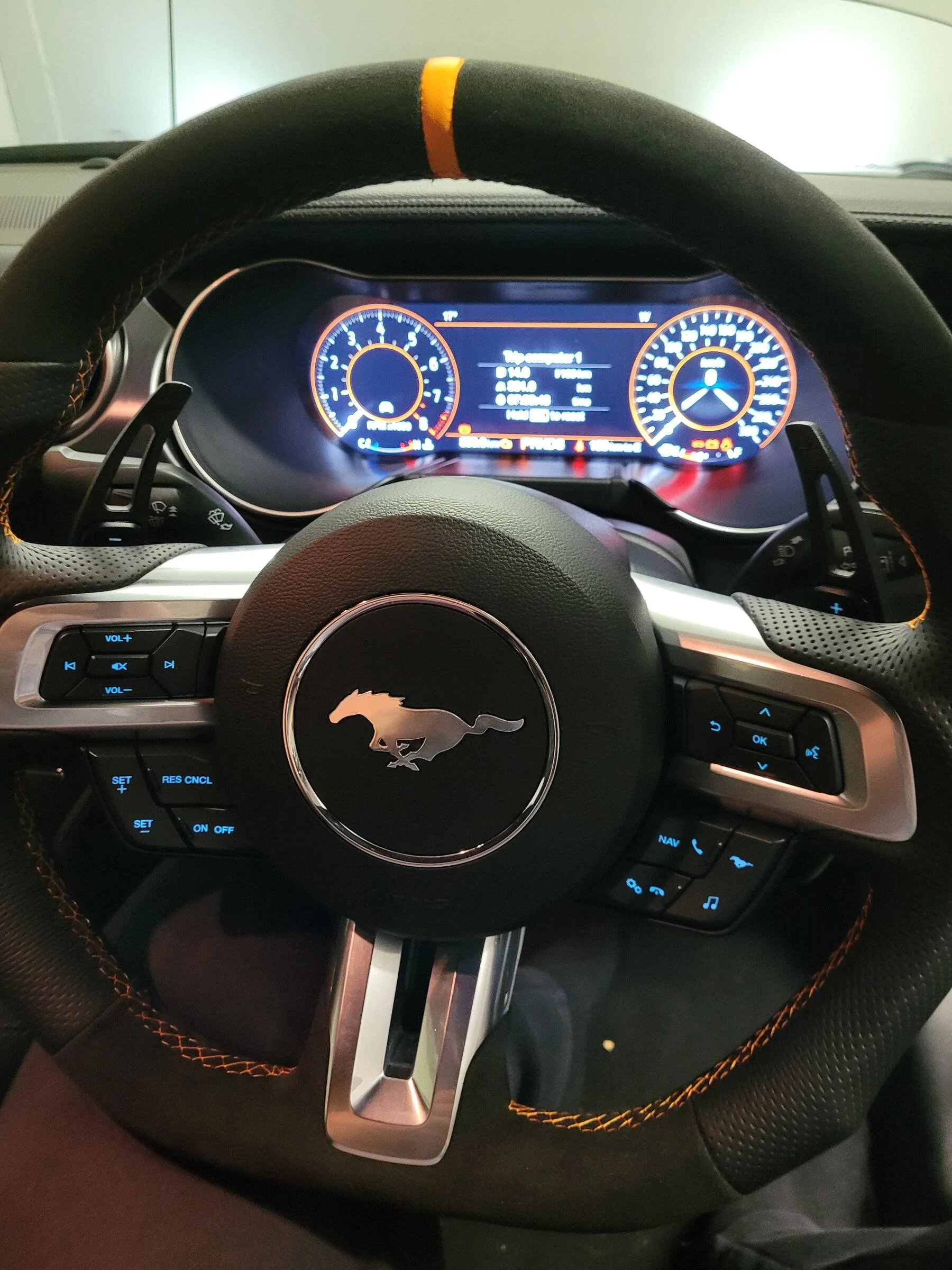

Paddle shifter extensions and an upgraded steering wheel, both make a tidy improvement to the driving experience.
Nice! What wheel is that and where are the paddles from?

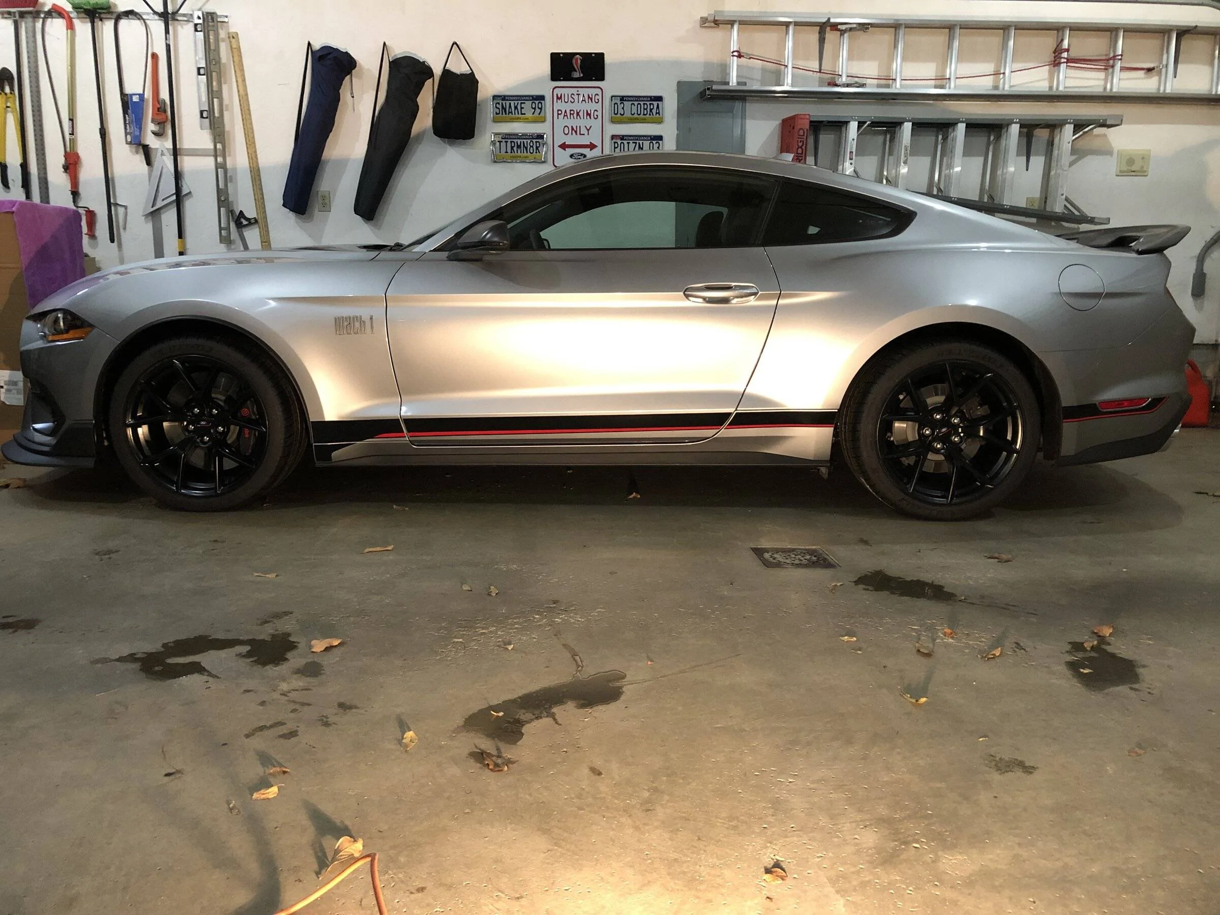

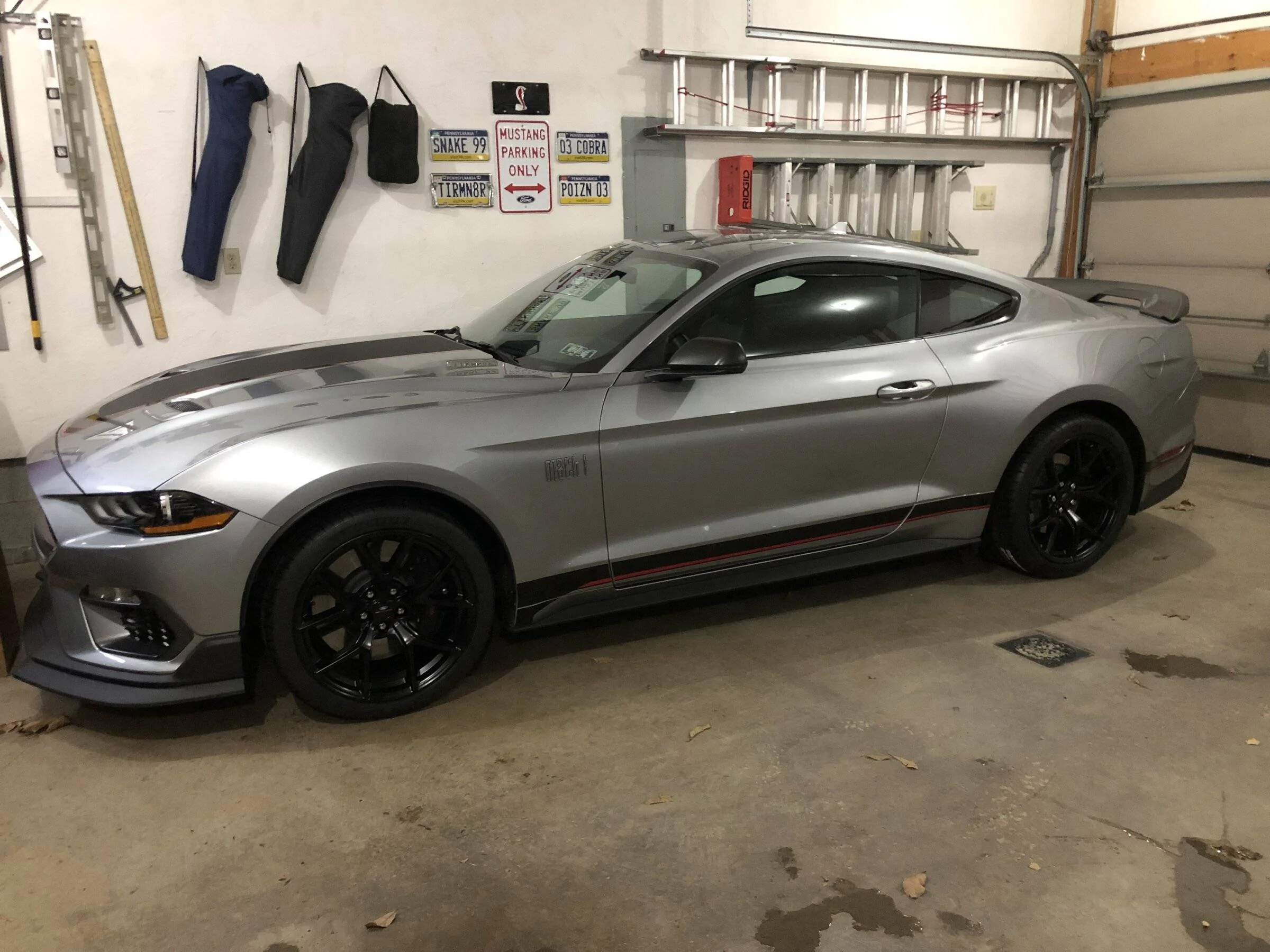

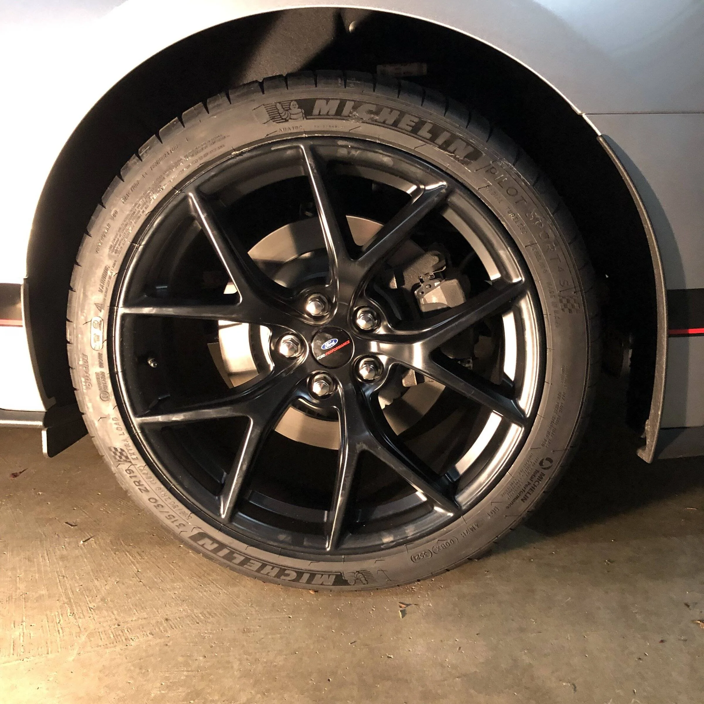

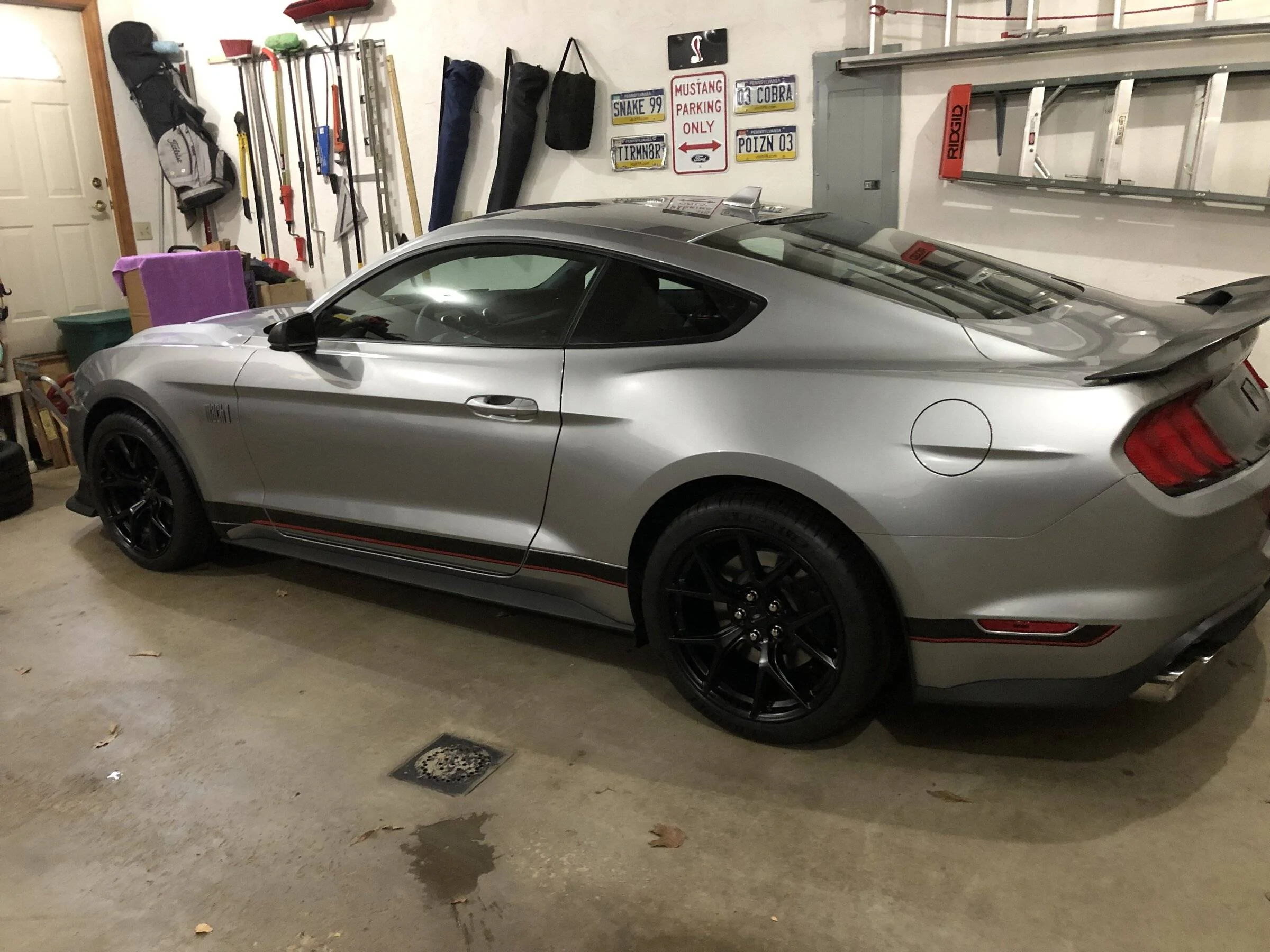

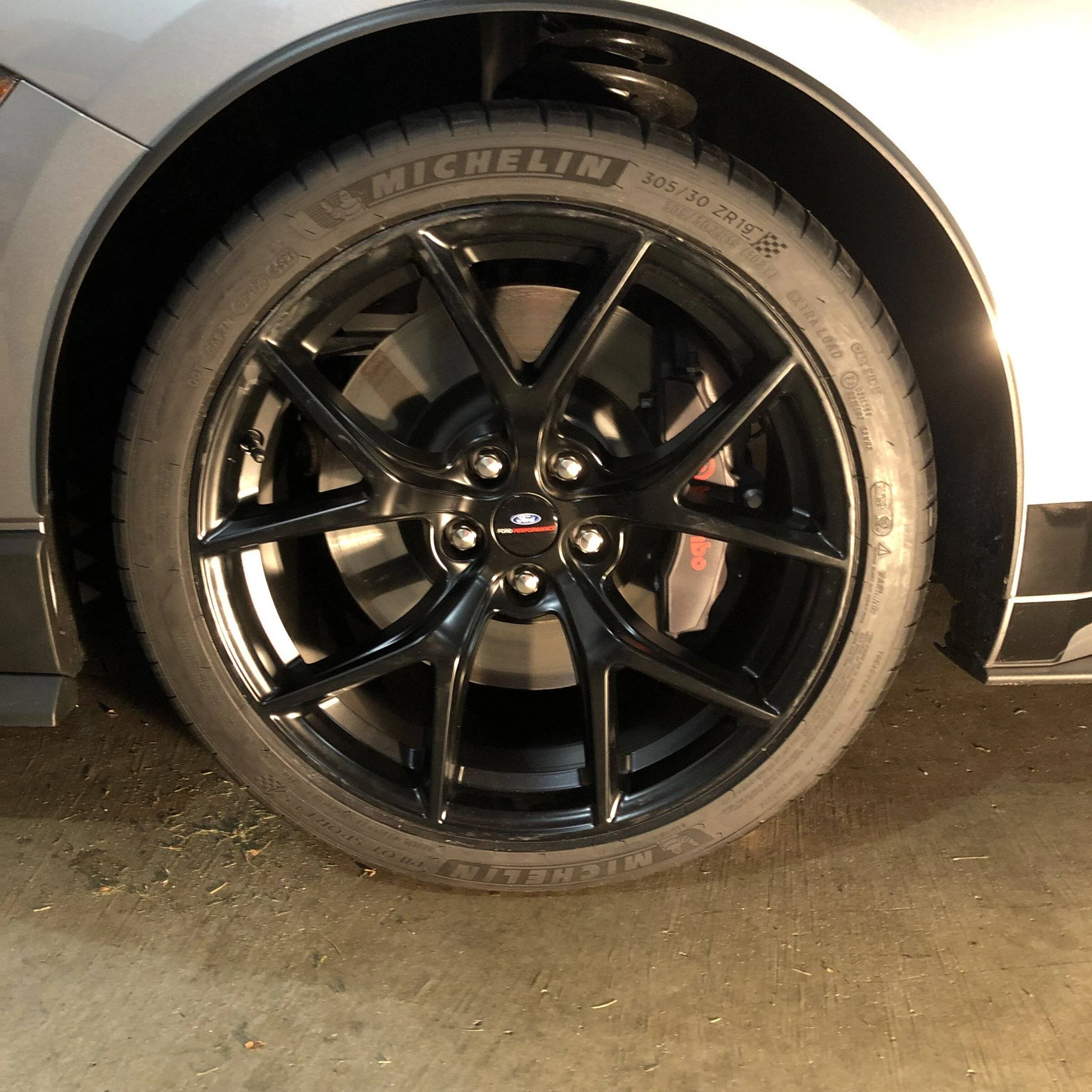

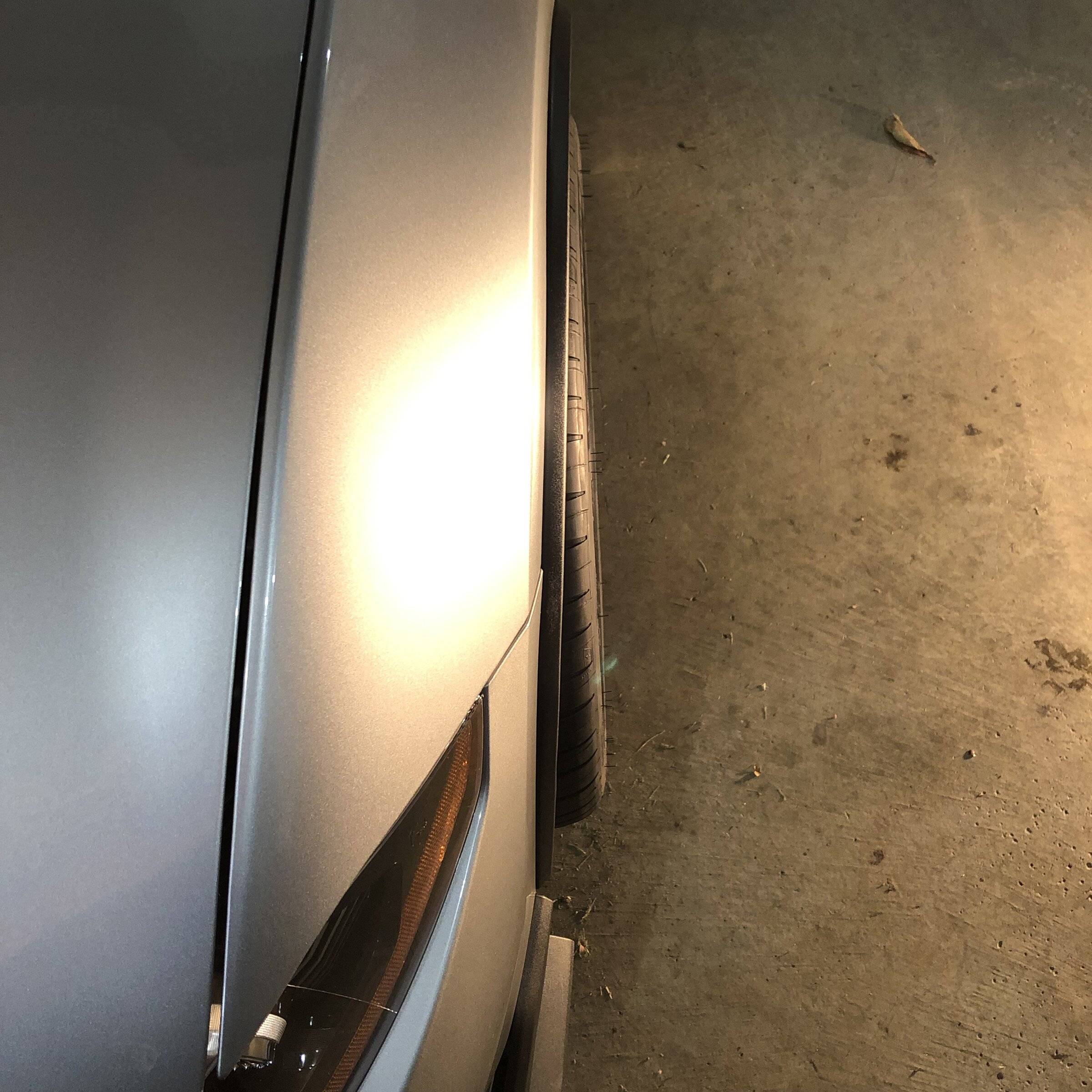

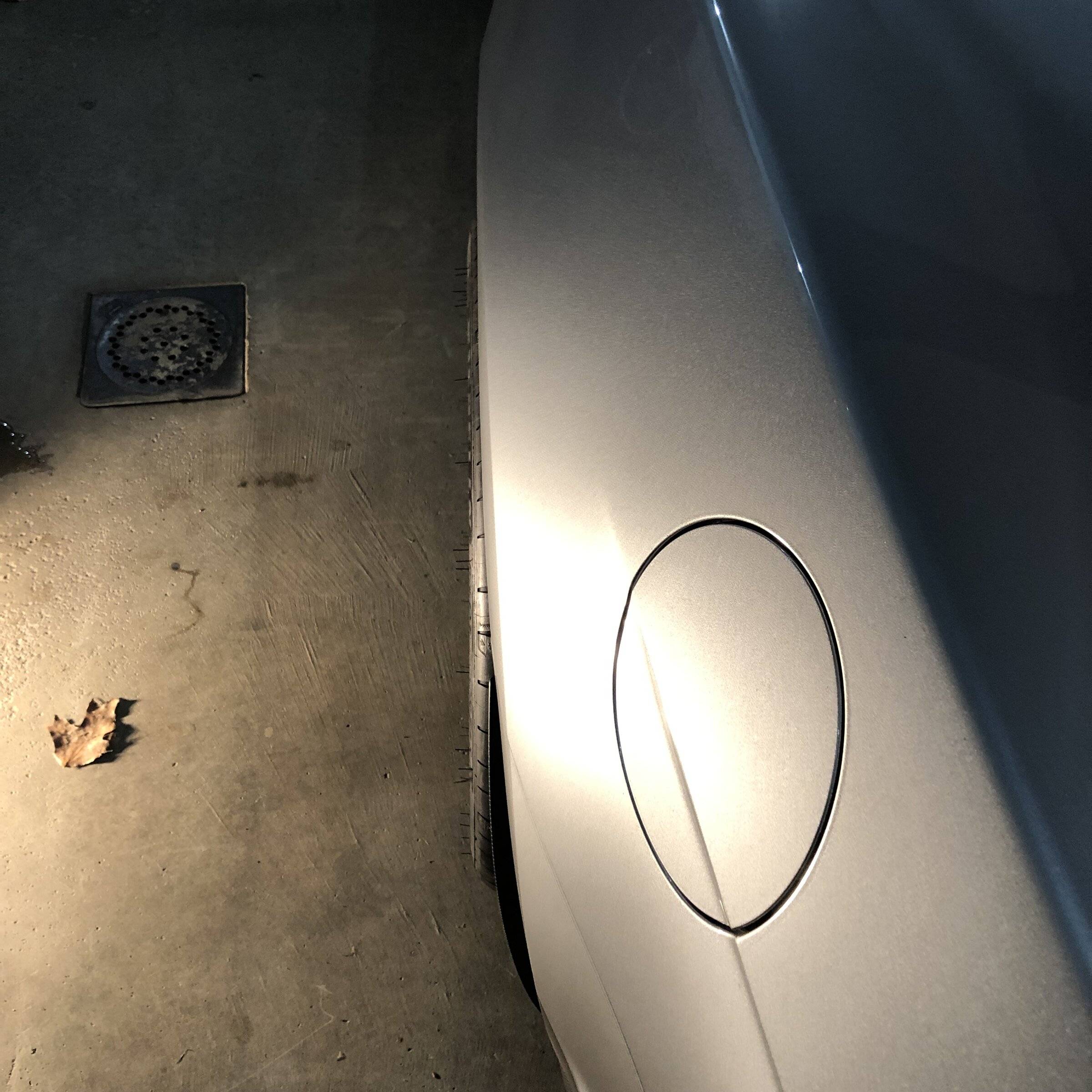

Black Ford Performance PP2 wheels and tires installed. Fronts are 19 x 10.5, +24, with 305/30-19 PS4S. Rears are 19 x 11, +48 with 315/30-19's. Front assembly 62 lbs, rear 63 lbs. They are actually a couple lbs lighter than the base 5-spoke wheels with smaller tires. Really hard to get good pics of black wheels with crappy garage lighting but the forecast says no sun for the next 10 days, typical Pittsburgh weather. Very happy with them, like them much better than the stock handling package wheels. Fender gap looks huge, like there's plenty of room to lower the car if I wanted (I don't), but if you feel behind the wheel there's not a lot of room.
These are identical in specs as the PP2 OEMs. Are they the same wheels, and same weights also? Looking great on the contrast and open design, plus much easier to clean! Congrats!
Thank you, my understanding is that these are the OEM PP2 wheels with a black finish. Same weights as the OEM PP2 (I had a set of those on my 2018 GT).

Steering wheel from Royal Steering Wheels in the UK, I opted to pay a slight premium not to have to send my standard wheel in exchange for the the wheel pictured above. link here:
http://royalsteeringwheels.com/mustang/
Paddle Shifters are made from metal, link here: https://www.harrop.com.au/shop/products/styling/s550-mustang-gt-paddle-shifters
I've added adhesive padding to the back of the shifters to give it a better feel when flicking through the gears.
Do you lose the heating/cooling?
