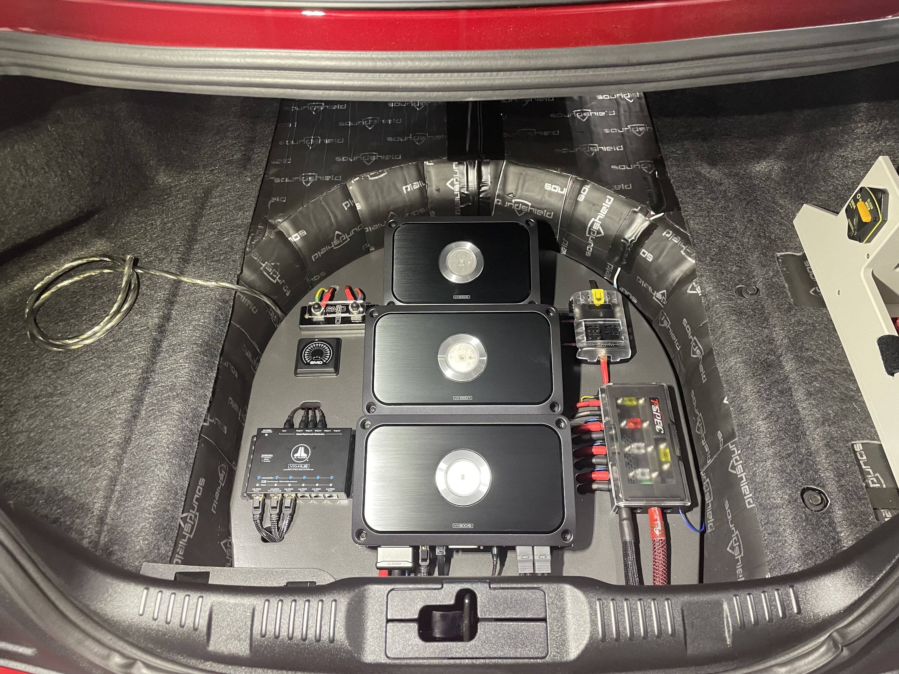

It’s been months in the making but I finally installed the amp rack in my full audio build.
Top to bottom:
JL Audio VX600/2i
JL Audio VX1000/1i
JL Audio VX800/8i
Other items are JL Audio VXi Hub, SMD volt meter, SMD fuse block (used as a terminal block), Blue Sea fused distro block, Bosch 30amp relay (hidden under top amp), and TSPEC fused distro block (with integrated remote lead distribution).
Front three-way components are JL Audio C7, rears are JL Audio C5-650X coaxials. Subs will be a pair of JL Audio 12W3v3 in a sealed box.
Full build log to come once I have everything buttoned up.

Very clean/neat/precision install!
I'm assuming you have bypassed everything that was factory linked via SYNC?
What are you using as the backer board in the tire well?

Thanks! I’m using the PAC Amp Pro to pull the signal so no stock stuff will be reused other than the door speaker wiring.
Amp rack is 3/4 MDF and painted in Krylon Hammered Black with satin clear coat.

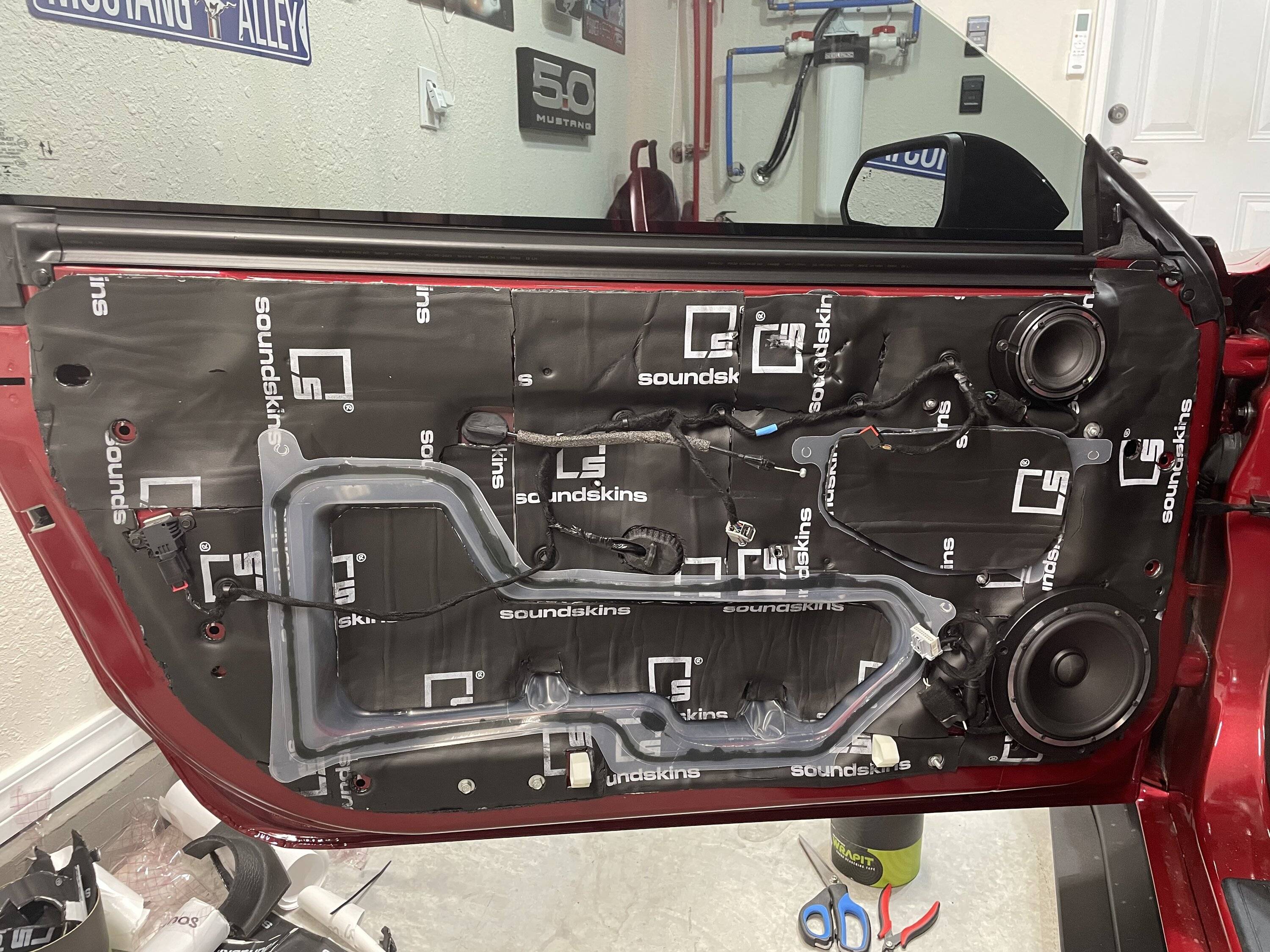

Its been a long time since i did any car audio upgrages. But i loved JL Audio back then. Looks likeba clean install. Is the sound deadening throughout or just the trunk and doors?

I used 8 rolls throughout the car. Only part I didn’t touch was the firewall and roof.

Lol well to be honest I screwed up my box. I measured the opening between the wheel wells and didn’t account for the curvature of the trim panels. I’m now building a second box that will actually fit 🤣
