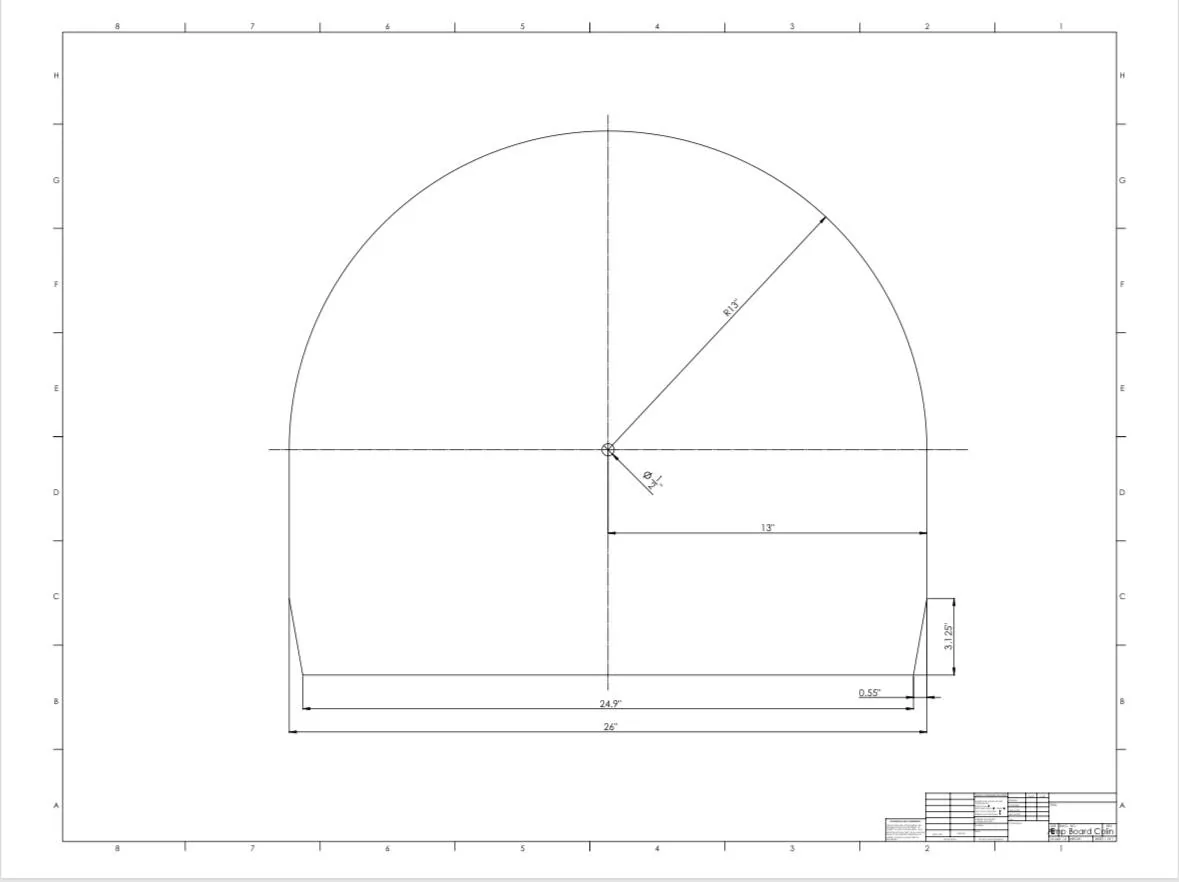

I want to install my amp rack basically a pice of wood across my roll bar legs as you see in the picture. How can I secure it on the bars without drilling holes ? Of course I can't drill holes in the bar so please I am open to ideas.
Thanks
Just a thought.
4- 1.75 stainless steel butt joint clamps.
a rubber sleeve to keep them from sliding/rattling
3/8 board between bars (remove center of clamps)
Flatten ends of clamps and add carriage bolts .
