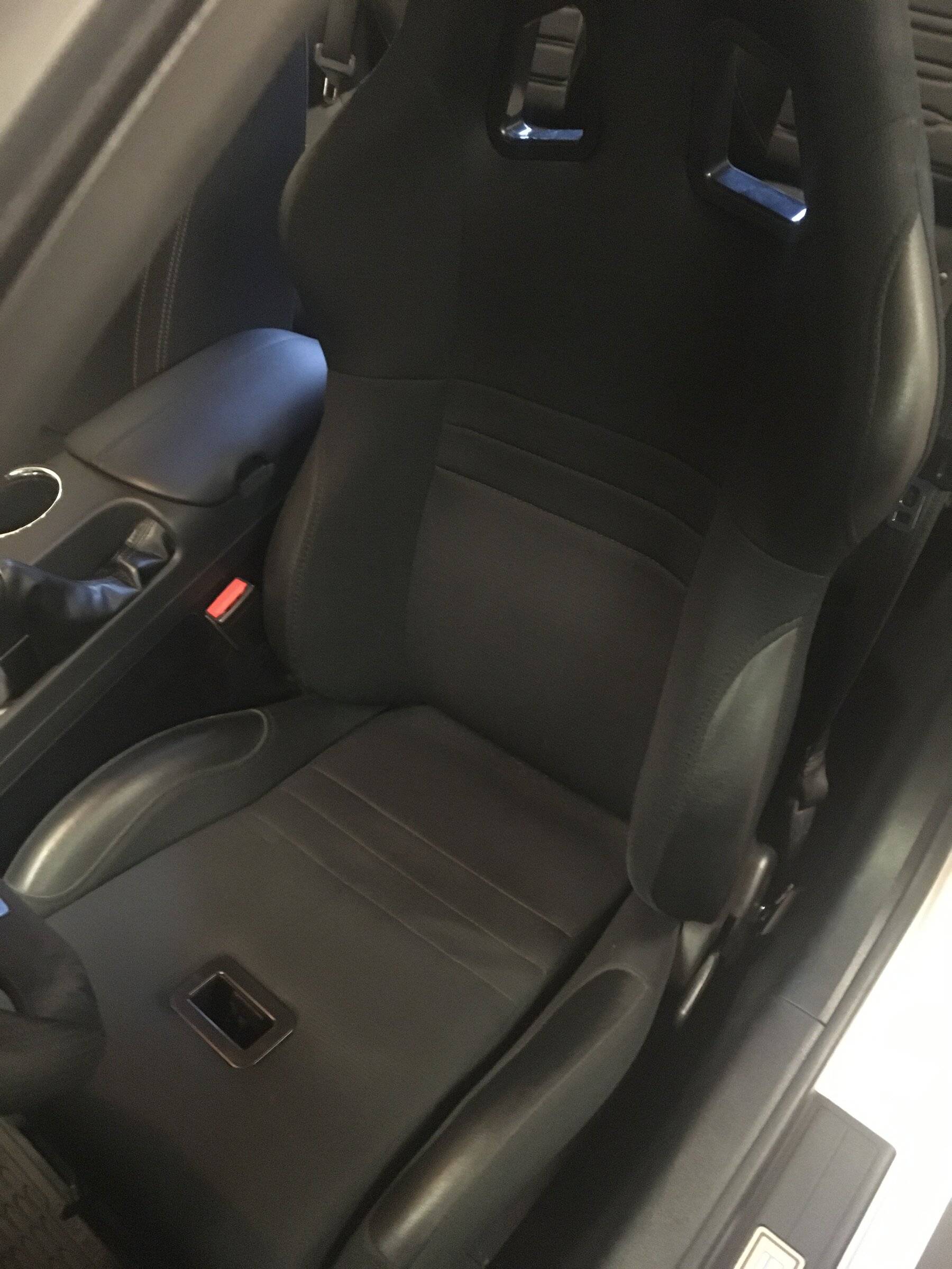

Don’t get a Recaro seat, get a real track seat that has a crotch slot for a 5/6 harness
Corbeau gt4, reclining seat is a great compromise for a car that is still driven in the street
Anyone that say that a regular seat with a 4 pts harness hold you in place, are simply not going fast enough….😁
