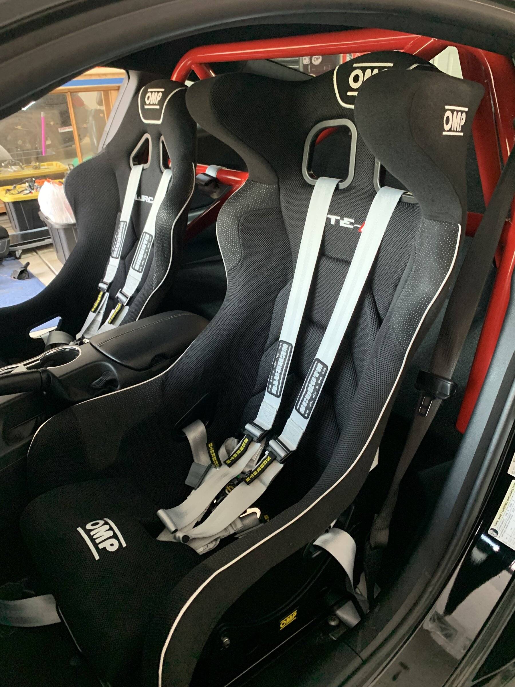

1. Safety (4pts work, but 5/6 pts are a lot more comfortable and do a much better job holding you in which allows you to focus more on the driving). I'd also suggest swapping in a proper race seat. I used the OMP Champ R for 2 years before full track conversion.

Thanks Everyone! A few follow-on questions.
Race seat + harnesses:
I don't really have any prior experience with this. Is it completely miserable for normal street driving? Or is it still pretty quick to get in and out? I'm willing to tolerate a little bit, but still will continue joy riding the mountains I think (even if it hits a lot less hard than it did pre-track experience).
Also, how difficult a job are these things? With a goal of being a little bit lower and not miserable getting in and out (I have had the occasional back pain flare ups unrelated to car activities), should I be able to find a relatively easy to install solution?

Don't replace the seat. Track seats and belts are a dangerous on the street, IMHO. The airbags were designed for 3pt and you'll want in the event of a street crash. Swap a seat in for track days. Takes 20 mins once you get the hang of it. Safer and more comfortable for everyone. Passenger seat can stay OEM.

Gotcha. Should I expect that all seats I would be looking at will easily swap quickly? Or are there particular categories / keywords that I should be looking for?
Thank you for the patience and answers, I'm quite ignorant in the topic.
