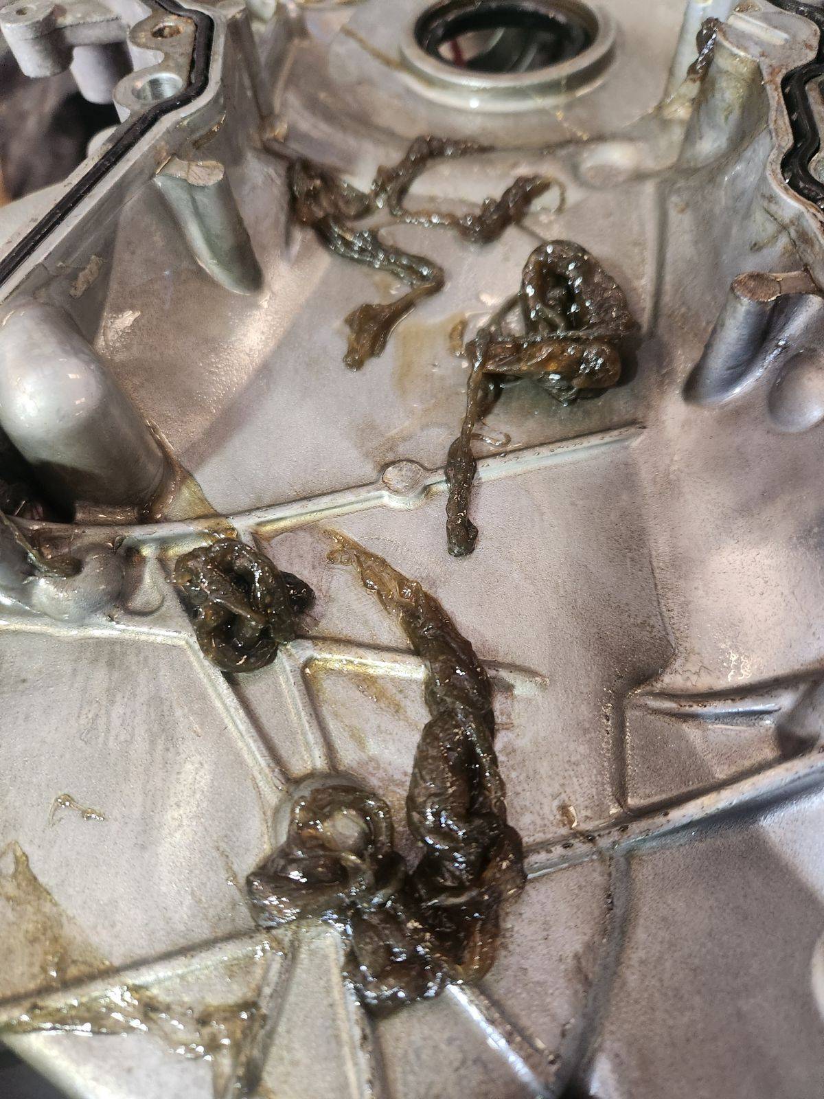

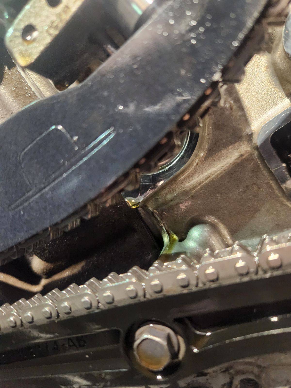

Put in some aftermarket one-piece timing chain tensioners while the motor was out and we were upgrading some other things. Well, it didn't work out. ~200 miles and we've got a mess to clean up. Stringyplastic fiber crap, mostly contained to the timing cover area.
Did a pretty good job clogging the up the oil filter, but I noticed it wasn't making the right pressure and parked it until we could investigate. Hopefully we might have caught it in time? Will see how it goes.

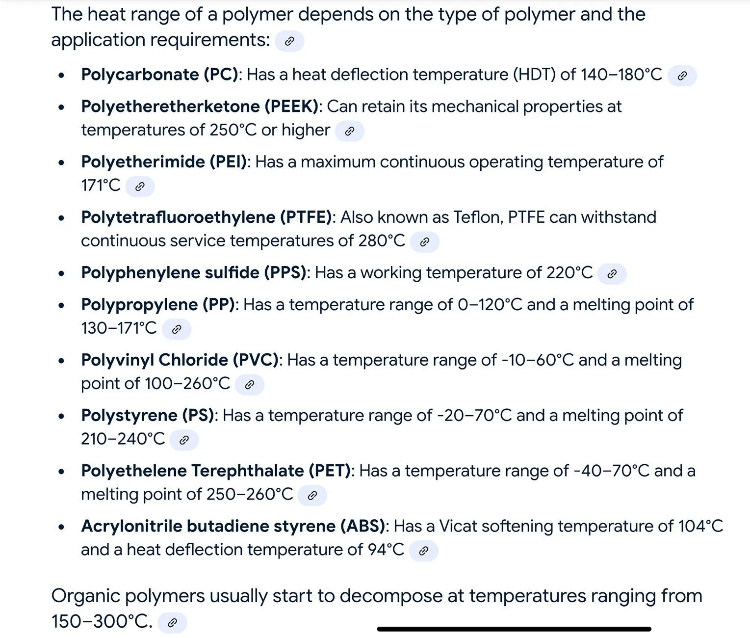

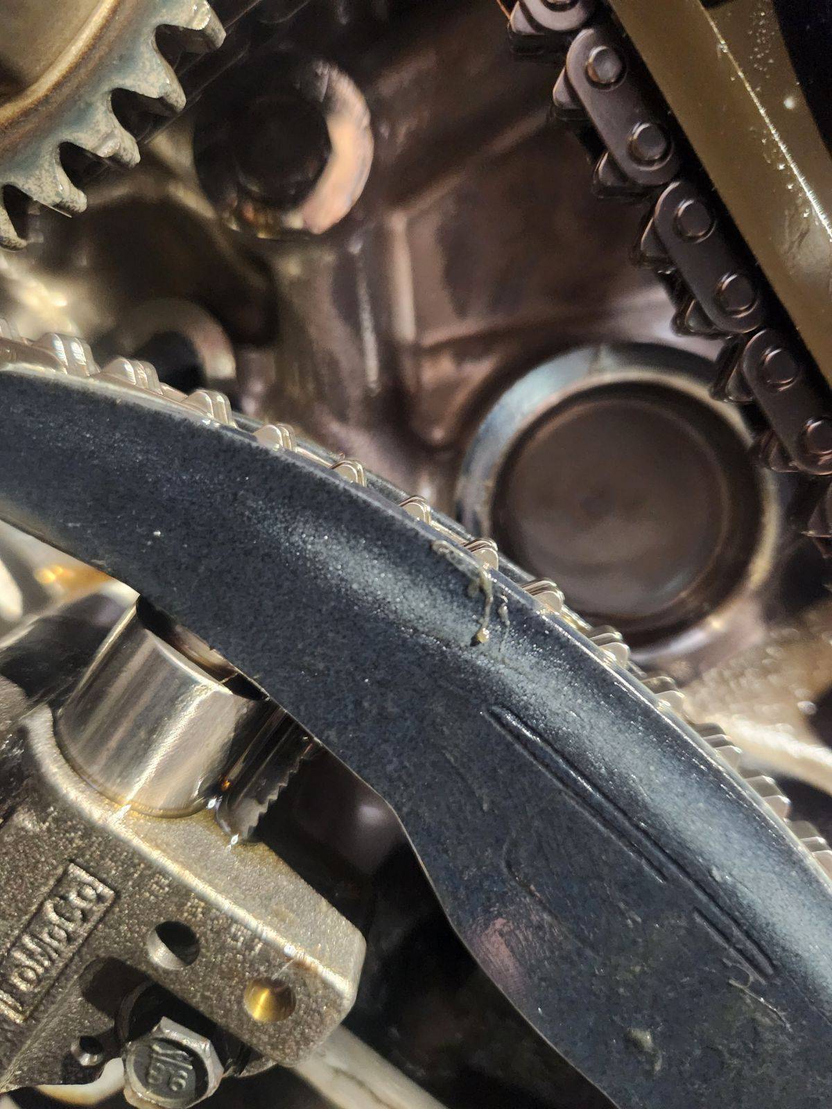

@NightmareMoon the chain is almost buried into the arm, when it should be riding on top of it. I found this info as well to show temperature tolerances on polymer and materials.
Thermal
Because Delrin does not use plasticizing to attain its toughness, it does not suffer from brittleness at low temperatures. Its impact resistance at temperatures as low as -40° F is only 20% less than its resistance at room temperature.
For elevated temperatures, Delrin retains excellent strength at temperatures as high as 200° F with a tensile strength of 2,000 psi and flexural modulus at 180,000. Delrin’s upper service temperatures are 180° F in open air and 150° F in water and can withstand brief temperature peaks of 250° F.

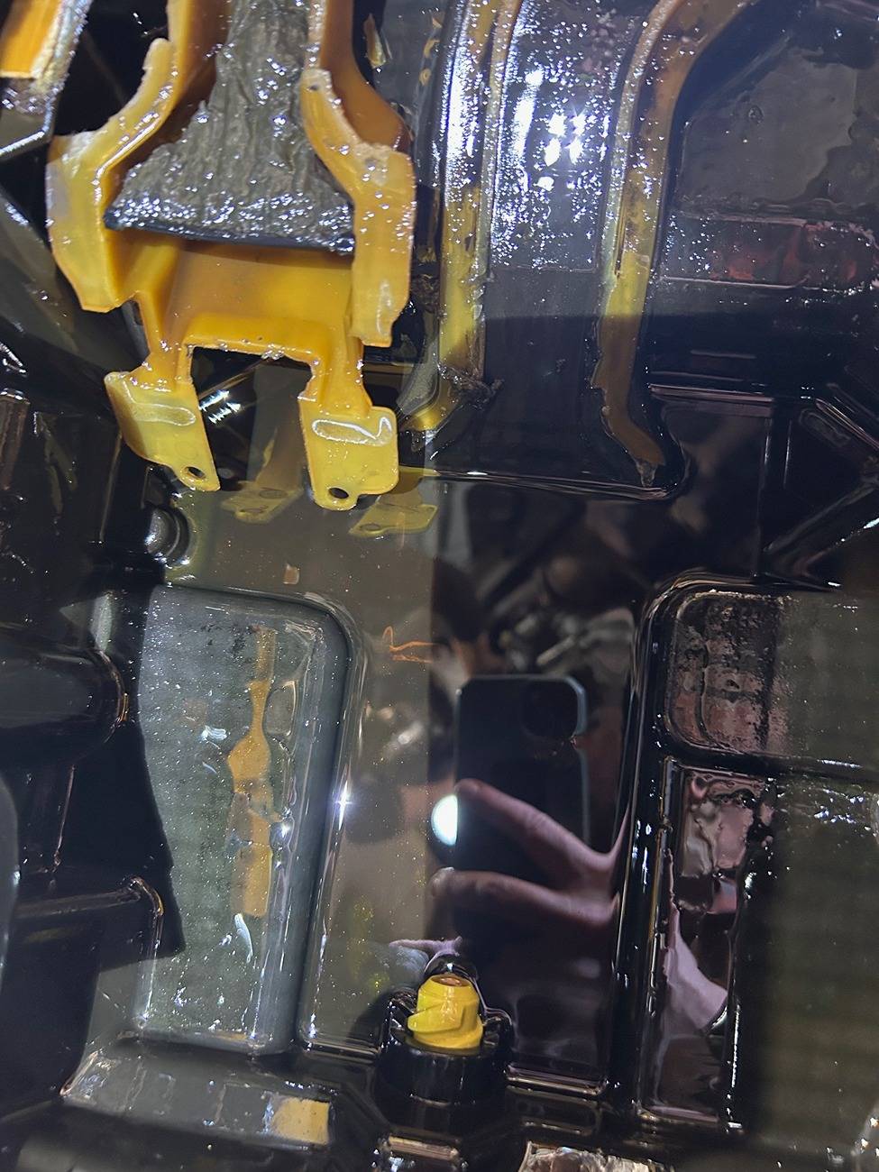

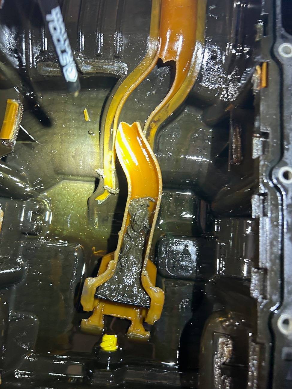

Well, the stringy slime stuff was generated on the front timing area. Most of it which wasn't wrapped around the timing gear seemed to have gotten caught at the oil pickup screen.. Boy that oil pan pickup was clogged up worse than a toilet after a taco bell dinner. I think the oil filter caught the rest.
The oil pump looked ok, but its getting a new Ford pump and pan just in case. The passageway from the pump to the oil filter will get cleaned. We think the rest of the oil passageways are clear (timing chain mess->pan->pickup/screen->pump->filter adapter->filter->oil cooler->engine passageways)
Some glitter in the pan. None of it magnetic (so probably bearing material). We found minor wear on most main bearings but one rod bearing was pretty bad. Unsure if the glitter pre-dated this issue (the motor was a used 38k mile motor out of a wrecked car) or if the bearing damage was caused in part by oil starvation from it, but the motor is getting new bearings now too.
