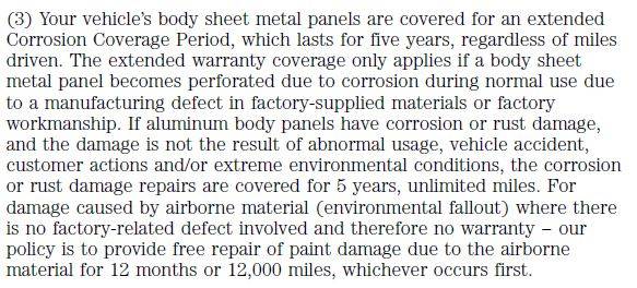

The 2016+ Corrosion coverage for aluminum panels is 5 years/unlimited mileage, whichever comes first. So yes if you bought a 2016 Ford new at the end of 2015, or within the first few months of 2016, the “5-year” part of the 5/unlimited has certainly expired by now (Nov 2021), image courtesy of @GT Pony:

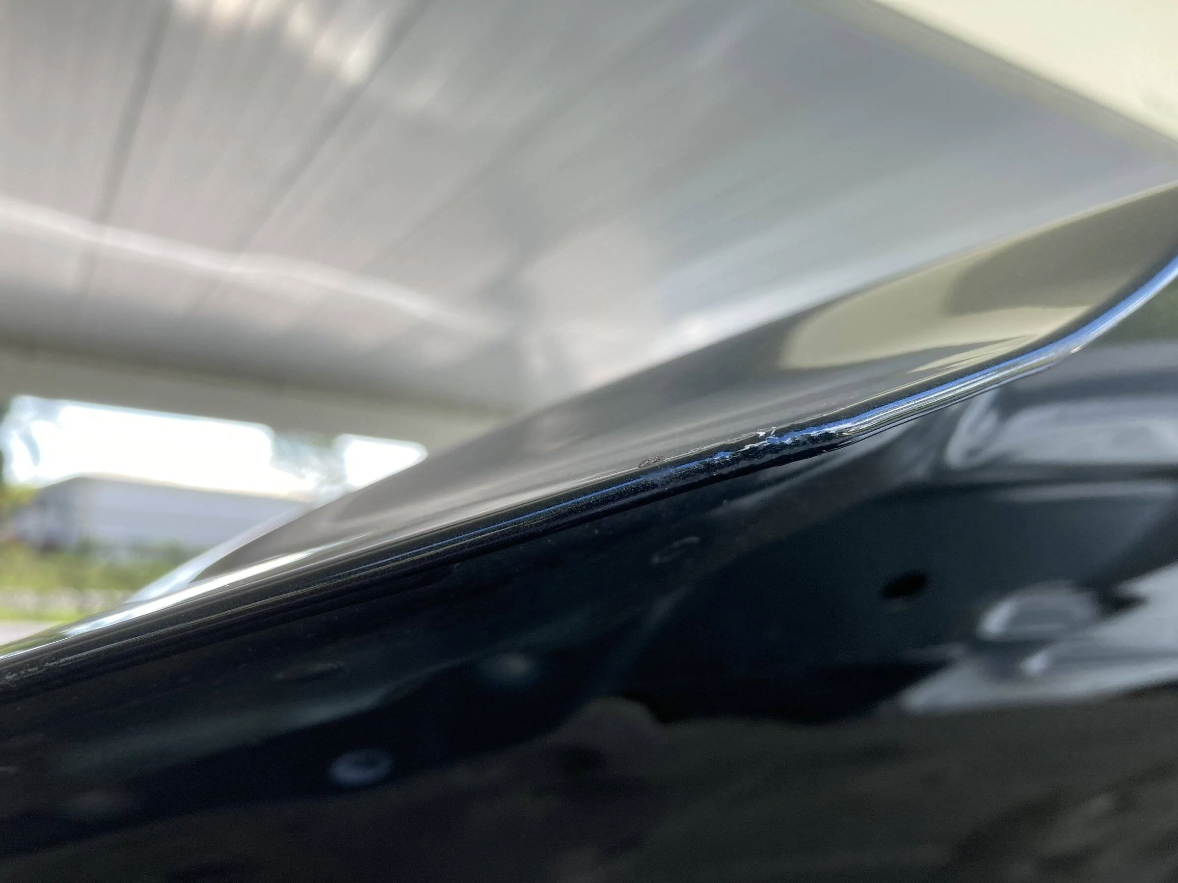

You got any photos of the area of corrosion?

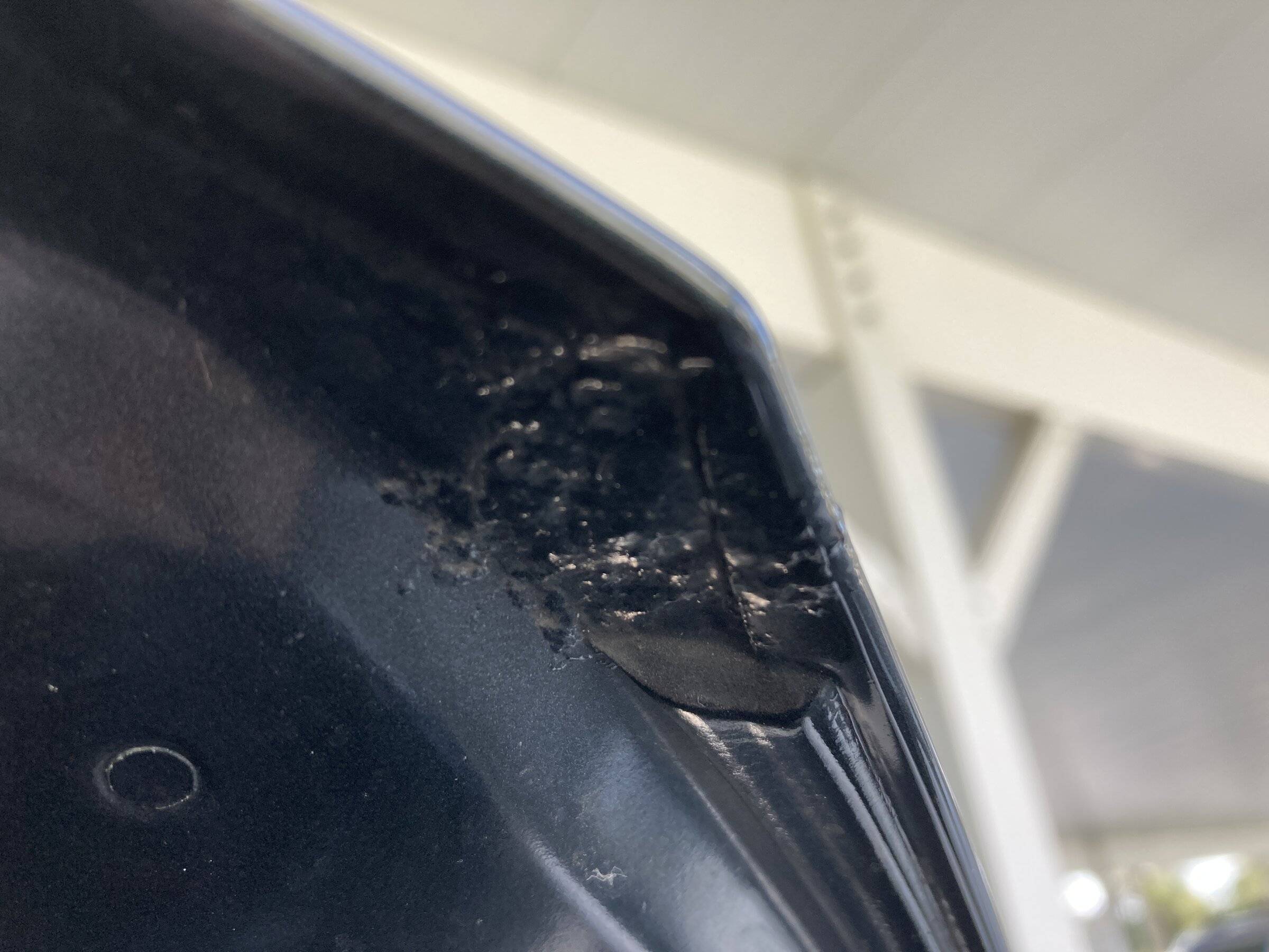

Currently in the body shop to get the front bumper "refreshed" Previous owner was not too diligent when it came to removing bugs and small paint chips. I'll get you some photos of hood corrosion when it gets home at end of week. Balance of body paint is in excellent condition, with exception of the leading edge of the front hood. Not complaining, since the poor condition of the front bumper saved me thousands during the sales negotiation.

Are there rock chips on the leading edge of the hood where the corrosion is starting? Could be that caused exposure to water/moister that kicked off the corrosion. People need to look at the leading edge of the hood and touch-up any chips ASAP.

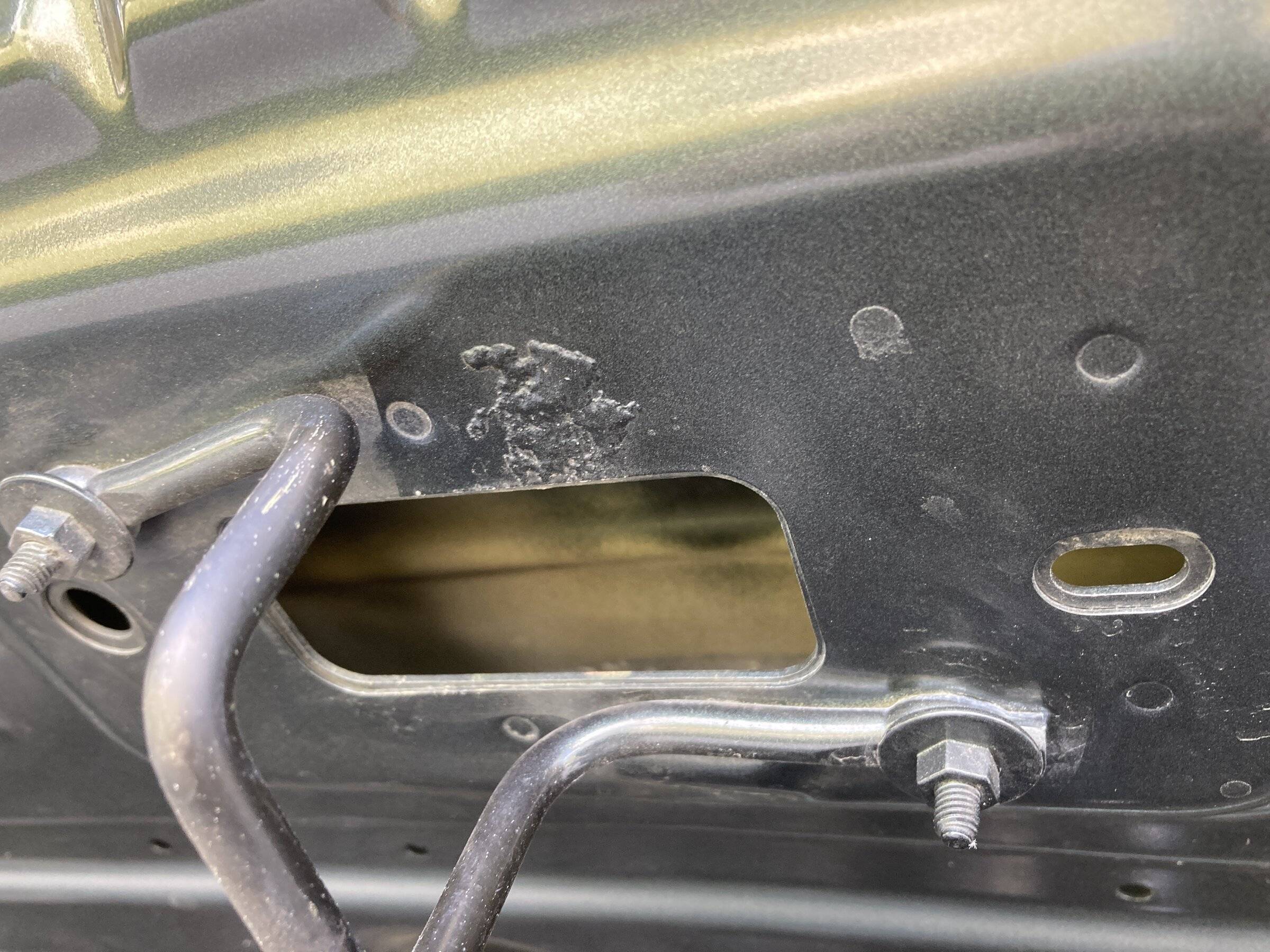

No rock chips, just paint bubbles with no rust showing at the moment. Small bubbles on left and right side of leading edge . And, two large bubbles on underside of the front of hood. You will see when I get you some photos this weekend. Considered having hood done with front bumper, but for two reasons; i.e considering replacing hood with new F/G one and my body/paint guy is a master at blending. Trust him implicitly if I decide to repair this hood in future when rust actually appears. Last March my guy repainted the front/rear bumpers and left front fender of my 2002 BMW 3 series. That paint spent 20 years here in the Florida sunshine. He did an incredible job of blending with balance of body paint.

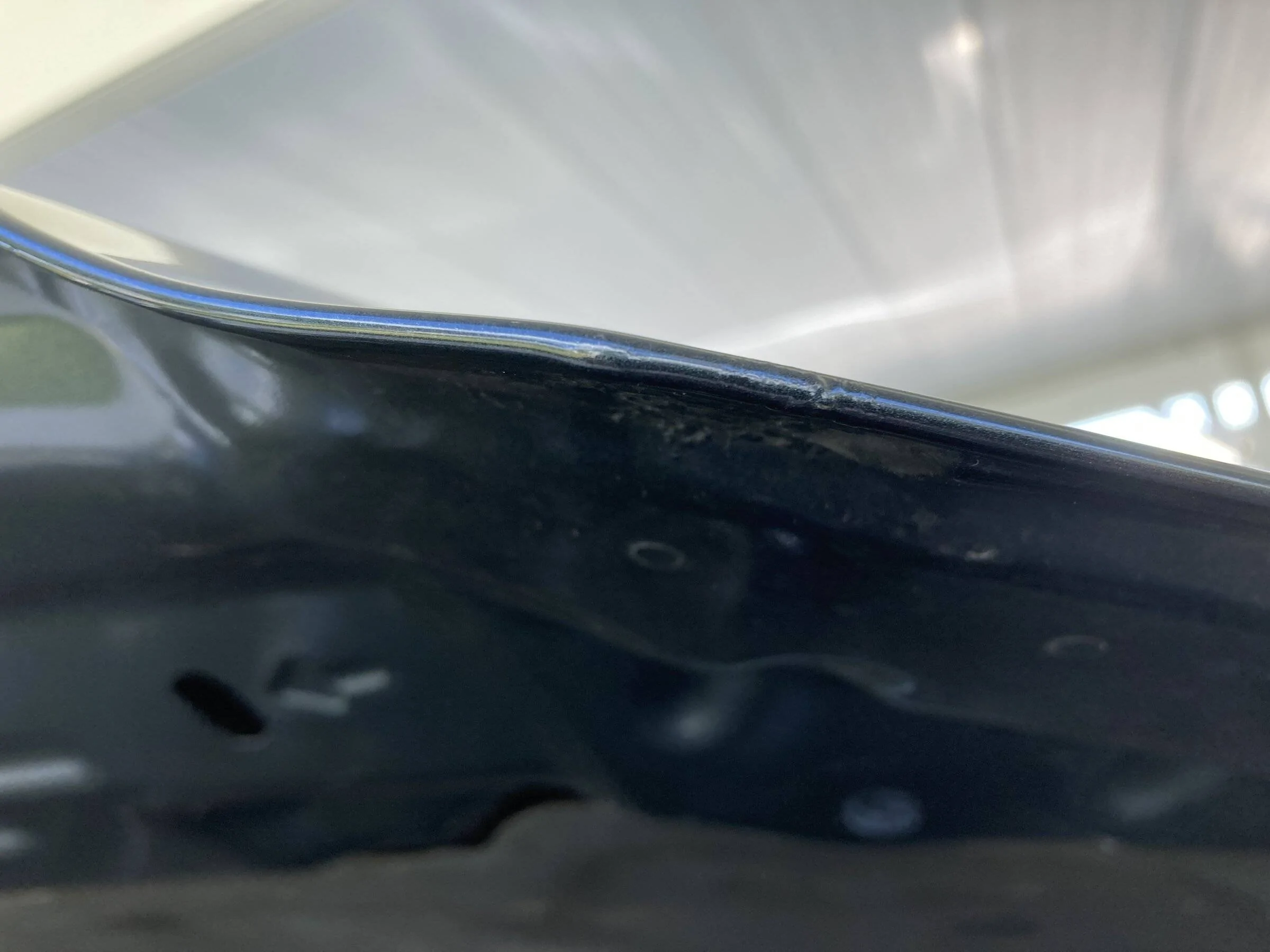

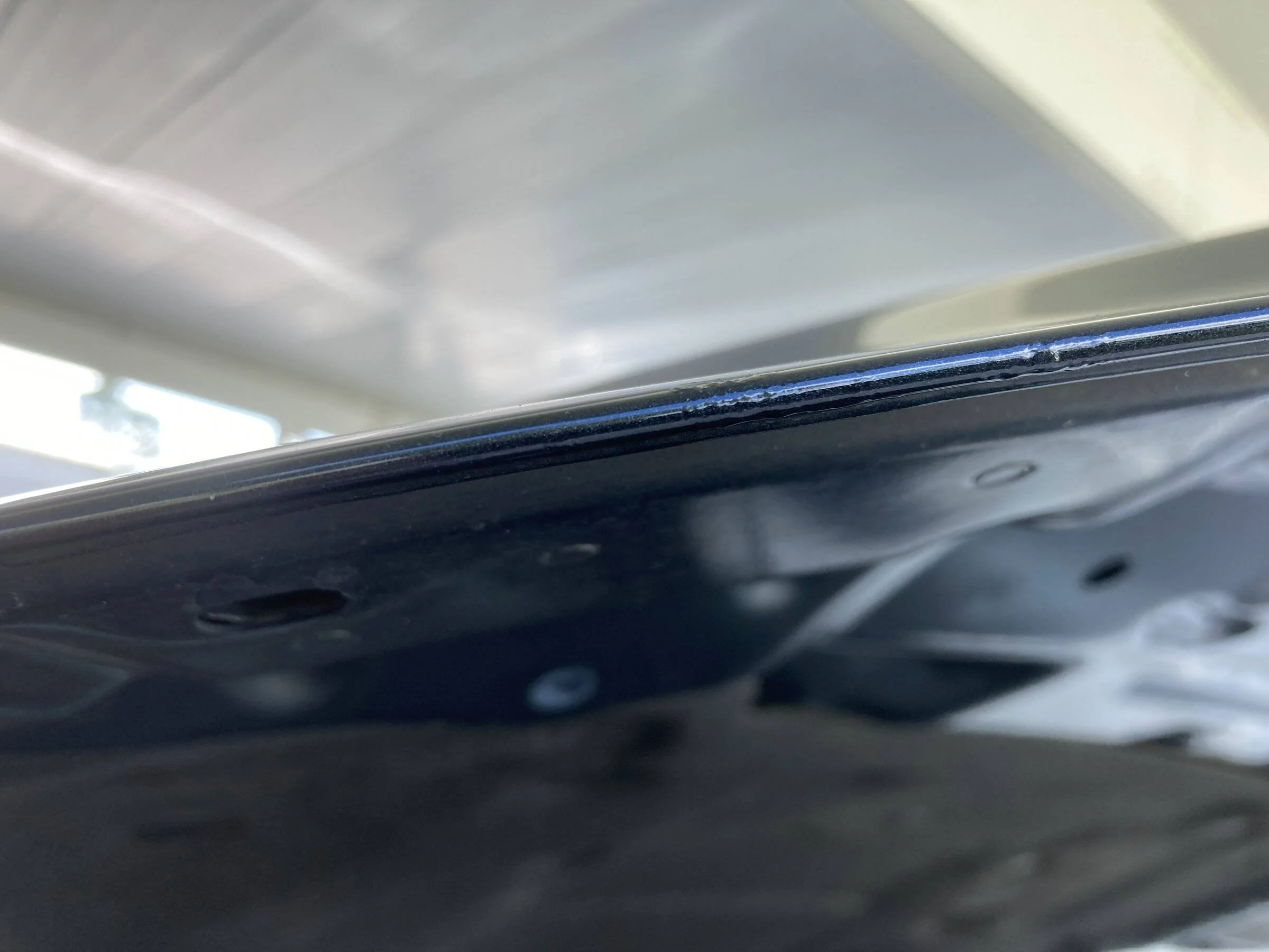

Just got my EB back from body shop and my guy did another fantastic job on the front bumper and the paint blending. As promised have attached some photos of the corrosion on leading edge and under front edge of hood.

good luck! my 06 GT had the same hood issue and I bought it new. Ford paid for 2 repaints, third one was on me. This started in second year of ownership. Last time painted was 2019...summer before it was retired!

Repairing is typically a temporary fix. That's why Ford went from repairing to replacing the hood (per TSB) because they finally realized repairing isn't a permanent solution in most cases.

unfortunately when this occurred (2008, 2009, 2019...)they repainted only....didn't know they are currently replacing. I was going to change the hood to fiberglass at one point but couldn't find one I liked. Hopefully I won't deal with this with the 2021.
