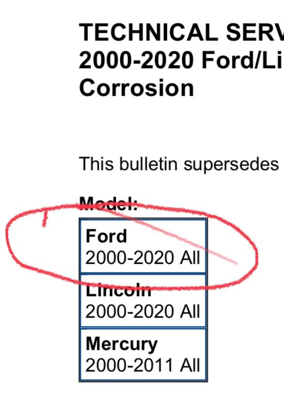

The TSB is the first post in this thread. Print it and take it to the dealer, or maybe a different dealer if yours is not cooperating. I already had my hood replaced under this TSB. No issues...
https://www.mustang6g.com/forums/threads/tsb-19-2026-aluminum-panel-corrosion.117031/
I am having same problem with hood rust on my 2016 Ecoboost. After showing my local dealer TSB's 19-2026 and 20-2233 They still claim that Mustang is not covered under these TSB's. Do you have paperwork that documents that Ford replaced your hood under these TSB's? If so, would you mind sharing a copy of the documents with me. I feel that would be great ammo in my battle with Ford over this issue. Thanks in advance
Mariner46
Unless I’m reading this wrong your dealer is a moron. What part of “all” do they not understand. Unless, of course, they are claiming that a Mustang is not a Ford.

The verbiage in the warranty documentation from Ford is what triggers the warranty if your car is still under the corrision warranty - I pointed that out in the hood corrosion thread.
All the TSB says is to replace the hood instead of trying to repair it because Ford knows (finaly) that repairing almost never lasts and it just keeps corroding after a repair attempt.

You may be misunderstanding my request. Do you have any texts, emails etc. from Ford informing you that they will be replacing your hood?
I already answered you about that in the hood corrosion thread.
It's clear that if you have a 2016 that is still under the 5 year corrosion warranty, then Ford should replace the hood under warranty. If your dealer can't understand Ford's written warranty and the TSB, then call Ford and have them explain it to the dealership service manager.

^This. Showing them an email or similar may result in a 'deer in the headlights' response and some obfuscation thus being a waste of time. If they can't understand the written word then Ford higher is probably the next 'best' option. Alternatively try another dealer?

Thanks to everyone for your input. Guess my next action is a call to CS at Ford.
