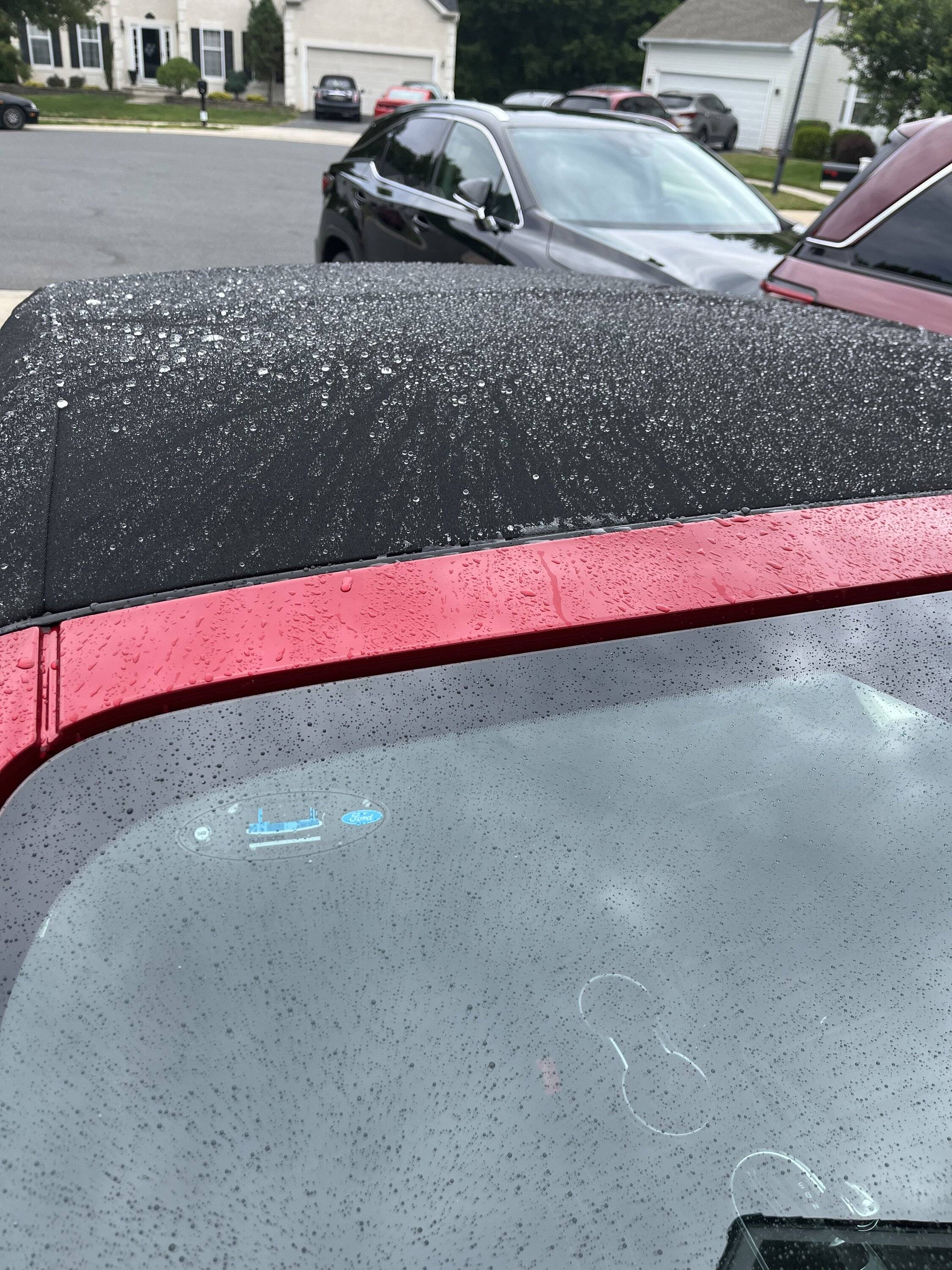

Your 2019 GT Convertible has a fabric top. Here is a photo of my 2019 GT Convertible's top following a rain after cleaning it with 303 Tonneau & Convertible Top Cleaner, then two applications of 303 Fabric Guard.
Some folks here brush it on. Some of us spray it on. Most recently, I have sprayed it on, then rubbed it in with a disposable plastic glove, to get it into the fabric instead of sitting on the surface.

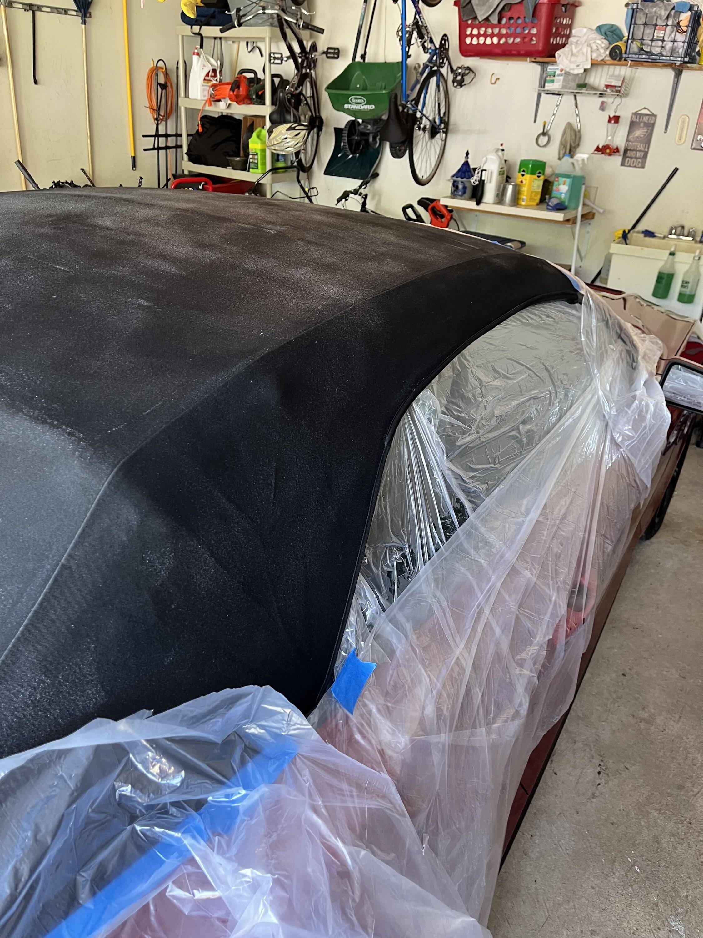

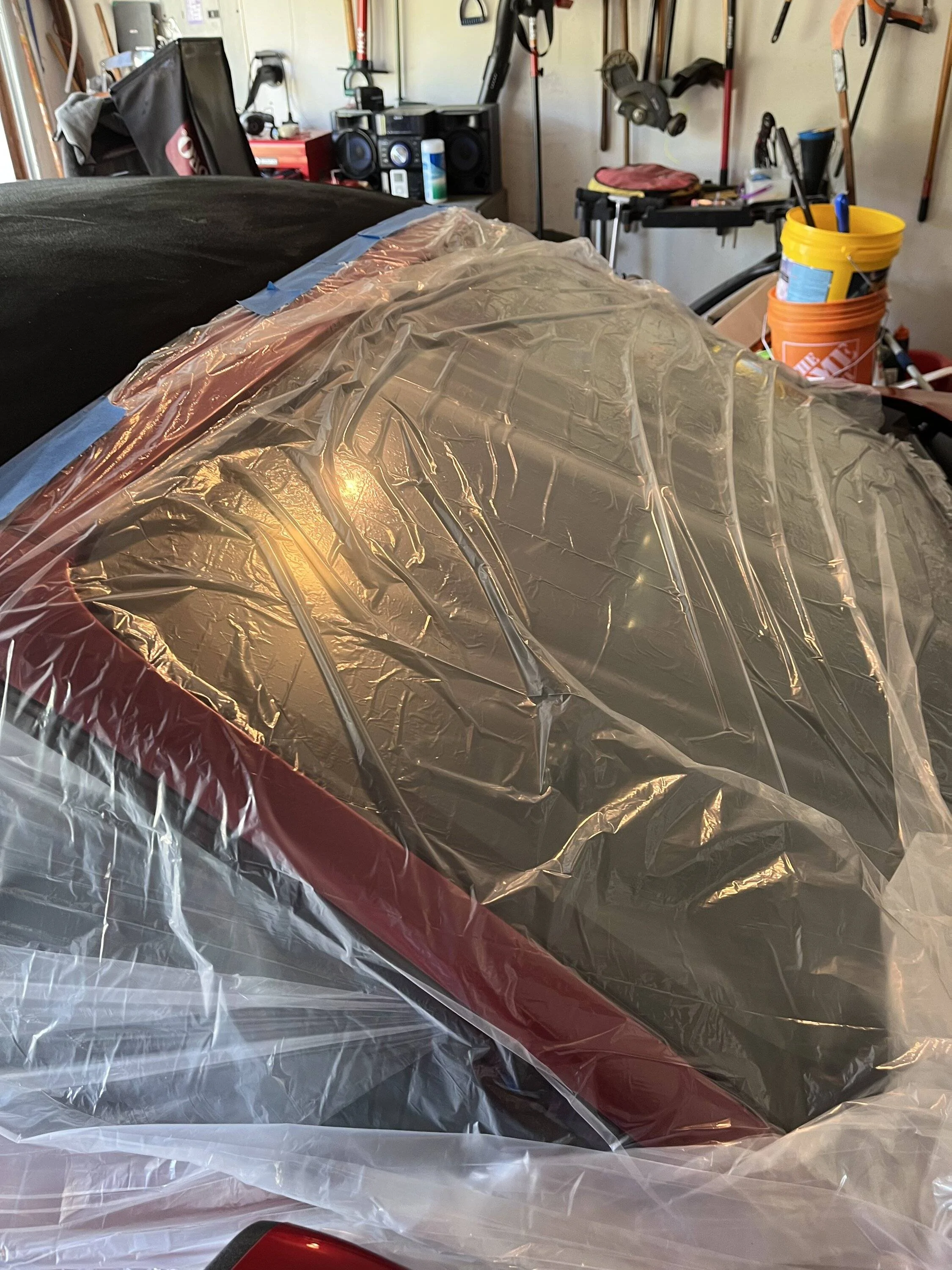

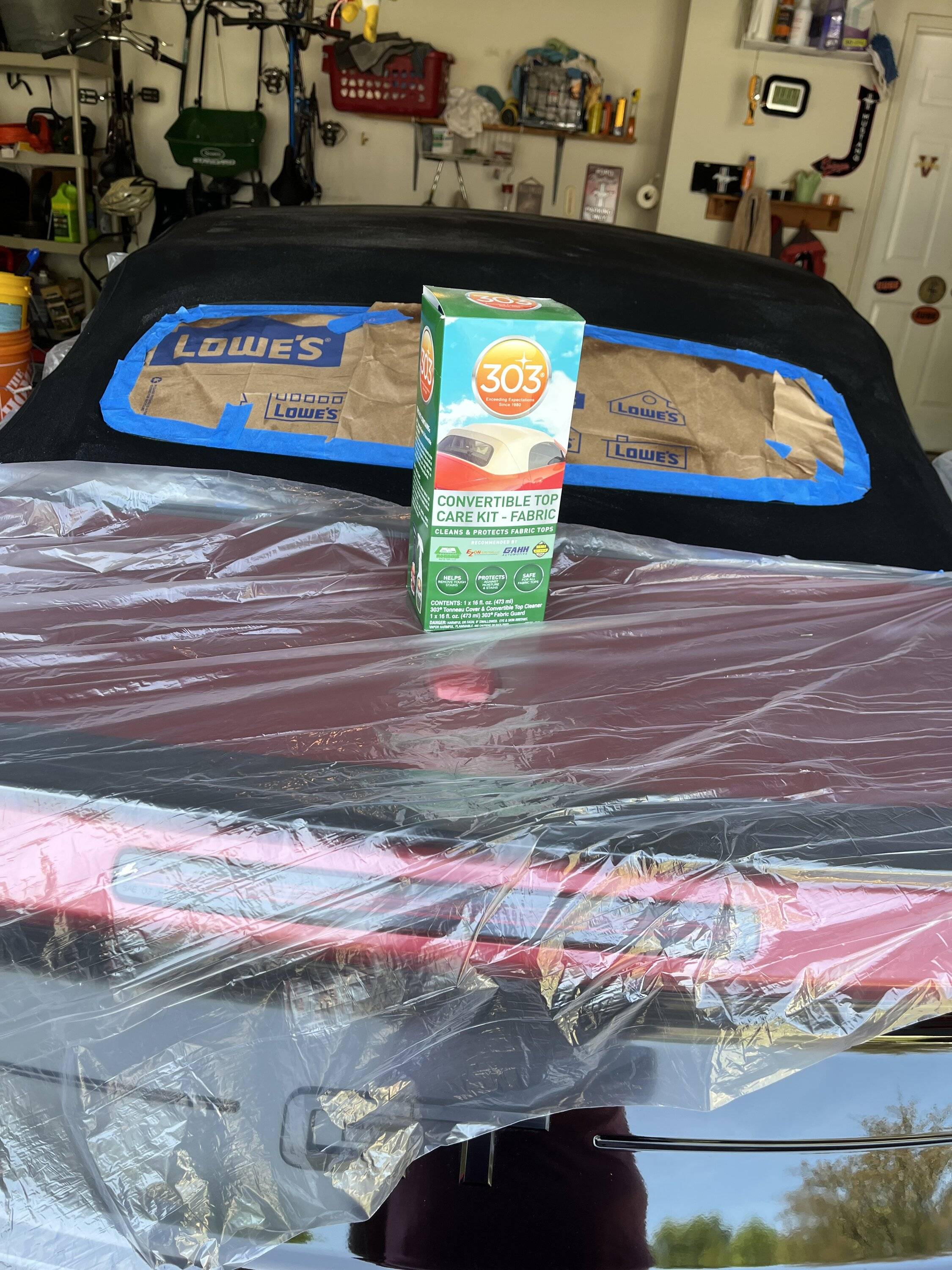

303 For me. It’s all about prep work.
  1. Vacuum top.
  2. Clean top with 303 cleaner. Use a soft bristle brush.
  3. Wash the rest of car. Allow top to air dry.
  4. Vacuum top again.
  5. Prep car, cover windows and paint.
  6. Run a lint roller over top.
  7. Spray 303 fabric protection.
  8. Work in with a brush, and then mist.
  9. Allow an hour before removing protective coverings.
  10. Let cure for 24 hours.

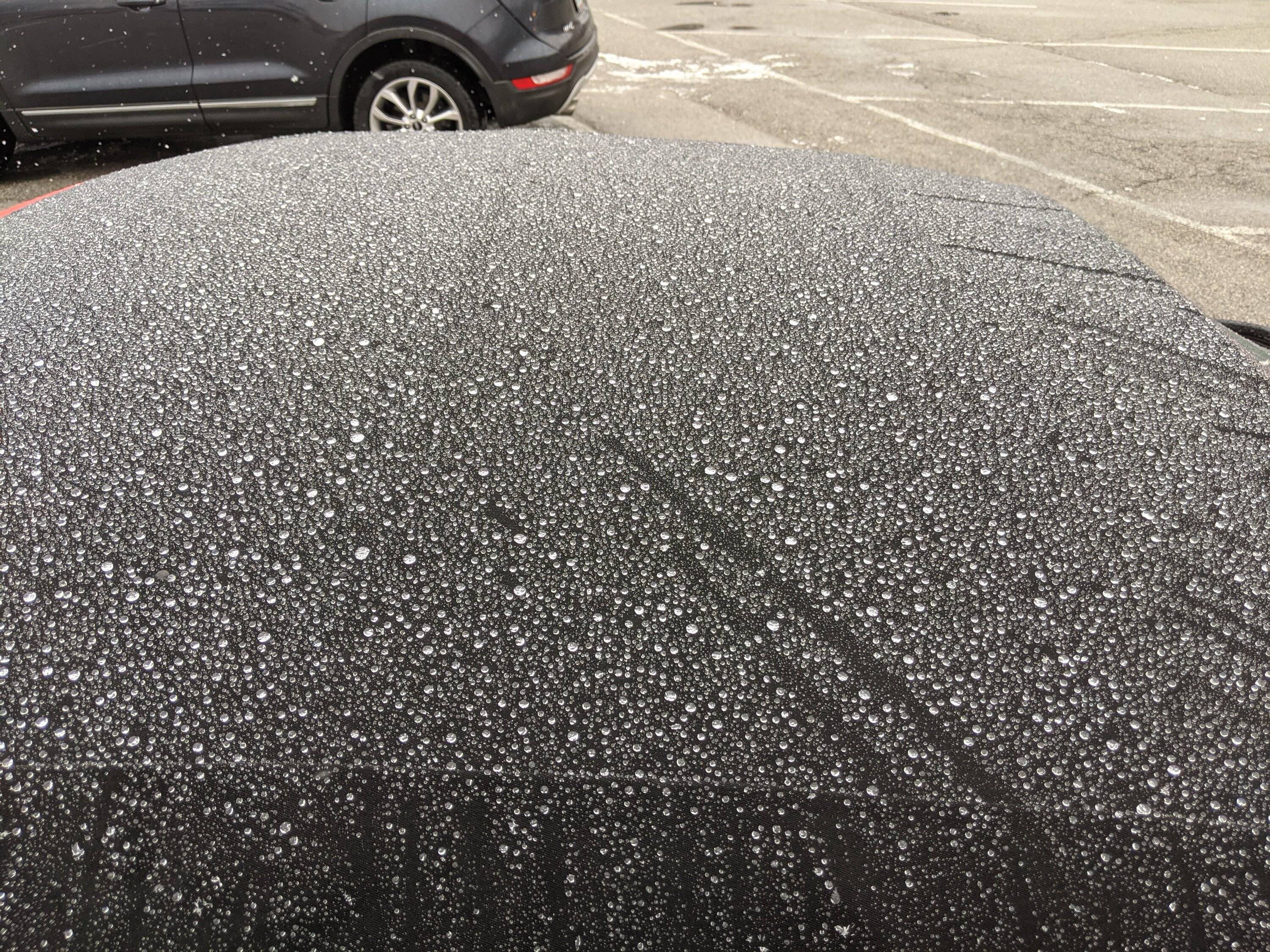

Bead test the next day. Funny thing is the only time the top gets wet is when I wash the car. Never drive it in the rain. 😀
