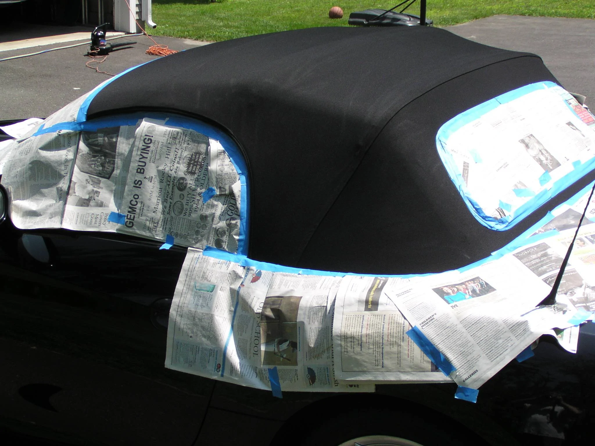

I've used RaggTop on convertible tops before with great results. But like you say, it is pain to mask off everything before spraying it on. RaggTop comes in an aerosol can, so in order to get good coverage, you need to spray right up to the edge, so masking is pretty important.
It looks like the Chem Guys product is in a regular squirt bottle and that you can spread it with a brush/cloth to even it out. You do need to be careful with how/where you spray it, but it seems like you could be less fussy with masking. I actually was planning to give their product a try for just that reason.
