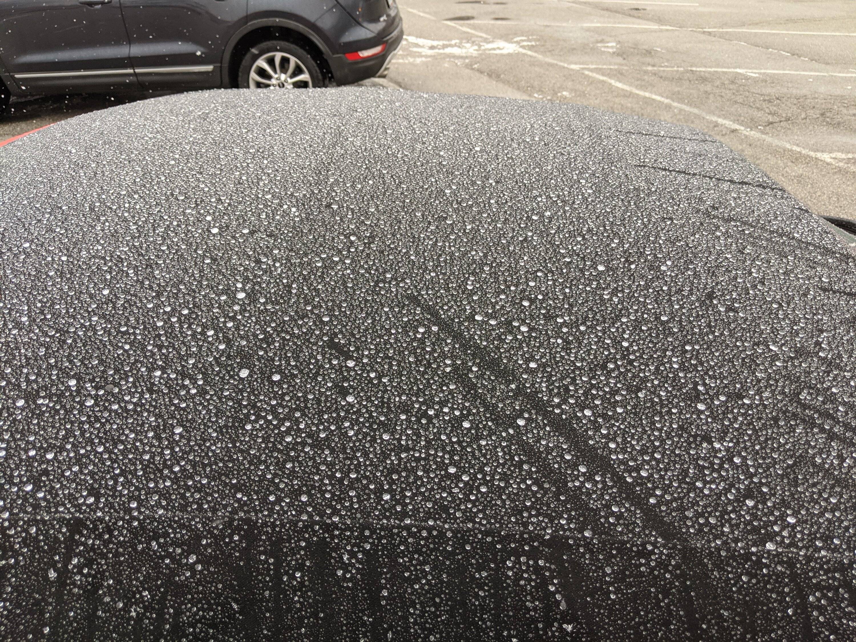

I use the 303 once a year. Garage kept, doesn't see water, except for washing.

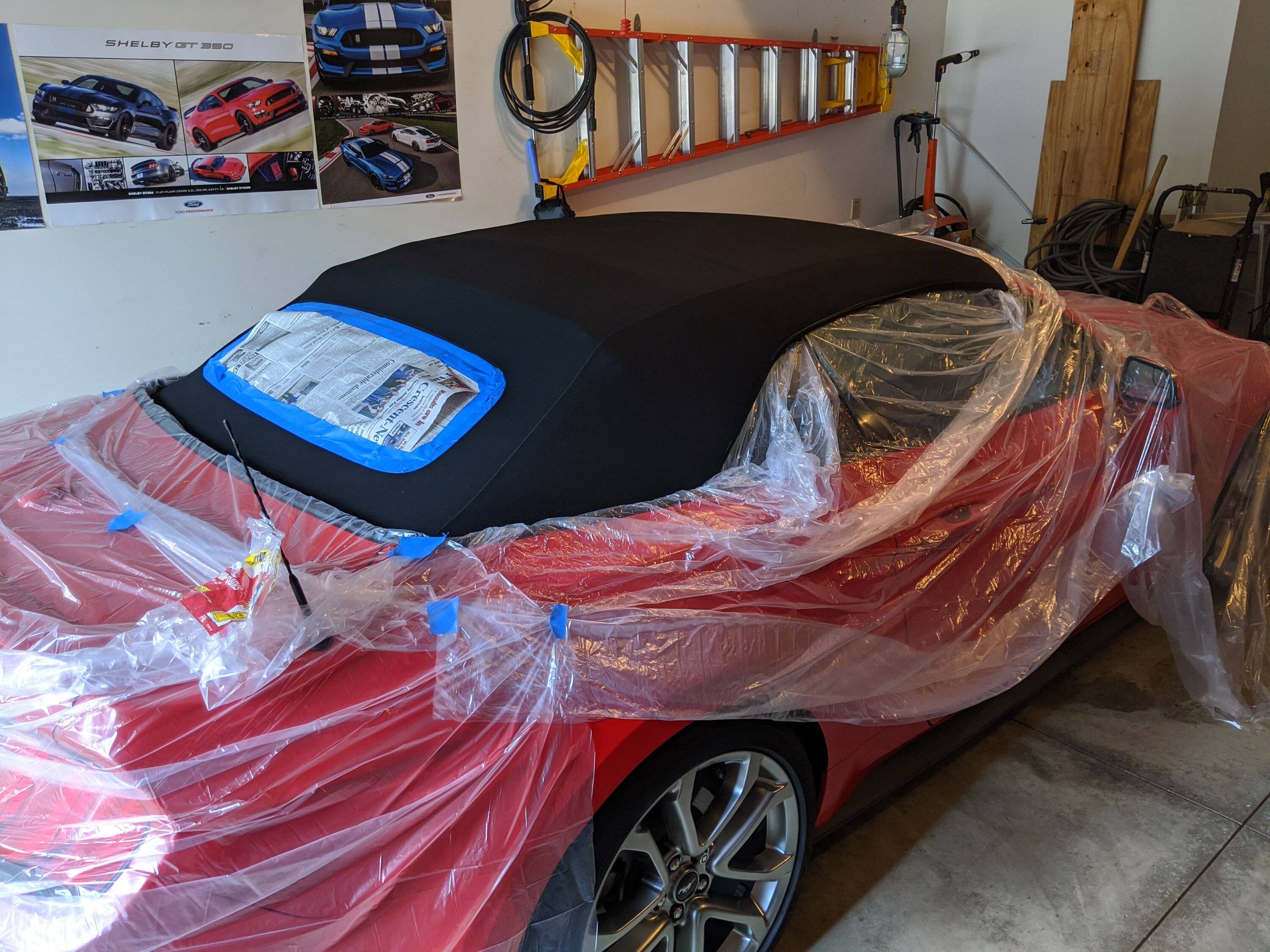

mmff88gt That's one impressive masking job. WOW! Want to do mine?
mmff88gt
Nov 22, 2019
116
271
NW Ohio
2019 Mustang GT Convertible
Sorry I didn't see this earlier. It really doesn't take long. I get the cheapest, lightest plastic drop cloths at Menard's. I raise the roof a couple of inches, raise the windows, and work one drop cloth over the hood to the back of the rear windows. I work another across the trunk and down around and into into the seal at the rear of the roof. I seat the roof and raise the windows completely, then tape the drop cloths together -- as you can see -- over the rear fender. The rear window is covered with a piece of newspaper a couple of layers thick that I do carefully mask right up to the edges of the glass. The only trick is reaching in and putting the roof fully up without accidentally moving the drop cloth out of position. I work slowly an the whole thing takes 5 to 10 minutes.
