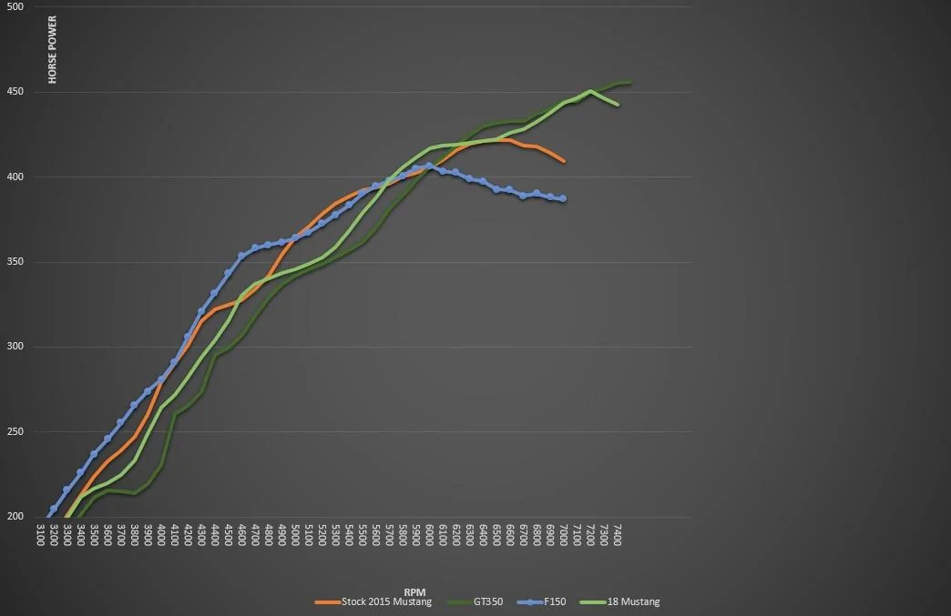

Dyno comparison of manifolds. If you looking at mid-range torque, I don't think the '18 is gonna do anything for you. Looking at the dyno, the F-150 manifold sweet spot is clearly that 4-5k RPM range. It's the best in the biz at that RPM range. However, the stocker ain't that bad, and it's certainly better than the other two (18 or GT350).
The problem is, you've already invested in a centrifugal SC. The F-150 manifold is tapping out and robbing you of RPM that your SC thrives in. The 18 is a poor mans GT-350...does everything the GT-350 does a little better, except above that 71-7200 RPM range. But in the range you want, the 18 (and the GT-350) come up short. There is that yucky dip in the torque curve 44-4800 where the 18 just barely eclipses the stocker, but above that the stocker comes roaring back and the 18 dips.
The dip in torque between the stocker 'soft spot' and the 18 'soft spot' is alarming. The stock manifold maybe doesn't quite have the high end lungs of the 18, but its torque curve is far more usable. Unfortunately your stuck between a rock and a hard-place. No other manifold is going to do you better than the stock 15-17.
