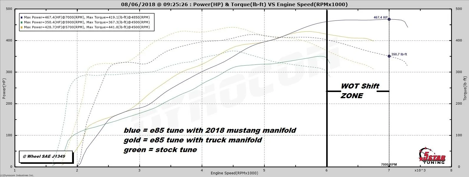

The 2015-2017 F150 manifold will give you more impressive torque numbers and the 2018 F150 manifold’s numbers will be even more impressive. Even though, it’s not going to overcome the 2018 GT manifold’s top end. The 2018 F150 manifold would give you a very fun stoplight to stoplight warrior though. Graph is from a 2018 F150.
I call BS on the stock pull. That tuner is trying to make it seem like their tune is greater than it actually is. My 2016 put down 380whp and the 2018s are around 415whp stock.
But I digress - forget the F150 manifold. Just downshift.
I think you mite have missed the part I said it was a dyno of a 2018 F150. Stock tune maximizes torque/fuel economy and not horsepower. I provided it simply so you could see the difference between the 18 F150 manifold and 18 GT manifold.
Pretty sure the trucks have a different set of cams in them as well for the 18+ model years that emphasizes low end torque production.
Correct. Truck manifold and cams for truck things (towing, hauling).
