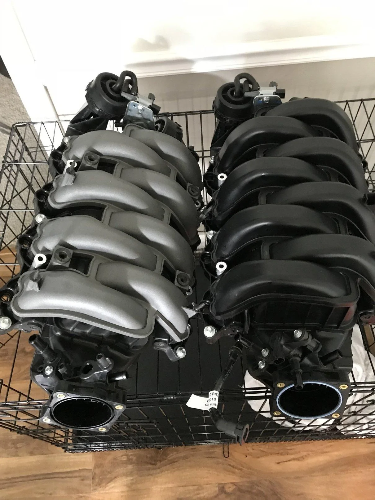

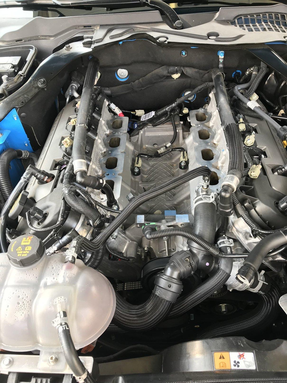

Taking a break from the humidity in the garage but installing my intake manifold right now. Will post pictures when I’m done.

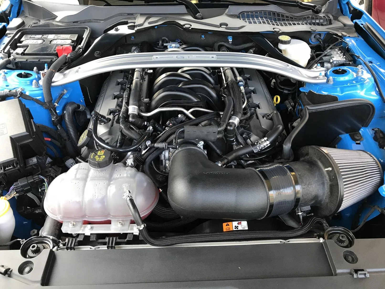

Install was straight forward. Took about an hour start to finish. After the install I reflashed my Lund Flex tune. There is a definite increase in low end grunt, response and no issue pulling to 7000 rpm. So far so good!! Once my tune settles down it should run even better. I can already tell that this intake is perfect for a Street driven GT.

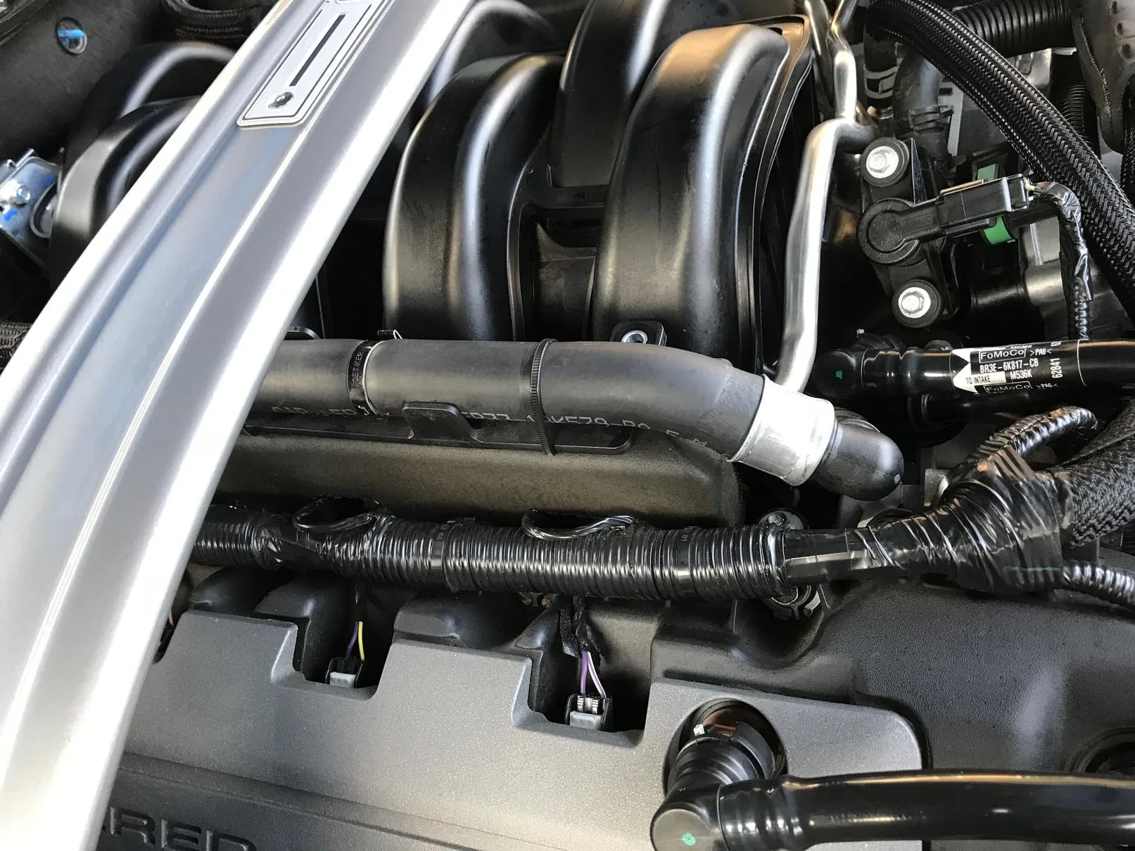

I’m gonna work on that but I think the strut tower bar is going to give me clearance issues. The truck intake is a lot taller.
Nice dude! Now figure out how to get your engine cover back on

I honestly couldnt have asked for an easier install.
I'm envious of how the F-150 manifold pretty much bolts on and looks clean compared to the 2018.

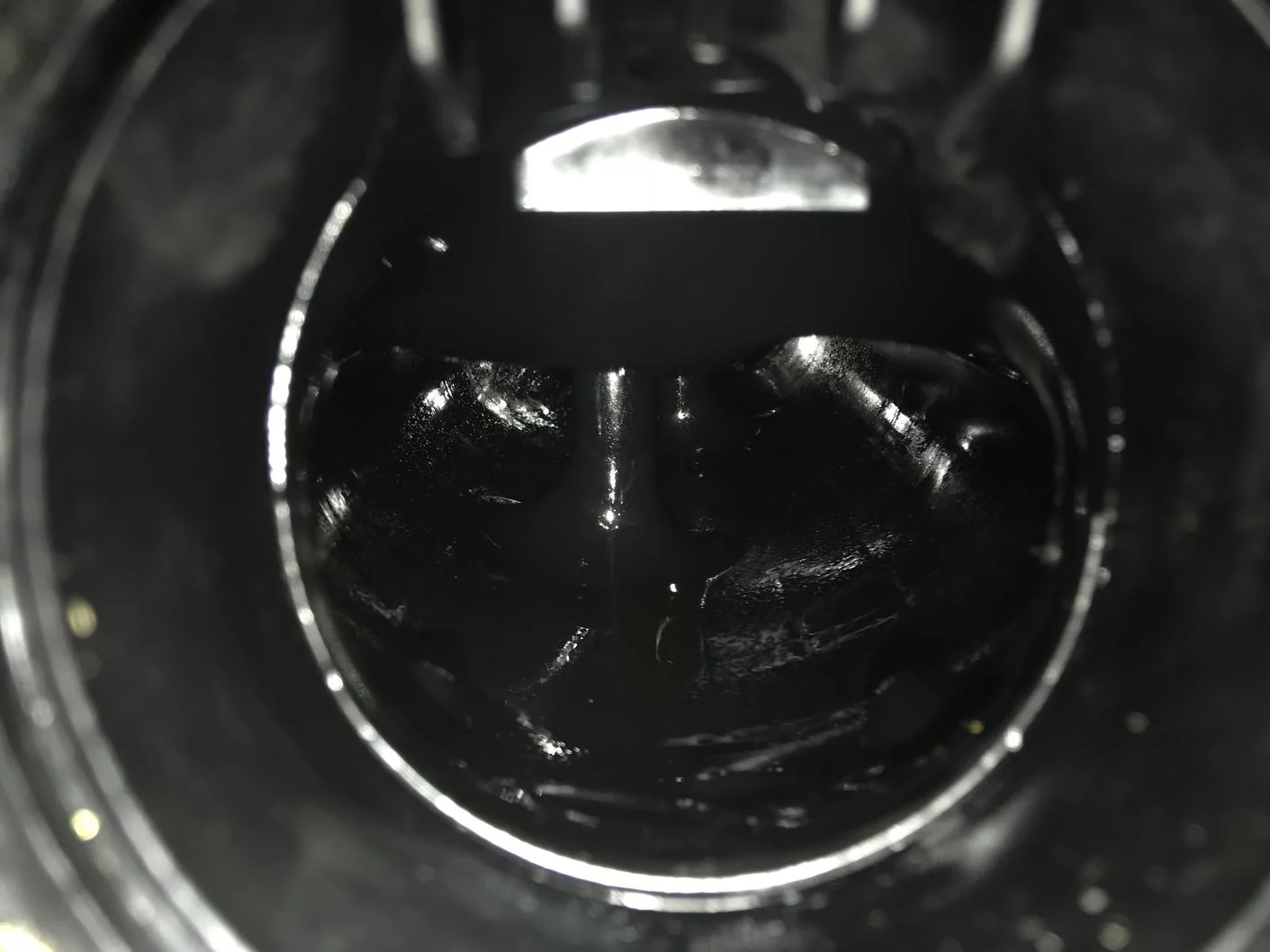

My GT only has 3,000 miles on it. This is a picture of the inside of my stock intake. Needless to say, I need a catch can.
