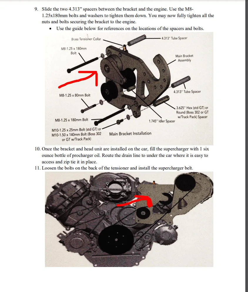

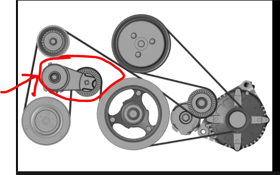

I know this is probably a stupid question but for the idler pulley would this be the sc idler pulley or the motor idler pulley? Or does only one of them have one? Just trying to get informed.
JetGray_Mach1
Jun 29, 2021
2,241
3,895
Southern California
Martin
2022 Mach 1 (HP)
There should be 2 if I am not mistaken.
This install instructions from american muscle should help.
https://lib.americanmuscle.com/files/80811-cust.pdf
There should be one left side of engine and one on the right side on the supercharger side.
Stock tensioner should be here.
Hope this helps. I would use a stethoscope or similar to really dial down which one is making noise before pulling apart.
