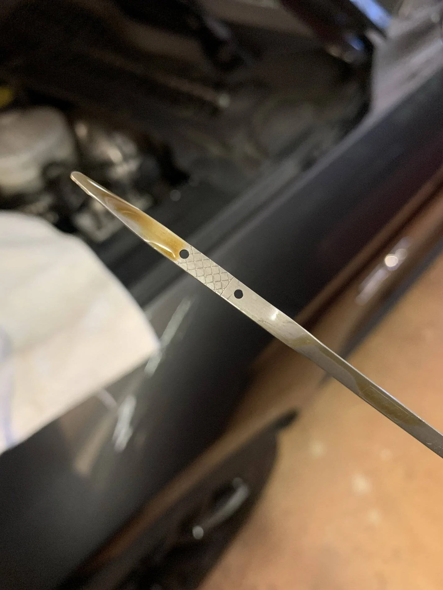

It might tell me though if the oil the dealer put in matches what the paperwork says. I took this photo of the dip stick about 10 days before the oil change. Didn’t do more than about 300 miles of driving after I took this photo.
That's low but wouldn't be enough to cause damage unless you're whipping it around a track. And what lab did you send it in? The ones I'm aware of from BITOG can only give a rough idea of viscosity. Honestly, it's incredibly unlikely they used anything less viscous fhan 5w20. But I guess we'll see. I just think it's unlikely the sound is related to your engine unless it's a pulley or serpentine belt. This is reinforced by you saying it's only under load and accelerating. Even if the load is ligher in neutral, you'd still hear whine. Unless you do and I missed it.
