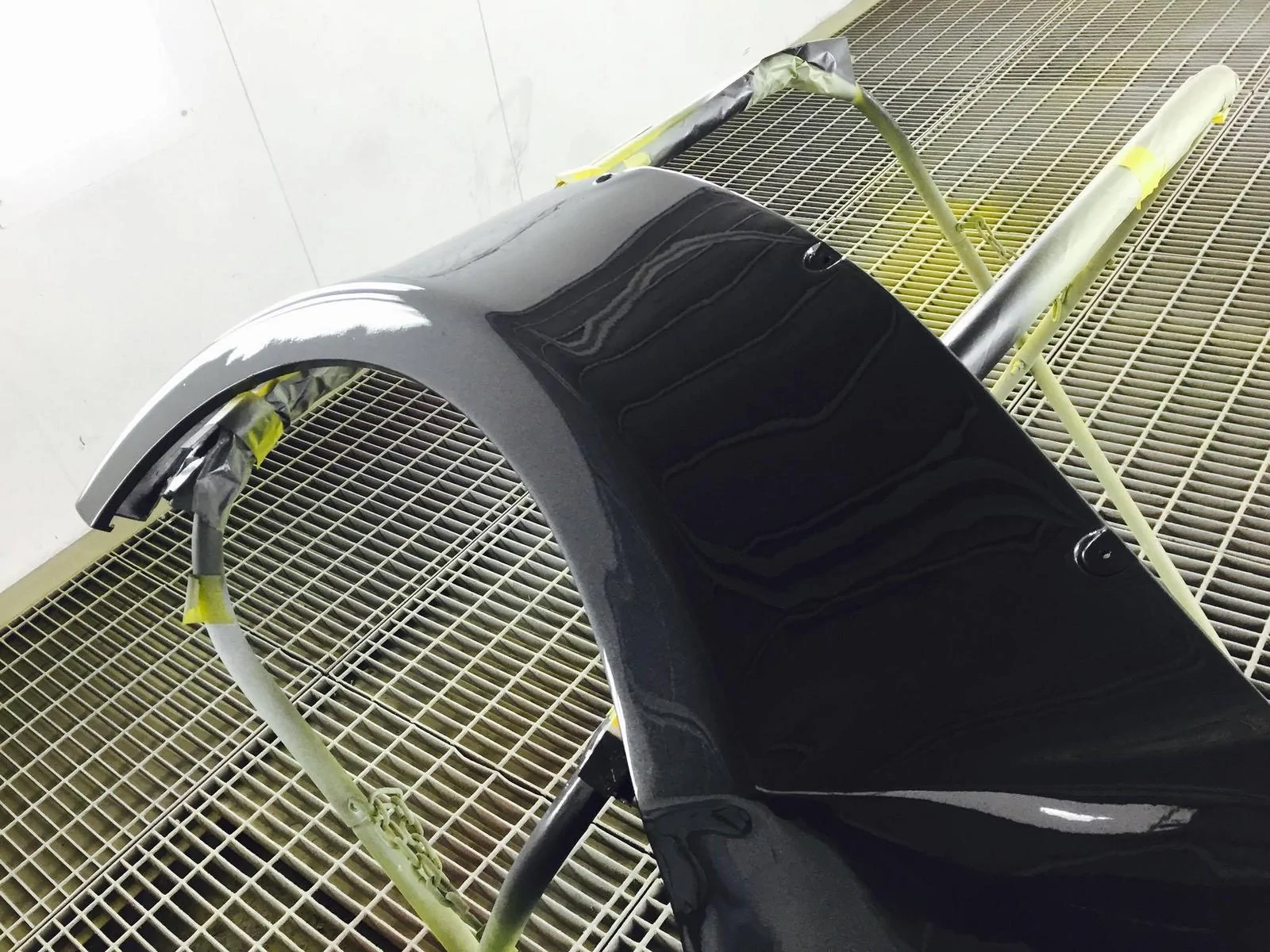

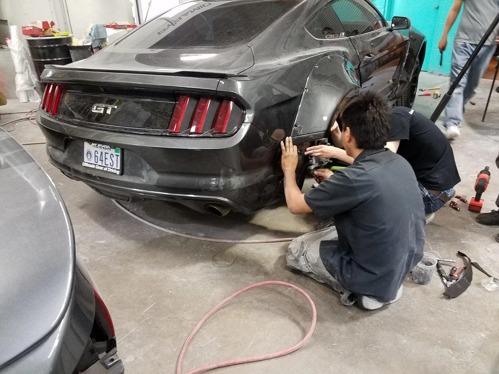

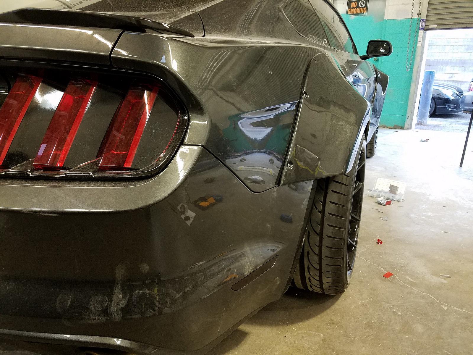

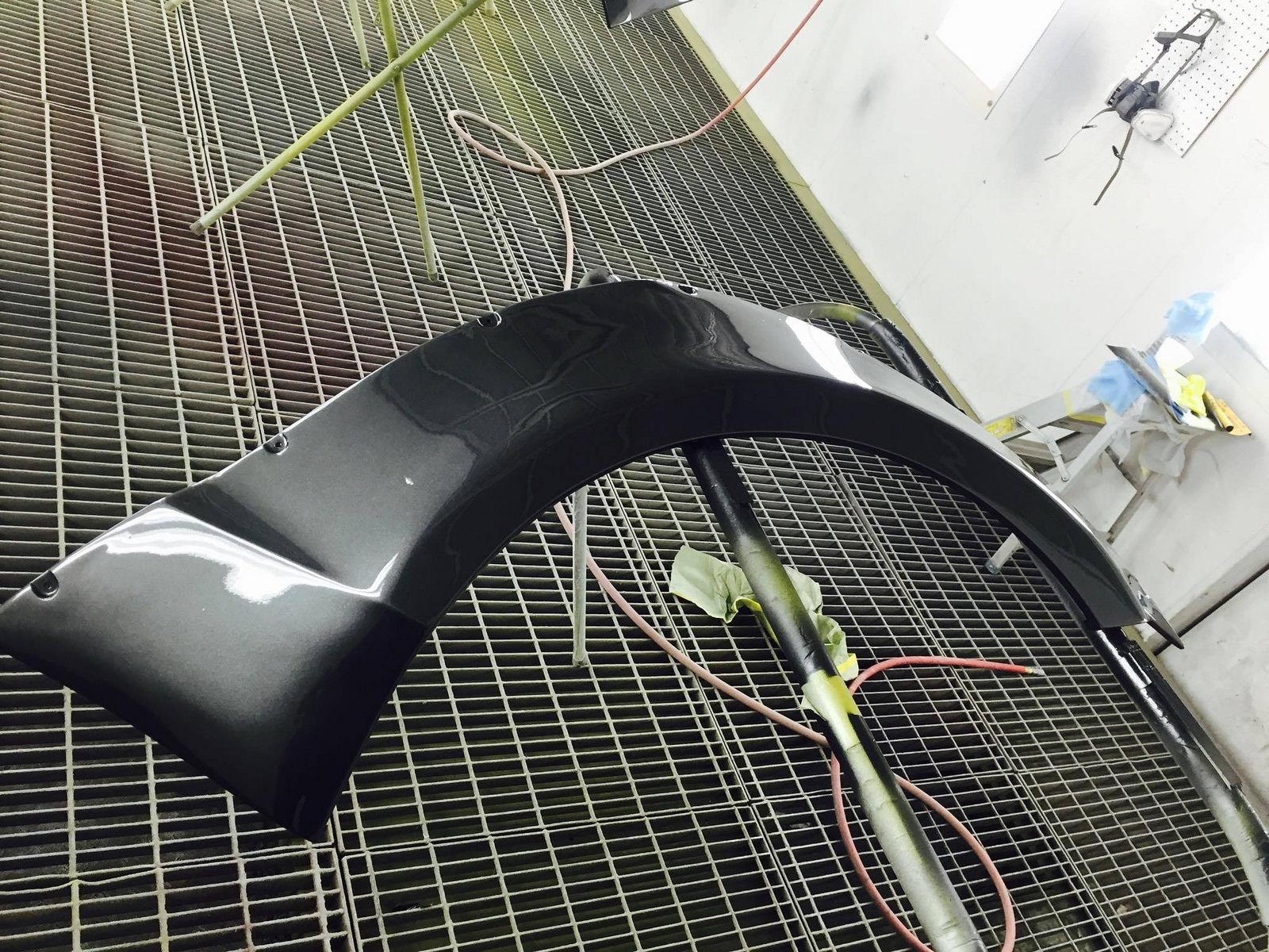

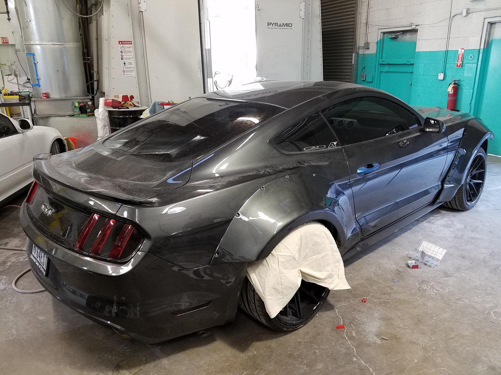

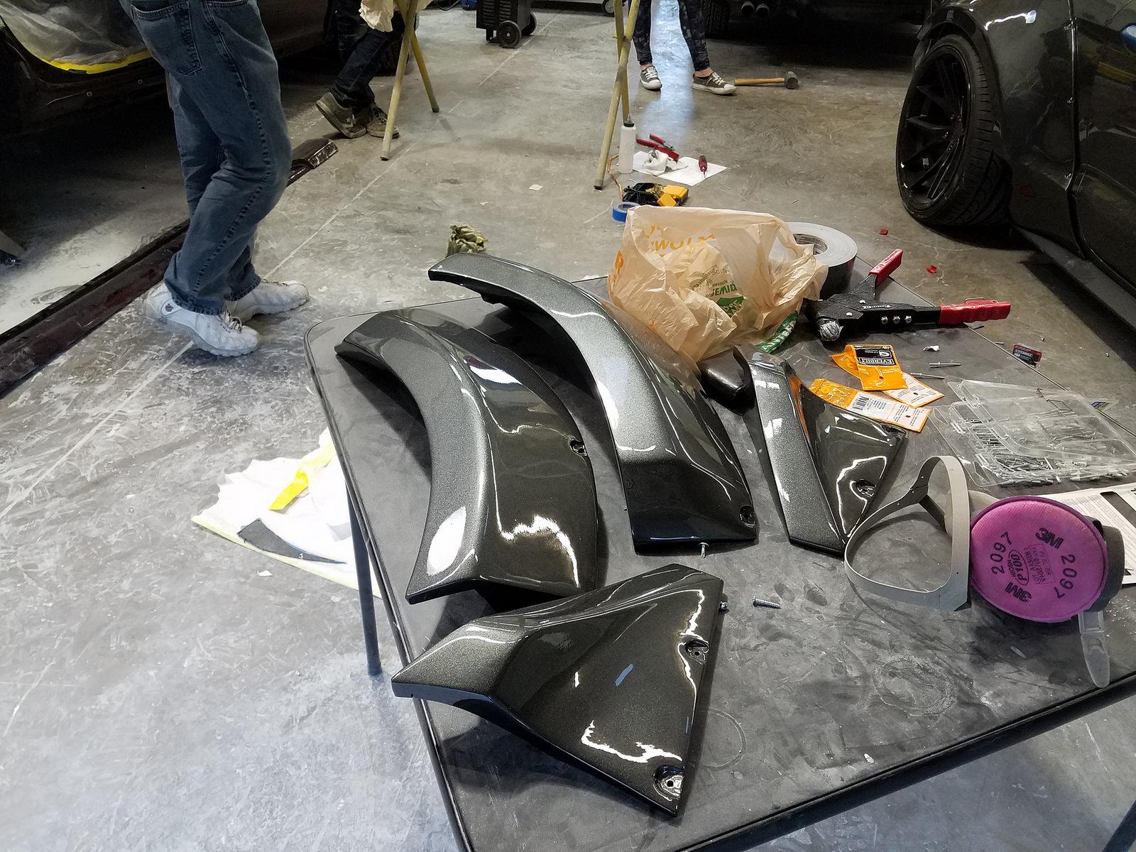

Haha I know! Sorry guys, the car wasn't done yet because after they prepped it for paint they found tiny pin holes in the material that would show up in the paint/clear. Also, the material has some air pockets in it around the rivet sections so they had to fill those, and figure out a way to mount with less pressure in the rivet zone.
Will be done today though, once it is I will be posting photos I promise.

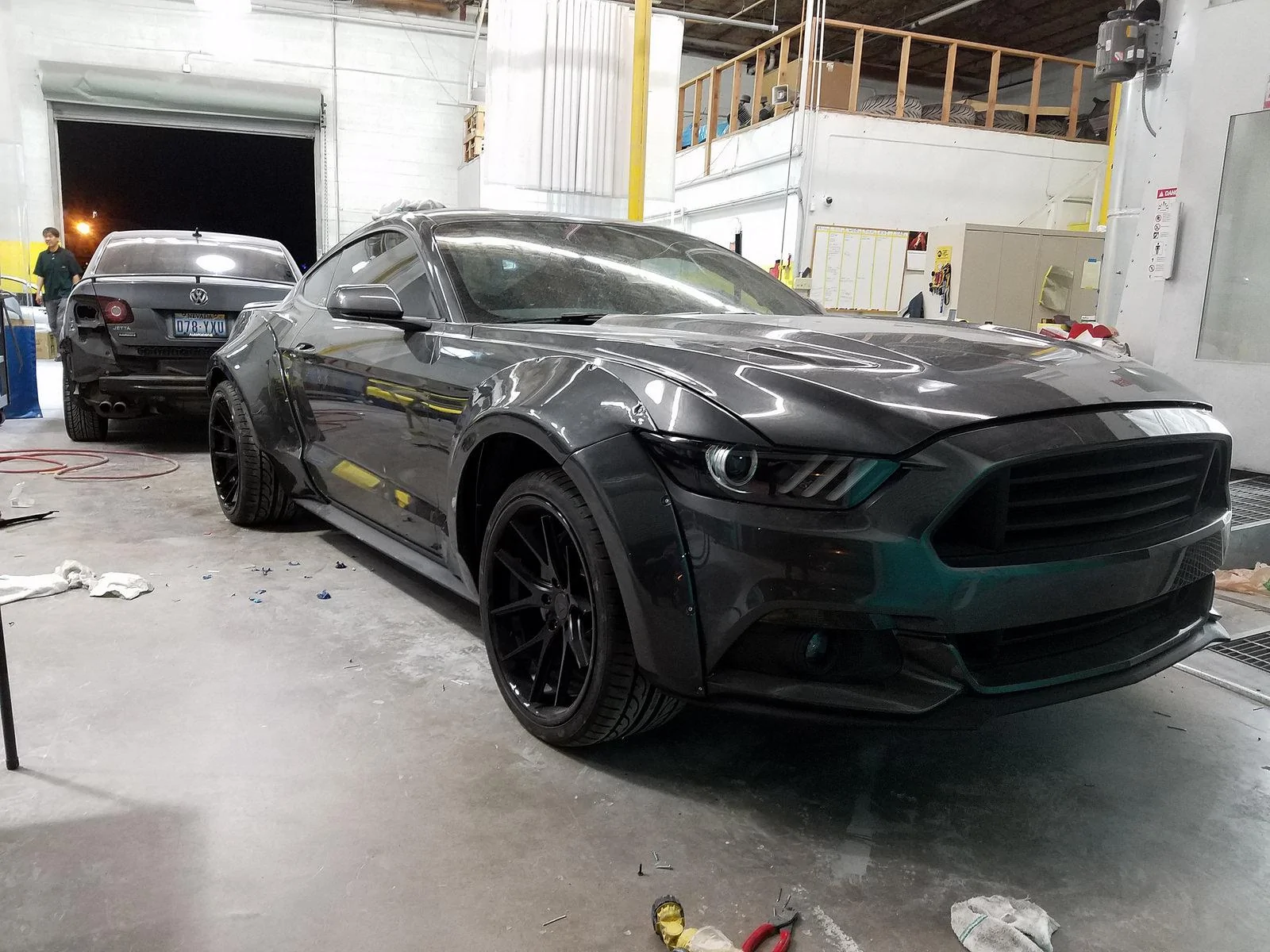

I know, I know... I am late haha
Here they are!

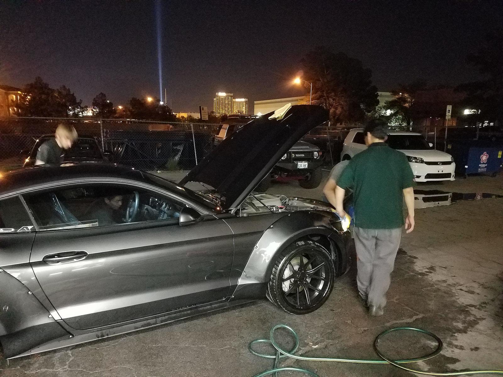

Let the cleaning begin...
20160510_225109 by Dylon, on Flickr
20160510_225844 by Dylon, on Flickr
20160510_225850 by Dylon, on Flickr
All clean

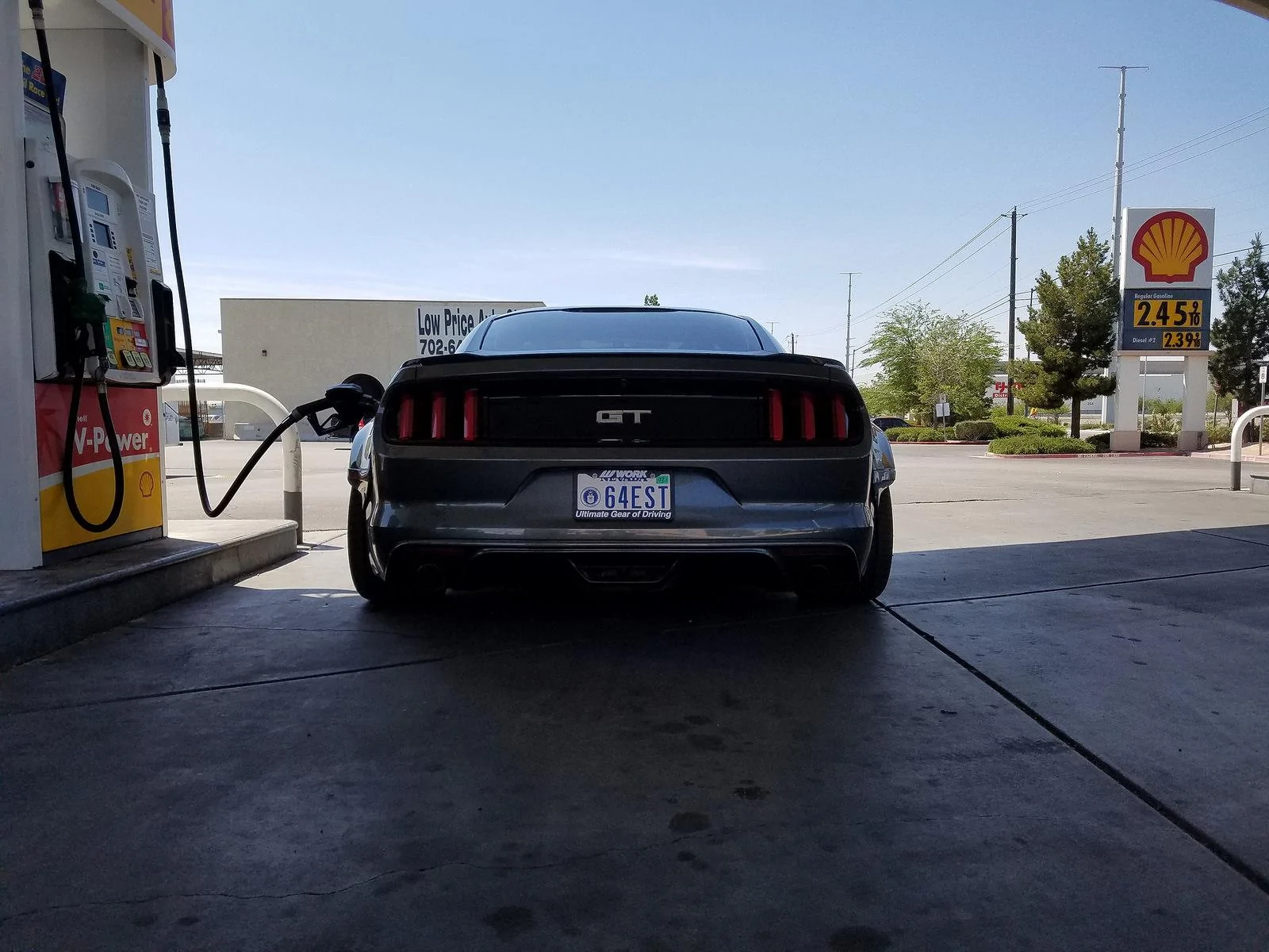

Daytime shots. She was thursty.

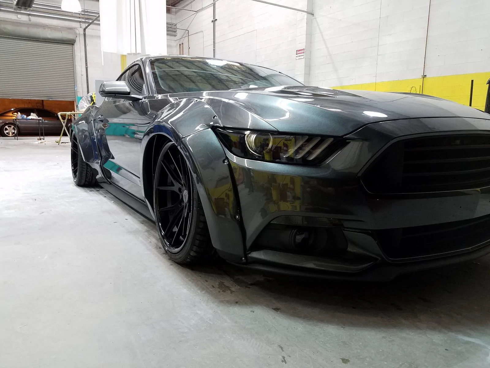

For all of those considering doing a widebody mustang, I hope this thread has shed some light on what all is involved after the money for the kit is spent. As you can see, there is a lot more to it than just buying a ~$2k kit
For proper fitting wheels, without the need for spacers, here is a little information to help get you started.
My wheels are 20x10.5 +15 front and 20x11.5 +15 rear.
Fronts are wrapped in 285/30 and rears are 305/25
With my spacers the front offset will soon be -10 and the rear is currently -23 (25mm spacer front | 38mm rear)
The rear is perfect right now. I can almost air all the way out with the bag/coil at the lowest possible setting and no rubbing. I would say the max I would do on this setup is -25 offset to allow for max low when dumped.
Feel free to ask any other questions about the kit and I will be 100% honest with you.

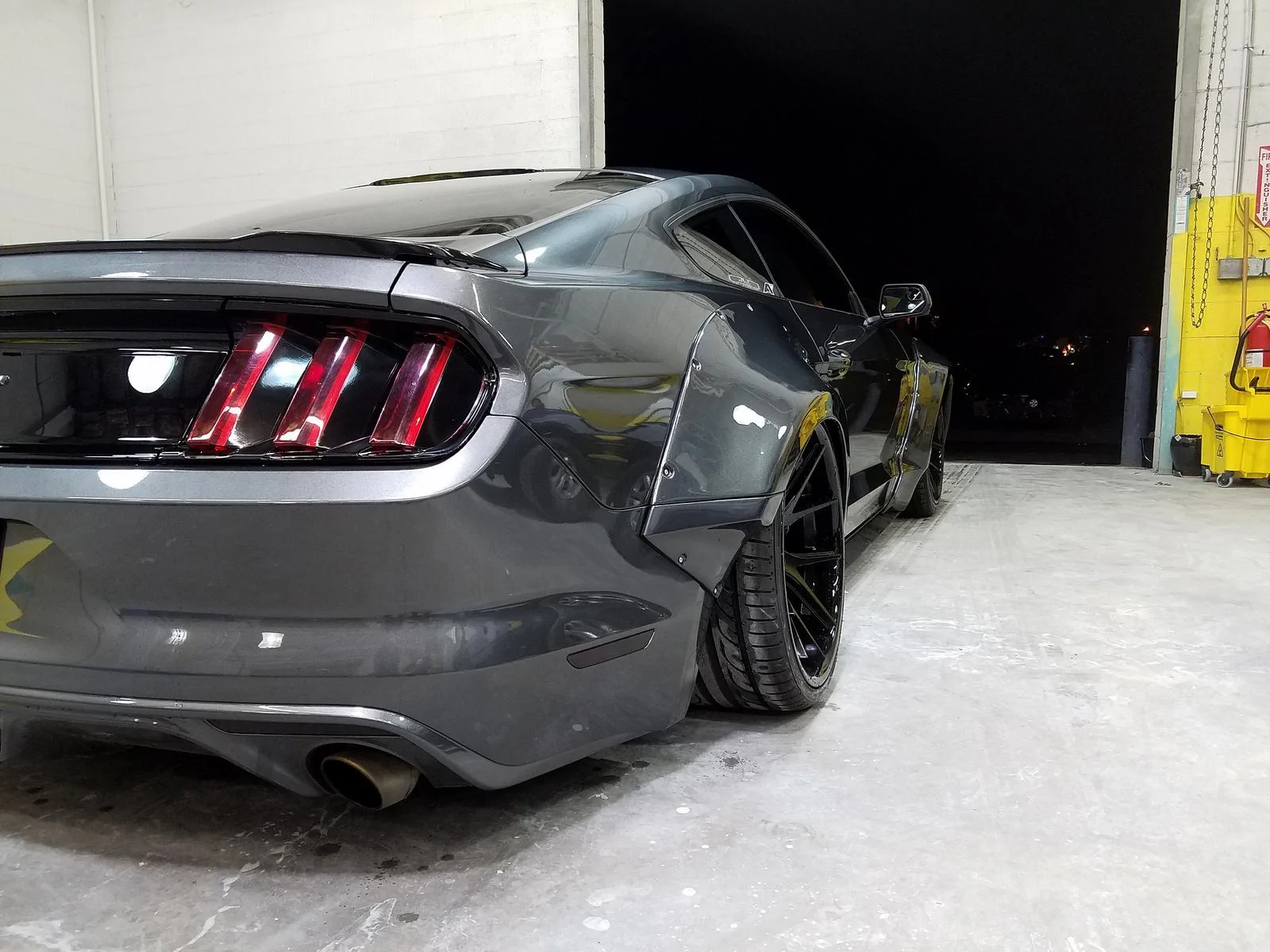

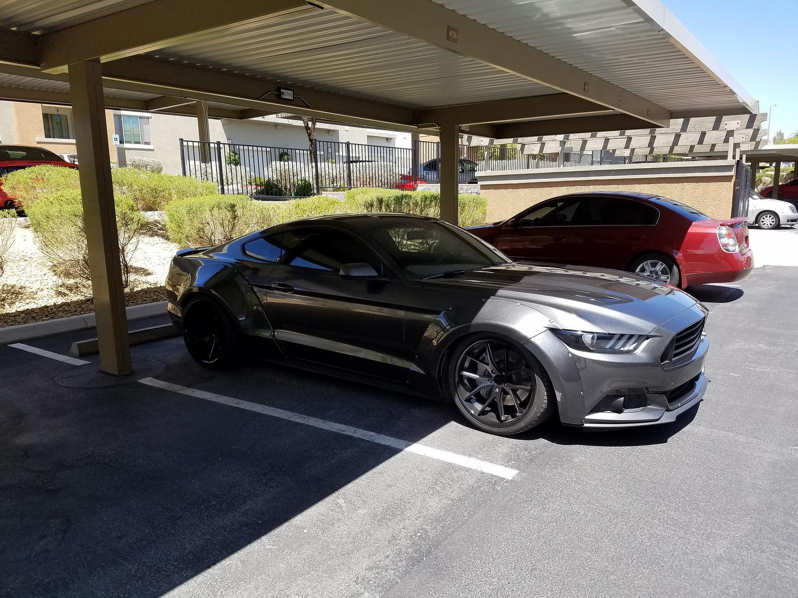

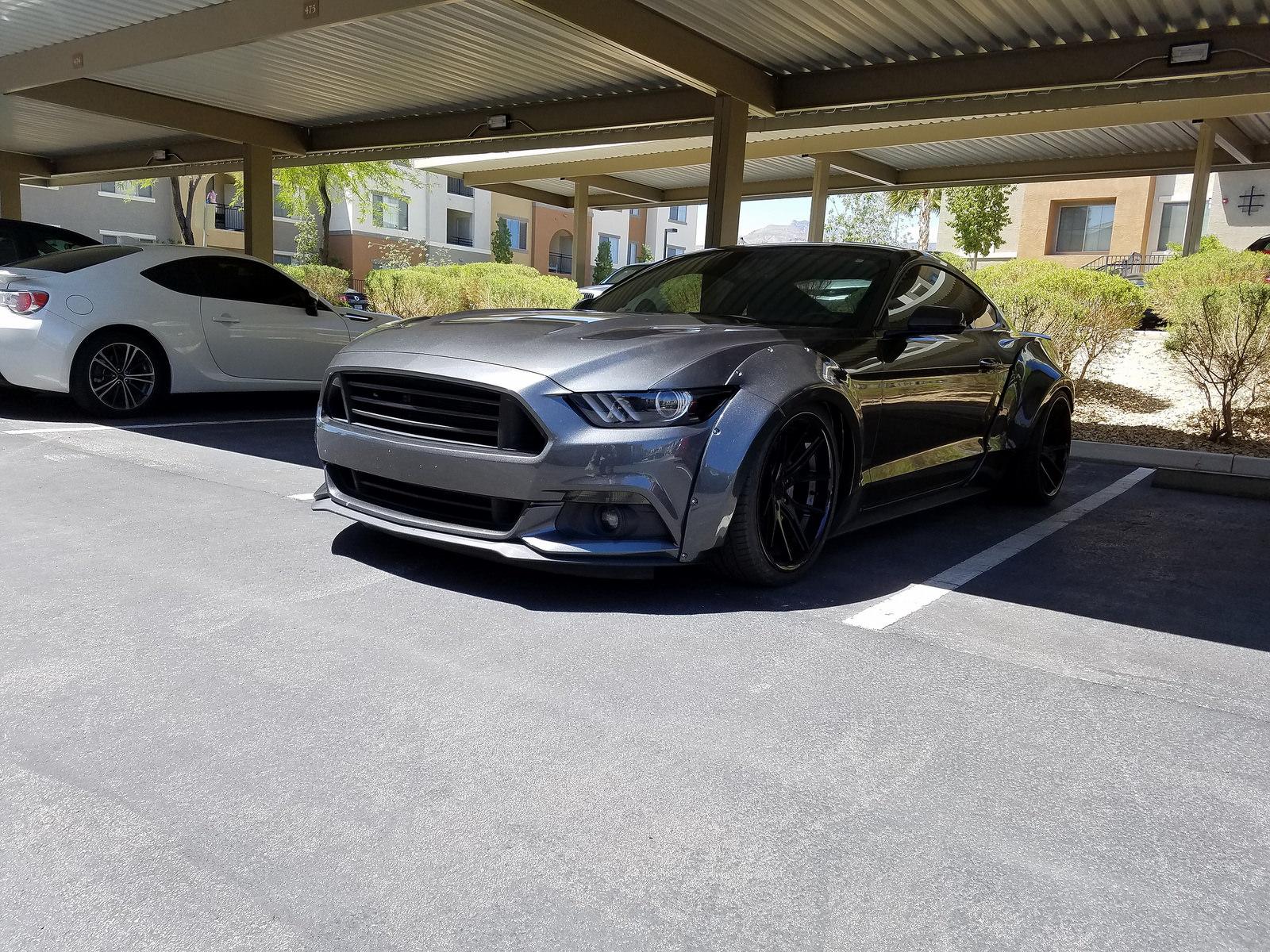

Man, honest opinion. Doesn't look good. And I'm a fan of the LW, RWB, Rocket Bunny kits out there. The front flares are just giant bubbles that don't match any of the cars lines. The rear isn't that much better. And like Khyber said, the stock bumper doesn't look "mean" enough.
But I can appreciate the work that went into making that kit fit. It doesn't look like it lined up too well originally. And I can appreciate trying to "go big". But it's your car, and if you're happy, that's all that matters. :thumbsup:
SK GT
Oct 30, 2014
822
187
Houston
2015 GT(sold), 17 1LE
The back portion of the front ones looks awful from a fitment standpoint like its not even flush against the car. Same with the rear section that's on the back bumper itself behind the tires. Just what my eyes see from these pictures. The rivets need to be body color imo. Appreciate the work that went into it though.

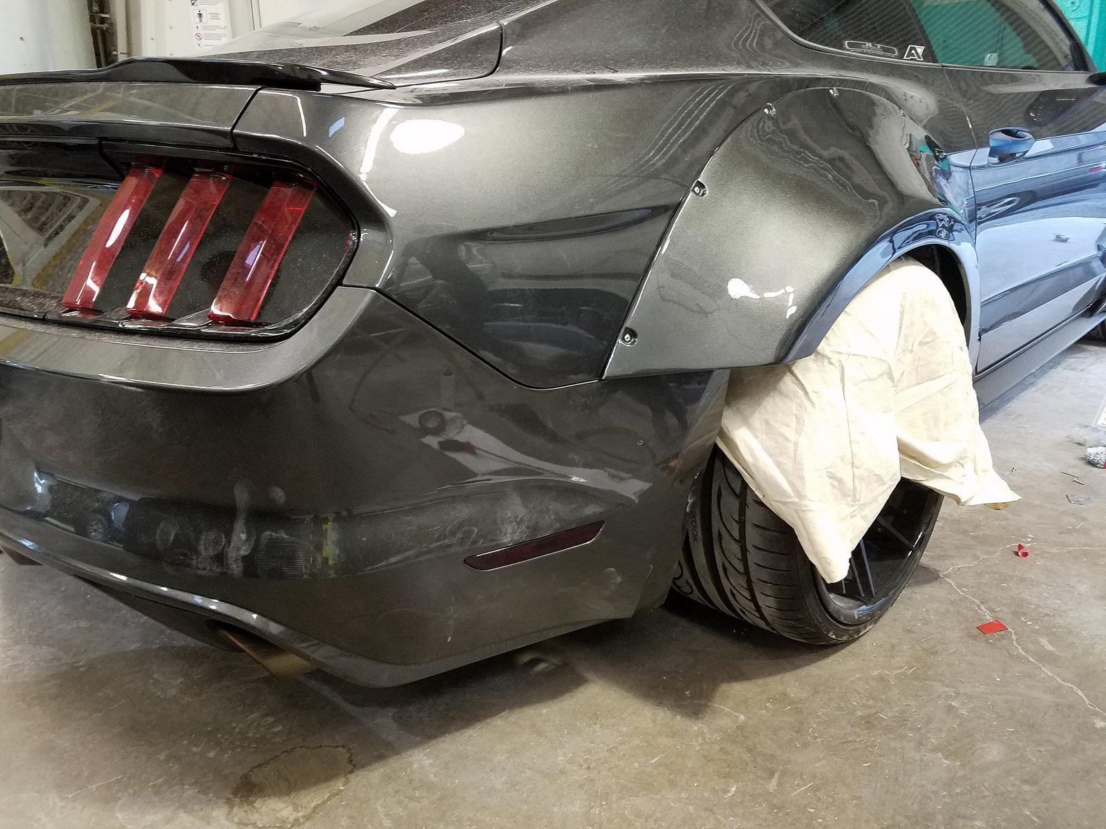

While I am not a big fan of the riveted look, I do have to say that kit does look pretty cool. The rear flares seem to end a little to abruptly on the rear bumper, but overall a unique look as been achieved. Well done.
