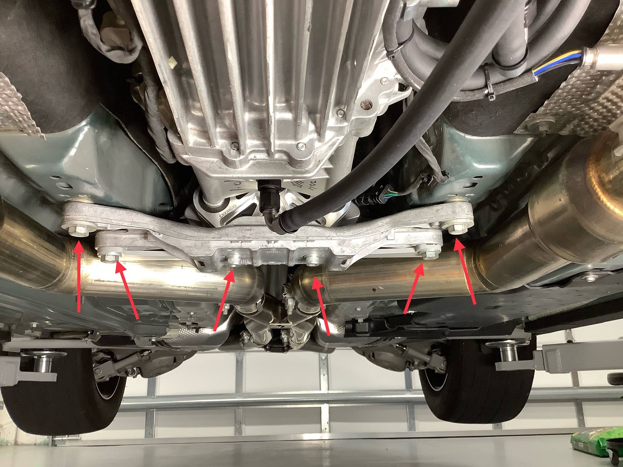

I used a scissor jack with a tree jack stand on top of it and a phonebook placed between the tree jack stand and the transmission to lift my engine for the header/motor mount installation.
I can't get the engine to raise up without the whole car raising. What do I need to unbolt... thx!
Sorry... to change the motor mounts. What am I not seeing.

When I installed my motor mounts, I had the motor mount brackets off because I was installing headers at the same time.
You might still be able to remove them with the factory motor mount brackets in place though. Did you remove the nut on the studs at the top of both factory motor mounts and the transmission crossmember? That should do it
I didn't mess with the transmission. I just unbolted both front mounts and tried to jack it up. Thank you!
Here’s a pic here to show which bolts will need to come out.
Makes sense. I was only using a small jack so I couldn't get under to see the transmission crossmember. I really appreciate it. It's my ex wife's car and I still keep it running for her. Thank you!
