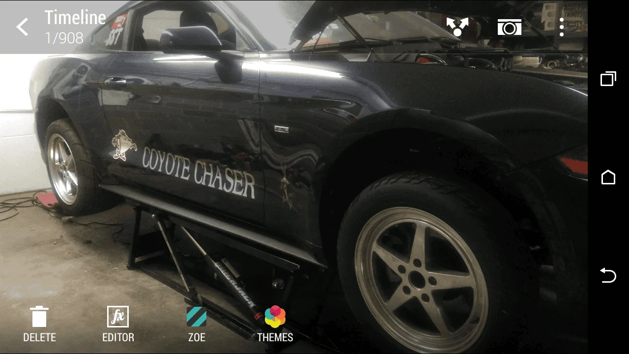

I use the pinch welds only, weather I'm using my scissor lift or Jacks. I place the jackstands under the car, wherever I'm working for my safety, not to support the car.
I also want to use stands for safety whenever I'm under the car but I want to put the weight of the car on the stands and take the weight off the scissor jack. I can't figure out any way to fit both a jack & jack stand under the pinch welds. Wish I had a lift like yours but I'm just a peasant.

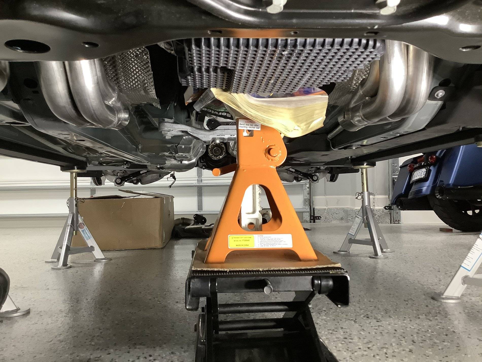

I used a scissor jack with a tree jack stand on top of it and a phonebook placed between the tree jack stand and the transmission to lift my engine for the header/motor mount installation.
Wow! that's quite a contraption. I have a hydraulic scissor jack that I think I can place under the bell housing if that's the best place to lift. I'll have to make a platform out of some 2x4s to support the scissor jack though.
