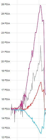

Folks, I decided to add another tap after the resonator just to ensure the true 3" part of the system (mid-pipes and mufflers) is sufficient. I relocated the passenger's side pre-cat pressure to just behind the resonator.
This is where it gets weird.
All taps are driver's side now:
Purple - just before the driver's side cat
Gray - just after the driver's side cat, but before the s-bend
Red - just before the resonator
Blue - just after the resonator
At first I thought it was a fluke or perhaps some wiring faulted, causing the signal to reverse. However, I repeated the measurement several times, and even moved the tap to verify it was still reading positive when it should. The readings are valid.

I went back and applied a velocity head correction to all of my numbers, then summarized below with the backpressure added by each component:
Cat converters - 3.0 psi (average of 7 data points)
S-bend between cat and resonator (with 2.25" bottleneck removed) - 2.8 psi (average of 5 data points)
Magnaflow "3 inch" resonator - 6.0 psi (average of 4 data points)
Magnaflow 3" resonator-back piping + mufflers - <0.5 psi (3 data points)
Every 5 psi is about 15 hp loss just due to pumping, plus tech papers suggest you can add about 1 deg of timing for every 5 psi backpressure reduction.
