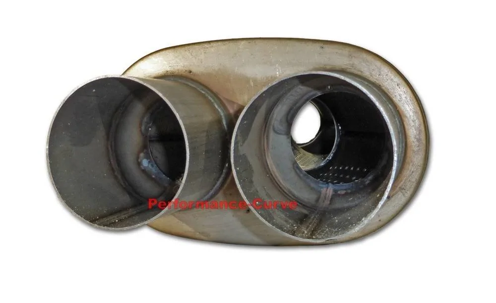

Would something like this work for you? Its 3" with an internal x-pipe but it maintains the 3" diameter all the way through. I run one on my car.
https://www.summitracing.com/parts/jex-mf2469/overview - note the pic Summit uses is a generic picture, it actually looks like this:
https://www.summitracing.com/parts/jex-mf2468?rrec=true

https://www.stainlessbros.com/3-dualdual-ss304-thin-oval-muffler-17-oal--polished.html
Might not exactly match the S550 110mm exh. Center to Center dimension but at this point any Fab guy worth their salt can make this new Stainless Bros. dual in/out fit.
Are you certain it's 3" all the way through? Every one I've seen so far necks down either just inside or just outside of the casing, including FlowMonster, Borla, and Magnaflow.
As far as fitment goes, if I do anything with this, it's going to involve going 3" all the way to the cats which will require quite a bit of fitting anyway, so the center-center won't matter much.

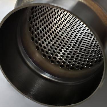

I think Stainless Bros. recently added this dual in/out to their product line.
Knowing Stainless Bros. I’ll wager it’s 2.875” ID (3.0” OD) perforated tube.
These guys build and supply top notch parts.
Here’s their 3.0” bottle resonator end connection. I’d don’t see why they wouldn’t use the same connection style on the dual in/out.
