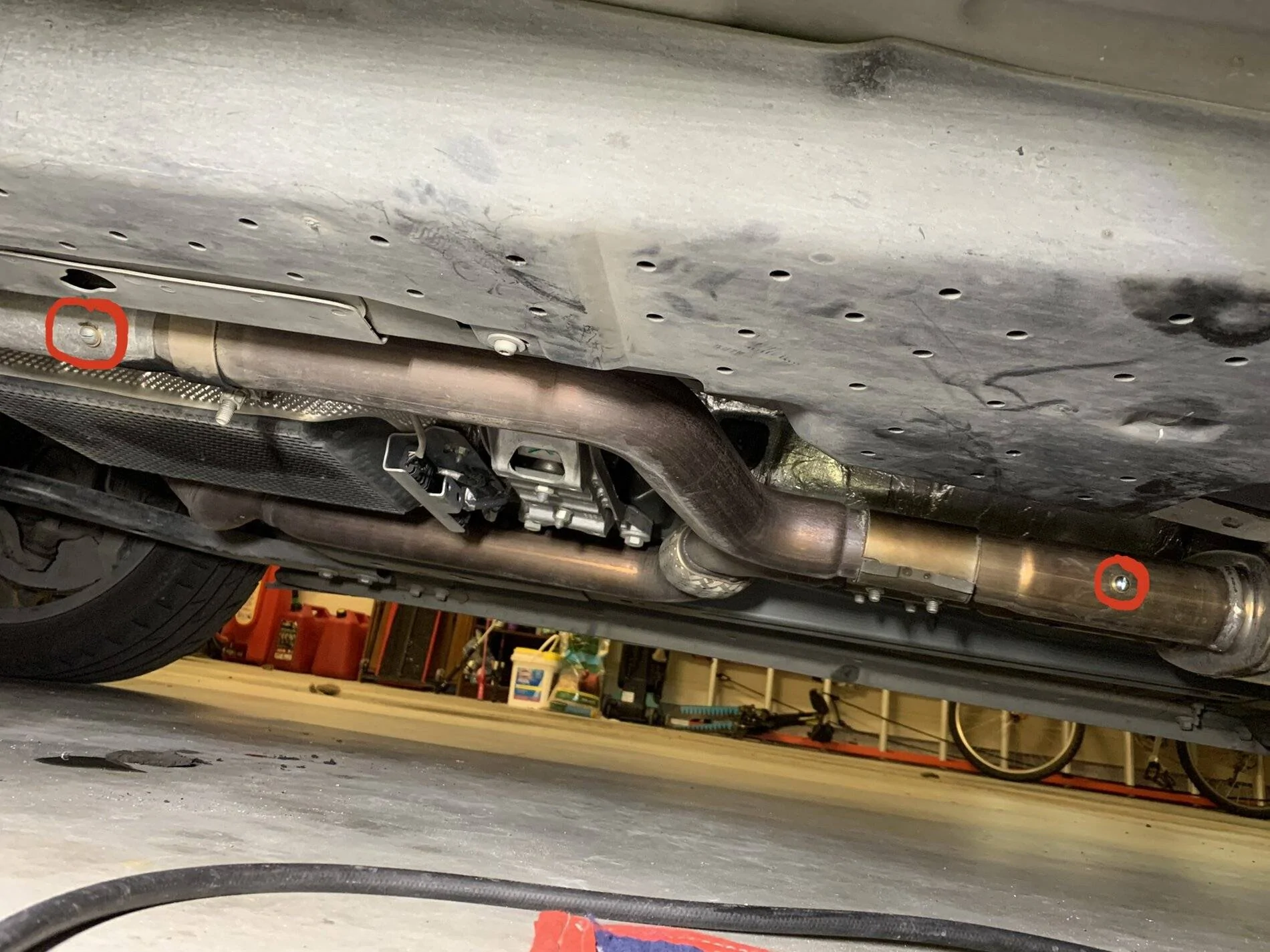

Post-cat and pre-resonator pressure taps.
Hard to believe there’s 5 psi difference between these two locations.

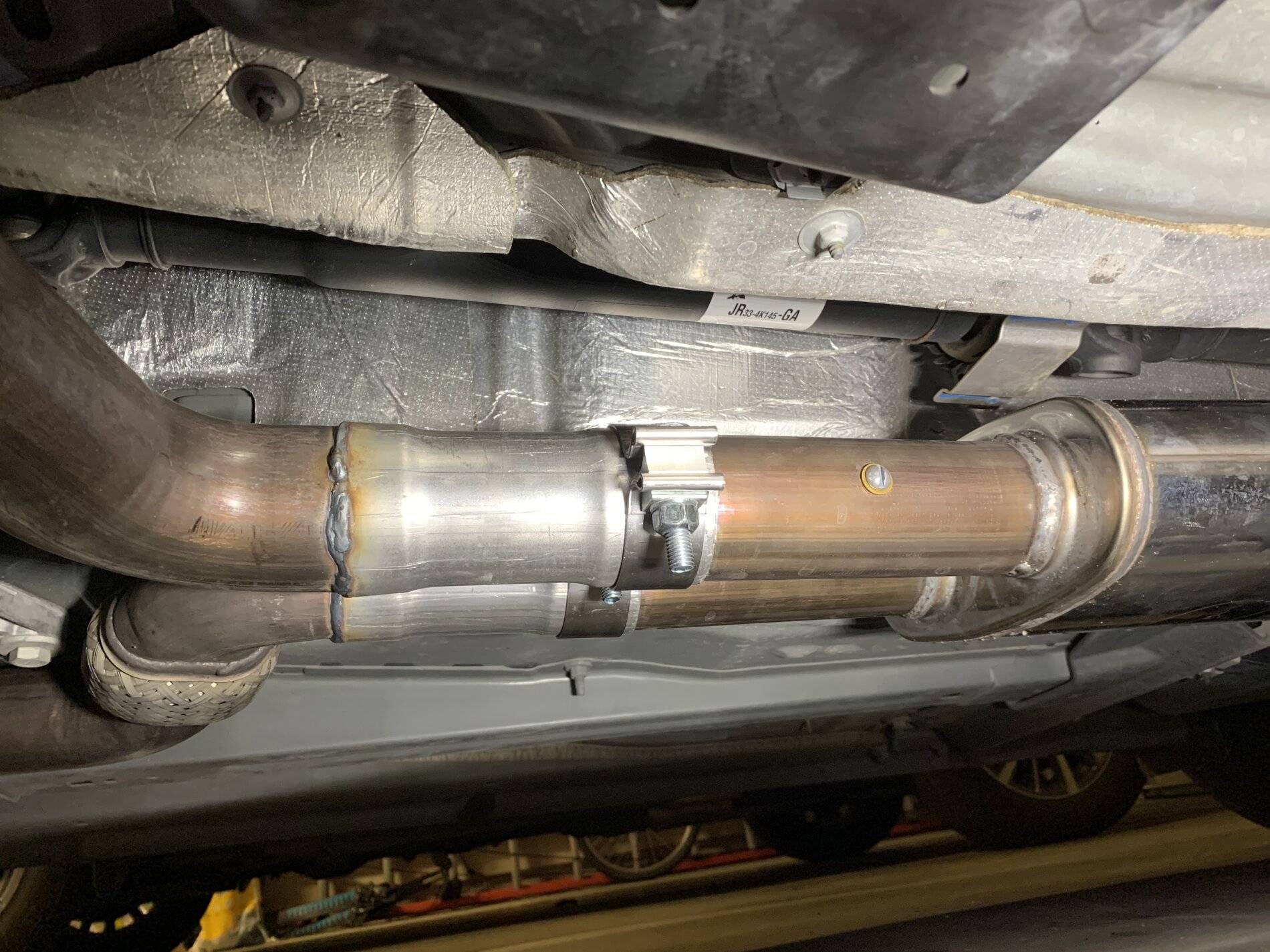

I deleted the 2.25” factory connection and replaced it with 2.5”. That dropped the post-cat pressure from 6.5 down to about 4.5 psi. Upstream of the cat measured 9-10 now, down from 11 with just the cat-back upgraded.
So the net reduction vs stock with the magnaflow street series cat back and factory-connect delete was from 15 to 9-10 psi.
Based on what I’ve done and measured, I don’t think it’s possible to get below 7-8 psi with factory cats even with a complete 3” system all the way to the cats. The cat dP started at only 2 psi but as I reduced downstream pressure the cat dP increased to 5 psi.

Nice. So deleting the neck down made a big difference you would say? Any pics of you did it? Wonder if there’s any real measurable performance gains. Thoughts?
engineermike
Jul 15, 2018
6,302
6,630
La
2018 GTPP A10
Not exactly what I had in mind but it works and is sturdy. A drop of 2 psi from the factory connect delete isn’t a ton but should allow a tiny bit more spark, like 1/3-1/2 deg. That could be worth 10 hp. Difference in pumping losses from 2 psi will only be in the 5 hp range. With a centrif or turbo the gains will be greater.

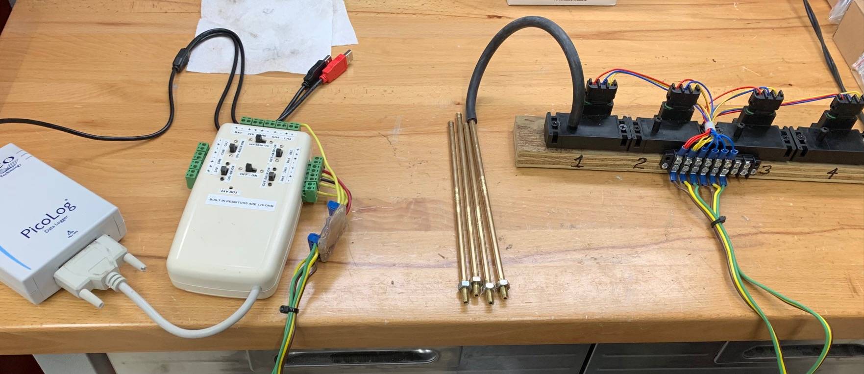

So I sorta got carried away wanting better data than just a peak-hold value from a gauge. It doesn't help any that I accidentally got an instrument engineer involved who egged me along. The following is a bank of four GM 3-bar MAP sensors, a power supply, and an A-D converter. The brass tubes are heat isolators to allow the use of rubber hose to get to the MAP sensor without degrading rapidly.

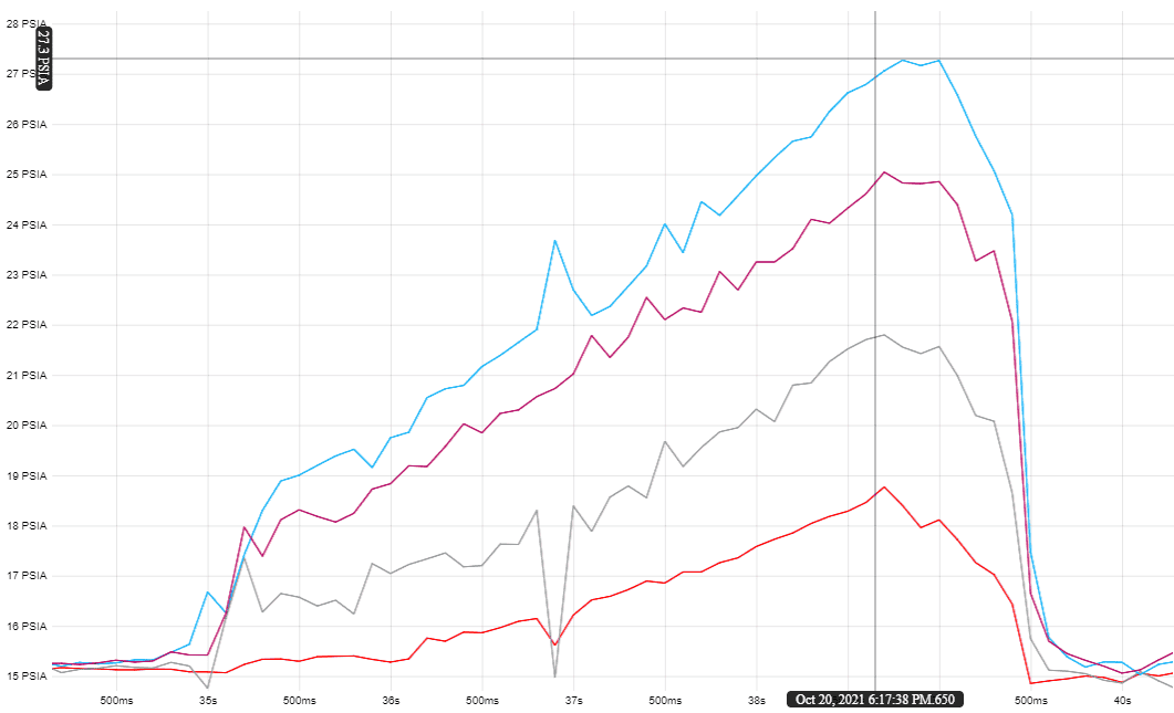

The 4 pressure locations are just ahead of both cats, just behind the driver's side cat, and just ahead of the resonator. Note that the values in the graph are psia.
Observations:
- Peak pressure was 12.6 psig ahead of the passenger's side cat.
- Delta across the DS cat was only 3.2 psi.
- Delta across the PS cat was about 5.5 psi, depending. I'm not sure how restrictive the flex joint is vs the cat. This cat is the older of the two, so it could be the cat.
- Delta from the downstream side of the cat to the upstream of the resonator was 3 psi. This is most surprising as the only thing between those two locations is 2.5" pipe and a pair of 45 deg mandrel bends.
- Delta imposed by the resonator and dual 3" cat back is 4 psi. I tend to think the lion's share of this is from the 2.5" MF resonator since the rest of the exhaust is dual 3" with straight through mufflers.
- I really wish I had this data set for the stock exhaust system.
