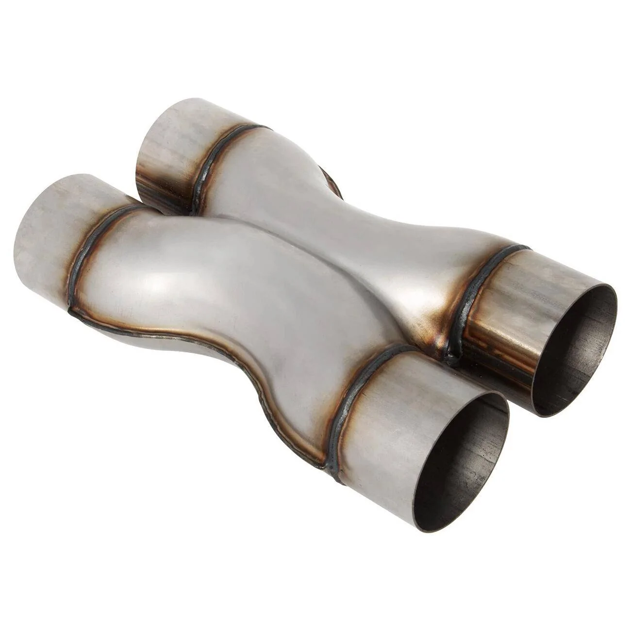

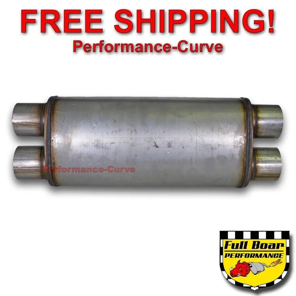

Hey guys, what would you all think about doing this? just wondering if there would be any benefit in flow or tone if i do this along with the resonated x pipe.
So im thinking of getting a true x pipe to connect at the top where the long tube headers meet and then add the jones maxflow x pipe right after it leading into the catback(exhaust will be 3 inch all the way through).
Is this worth doing as in would there be any benefit in flow or tone because theres a true x pipe before it goes into the resonator or should i just connect my long tube headers with only the resonated x pipe?
Im not boosted, just building a e85 fbo N/A semi track/street autocross car.
Hammerhead13579
Mar 12, 2018
179
125
Federal Way, WA
2019 Premium PP1 GT
Since you aren't boosted I say just go with whatever you think might sound good. If you got rid of the manifold/cat restriction and the OEM resonator restriction then everything else at 3" is sort of overkill. I don't think there will be much of a pressure difference or power difference so just focus on sound
I don't see the point, the muffler already has an "X" inside of it.
Was kind of thinking it might minimize the loss from the resonator since the setup would have an unresonated "x pass" before it and could sound different as well.
I dunno just throwing ideas out there, not the brightest when it comes to this car stuff:like:
