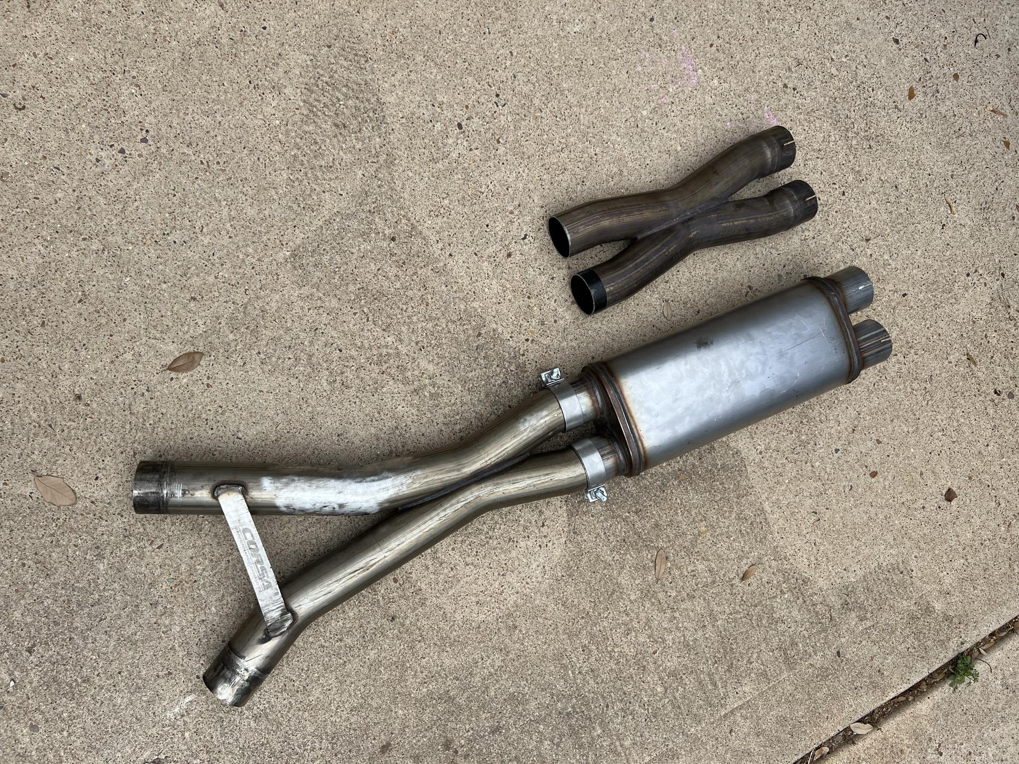

Thanks for this thread. I found myself in the 'it's too loud club' after installing headers. This jones muffler brought the sound back down to a good spot. Just a hair under what it was with the corsa extreme and stock headers.
The jones inlets and outlets slid over my existing 3" pipes just perfect. I cut slots in the ends of the jones inlets and outlets so I could install with band clamps.

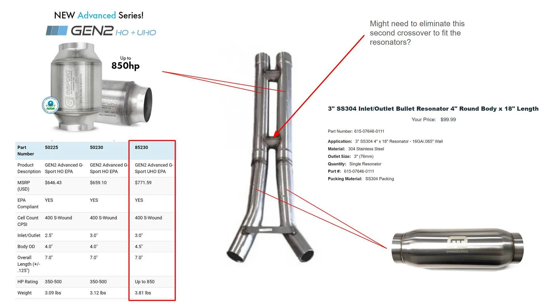

Hey y'all, thanks a ton for all the info shared in this thread (with a special thanks to @engineermike for all the testing and results sharing)!
I have an ESS G3 kit on the way for my 2016 GT and trying to plan out the exhaust components to go with the build.
My goal would be to:
  • keep the noise increase to a minimum (strict noise limits at the tracks in my region)
  • eliminate the stock cats (reading about clogged cats blowing up s/c engines has me a bit paranoid)
  • put in some aftermarket cats further downstream (as a bit of a compromise between cat longevity and efficiency?)
  • locate the cats downstream of a crossover point so if one cat dies first there's some "early warning" (vs instantly damaging the corresponding cylinder bank?)
Here's what I'm thinking of going with:
In terms of location of the cats & resonators, I'm thinking of getting a shop to weld them in like so:
Would this have a reasonable chance of achieving my goals? Any feedback/suggestions would be much appreciated!
That setup would work but me personally with boost if you don't need to have cats I wouldn't run them, the failure rate is just too high to chance. Also I see no need to spend about $650 on the double h pipe because you'll be cutting most of it up.

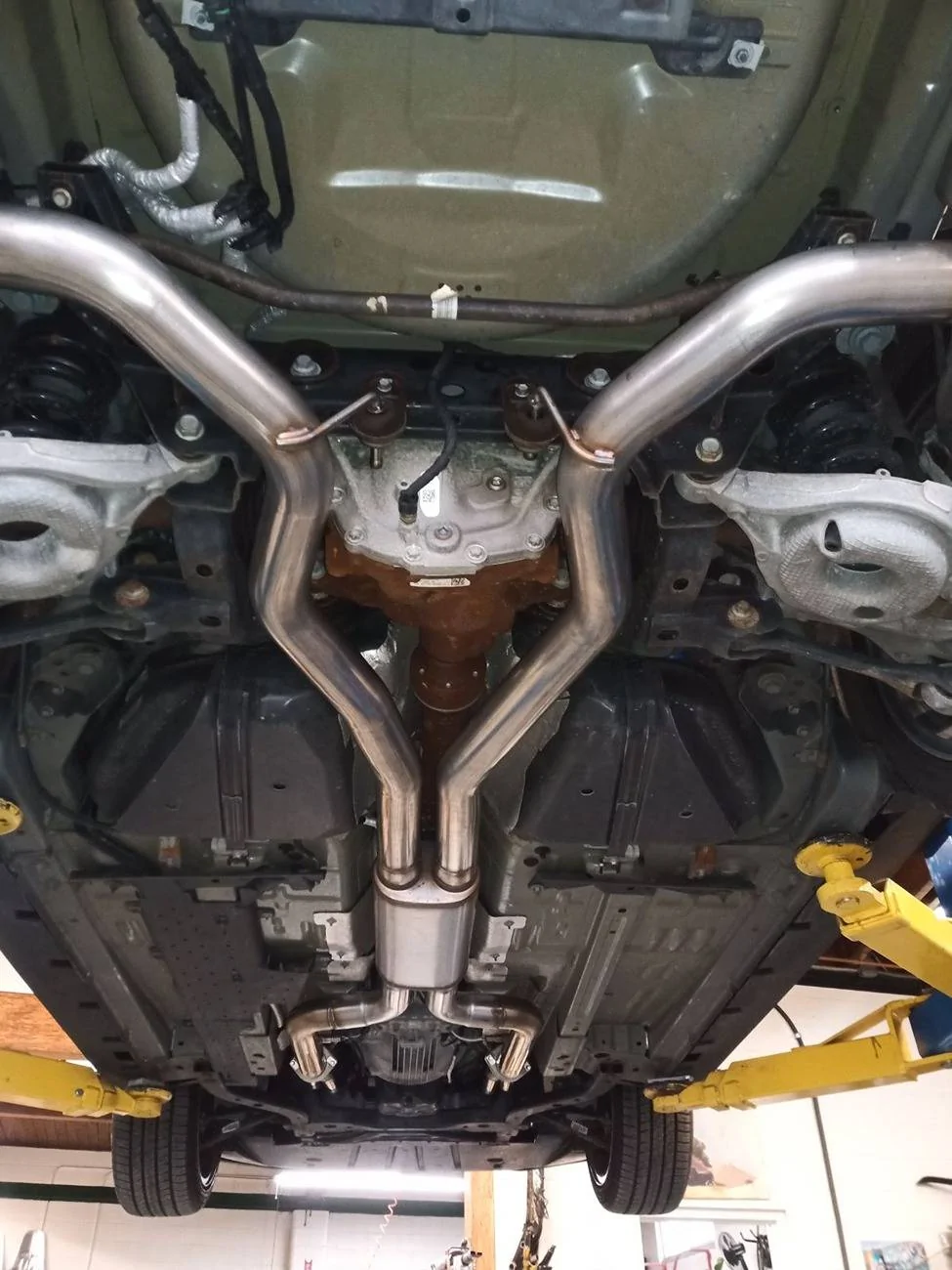

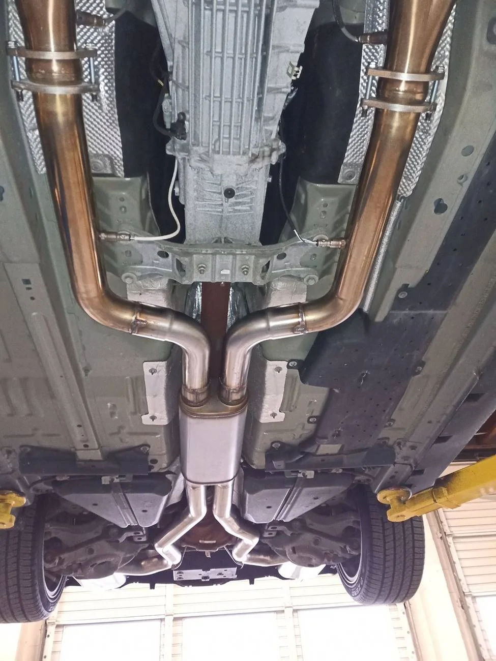

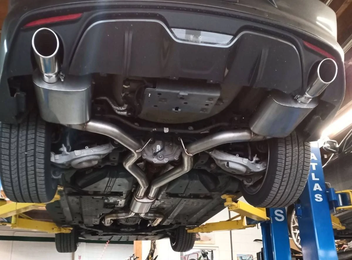

Thanks again to everyone for the discussion and info shared in this thread. Got my exhaust setup finished today after ordering the Steeda 3" catback system during their BF sale.
Asked a local shop to weld all the components together and modify the Steeda pipes to work with the Jones MF2469 X muffler in place of the Steeda X-pipe.
Sounds great and not too loud at all considering how free flowing the system should be. I had a terrible resonance at ~2500RPM with the stock catback + Kooks LTH which has been eliminated.
Can't wait to let it rip on track next season!
Yeah I run the Jones as well with corsas, I love it. I've heard many setups on these cars and I really like what I'm running now the best.
