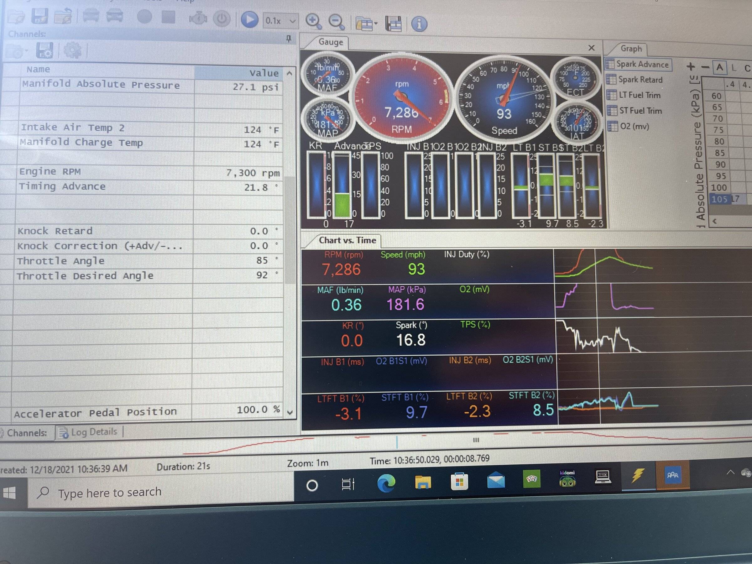

@engineermike looks like the highest I go during a pull is 21.8 but is only for a nanosecond and then bounces around. At one point it does stay consistent at 21.3 but maybe for half a second and then bouncing around. 13.8 psi is the highest I see during the pull and highest knock retard was at -1.5 and correction 1.5 but almost always at 0.
The picture below is about the middle of the pull when timing was highest.

Yea, your timing isn’t doing what I would expect. Who’s doing your tuning?

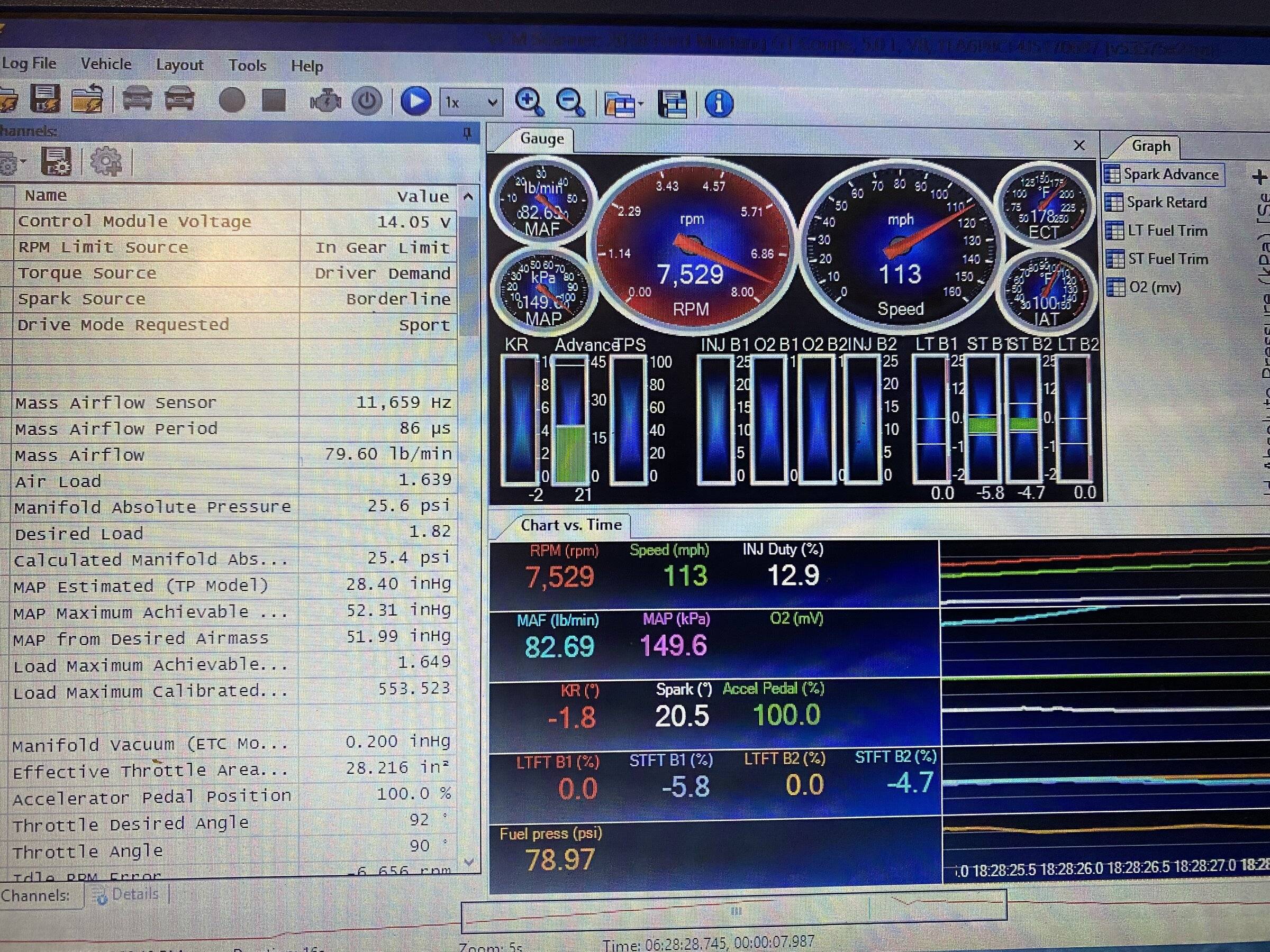

Here is my cars timing , you wanna look at the spark table , positive kr is means pulling timing negative means it’s adding.
This is e30 fuel.

So Mike what should timing in general look like? Is it linear as rpm rises or dependent on boost etc etc? I’m a total noob to the inner workings of this stuff but I do love learning new things. To add on to my prior post my boost seems to bounce around just like the timing does.
Usually when I see a timing curve jump around its due to individual cylinder borderline adjustments. When running e85, I would expect these tables to be zerod out so the timing curve should be smooth and steady. I would also expect higher timing on an e85 car at that boost level.
