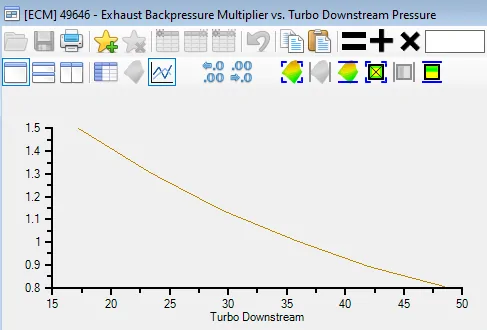

engineermike said:
we just don’t have access to modify it in our strategies.
Turns out I was at least partly wrong. I found this in a couple of ecoboost strategies:
If I understand correctly, the turbo downstream pressure is turned into a multiplier to determine turbine inlet pressure (aka "drive pressure"). This makes sense because turbine modelling often is done using Pressure Ratio.
...Theres are still factory ECU ecoboost on the streets and tracks running great with extensive modifications. So don't think control access is limited. Doing anything turbo back (definitely keeping the stock turbo, wastegate, and boost controler) will not effect the MAP/IAT/O2/Crank sensors enough, such that, actual control of fuel, spark, or air will gain enough error from desired fuel , spark, and air to cause problems.
I believe this is probably true.
