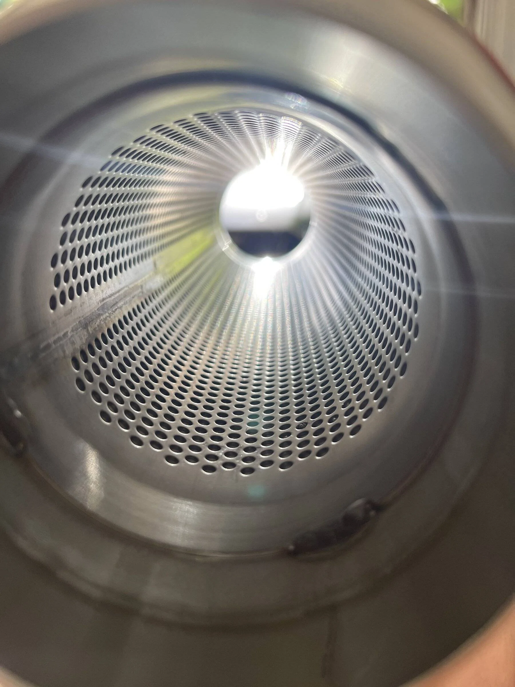

I know early in this thread some one asked for a picture of the inside of the stainless bros dual 3” muffler so here you go!
