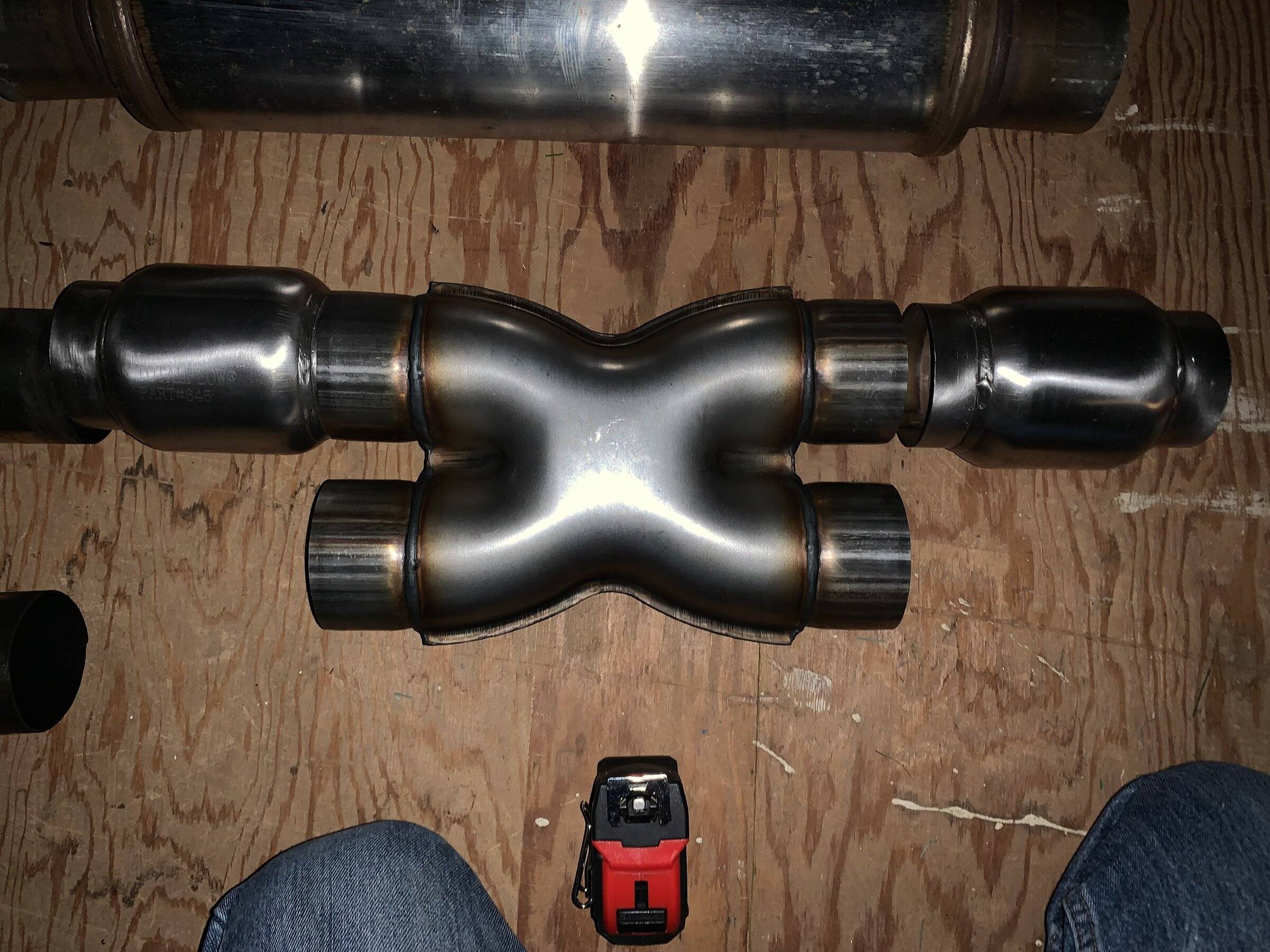

It may be some time before I get to it but I'm going to try this setup in between 1 7/8 Kooks and my Borla S-type. Ebay X section that seems decent and a nice open design (about $30) and the Total flow mini mufflers front and rear. I really want to make the sound level "reasonable" so I'm ready to add mufflers in rear s-type section if necessary. I will consider adding a bung for pressure testing aft of this section. I'd be able to use my wideband bung section upstream of this. I plan to run FBO NA first and then about 13psi of P1X.
I had previously run a Magnaflow 12469 muffler in place of the Borla X section but it was quite bulky and hung too low.

Those stamped x pipes don't flow very well just create turbulence.
