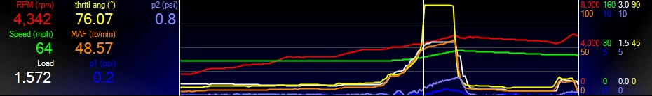

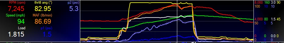

Another update on this science project...I didn't like that my data was using an A/D converter and standalone software, so was not correlatable directly to other engine parameters. So, I purchased the HPTuners Pro Feature set that allows logging of external analog parameters in conjunction with other OBD data. With my current exhaust setup using stock cats but dual *true* 3" all the way, the exhaust pressure data log is shown below with the taps just before (p2) and just after (p1) the cat:
I'm very happy with this, as I never really thought near 5 psi with cats was possible at such a high airflow. FWIW I'm flowing on the order of 89 lb/min (max MAF PID data shown). The stock cats are adding less than 4 psi exhaust pressure here.
Just out of interest, I pulled the data showing what backpressure this exhaust imposes at a stock flow rate:
As you can see, the cats are only imposing about 1/2 a psi at a stock-ish flow rate of 48 lb/min.

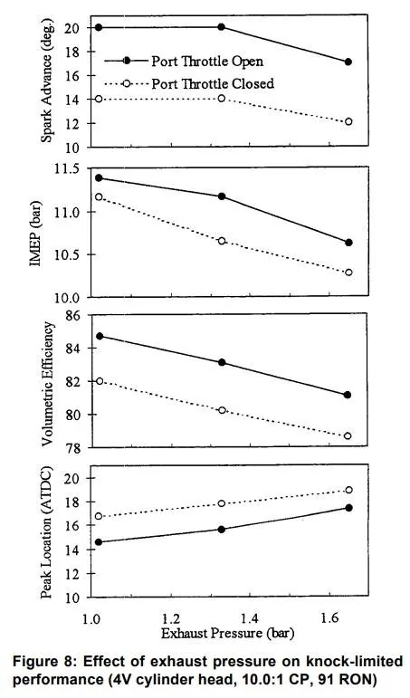

On a final note, with a knock-limited supercharged Coyote, spark timing is the key to making power. The reduction in exhaust pressure of 4 psi should allow about 1 deg of additional spark timing according to the link below and professional contacts, which in turn would make about 20 more hp due to timing alone.
https://etd.ohiolink.edu/apexprod/r...ssion=dayton1375262182&disposition=attachment
I wasn't satisfied with the reference you provided for this correlation between exhaust pressure and timing advance. The paper cited said "Compared to other factors that influence knock, exhaust back pressure does not have as dramatic of an effect, but it is still worthwhile to consider"
But, I found the table in it that backed up what you said. So I had to trace the source of that information down. I did to an early 1996 SAE paper, what it says is in the attached pictures. Mind you this widely cited and used rule of thumb, comes from a test done at a single RPM. They even say very little information is available in the literature back then, and I dont think much more has been published since. They also provided very little information from the test and to me, clearly, the wrong conclusion. The spark advace has a curve and is not linear in both open and closed port, so saying 1° KLSA/30 kPa or 1 ON/30 kPa pressure increase was a poor conclusion for this paper. Too many papers cite this table, and not enough do their own testing.
I still don't think looking at exhaust pressure only says much. You have to measure pressure and temperature to really know whats happening with a gas.
The increase in power due to knock margin is a bonus of lowering backpressure, but far from the sole reason. It's tough to find the quality of data you are looking for to prove a side-benefit of the efforts, but I used what I had to get an idea. Anecdotally, you can see that the ecoboost engines run into knock at really low spark-timing in spite of low compression ratio and GDI. One might deduce this to be caused by the high exhaust pressure. Plus as I also said, and unfortunately I can't share much about this, I consult with an OEM engine calibrator who also told me that reduced backpressure increased knock margin in development engines. Whether it's 0 deg, 1/2 a deg, or 2 deg of margin really doesn't make the effort any less worth-while to me, so the exact effects on knock aren't really work arguing over.
