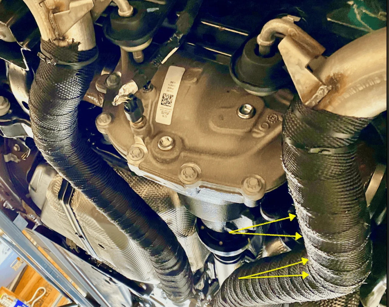

Trans & rear housing, end to end better figure on another 200ft. Two things come into play first the 3" pipe eats up the wrap and the space/overlap. Also every bend the overlap gets tighter and takes more wrap.
Trying to write it, is best seen, Streight area the over overlap is 1" Down in the bend it's less
This right here is 100FT ...
OK, that answers one question. I will have to pick up another package of the wrap so that I can do the trans area, also. Rapid Red did you spray black silicone on that?

No it's dry, Black TITANIUM is the weave. You can always return what is not used. I hate to get going on a project and run short. Like plumbing get more fittings, and have a better chance to finish.
