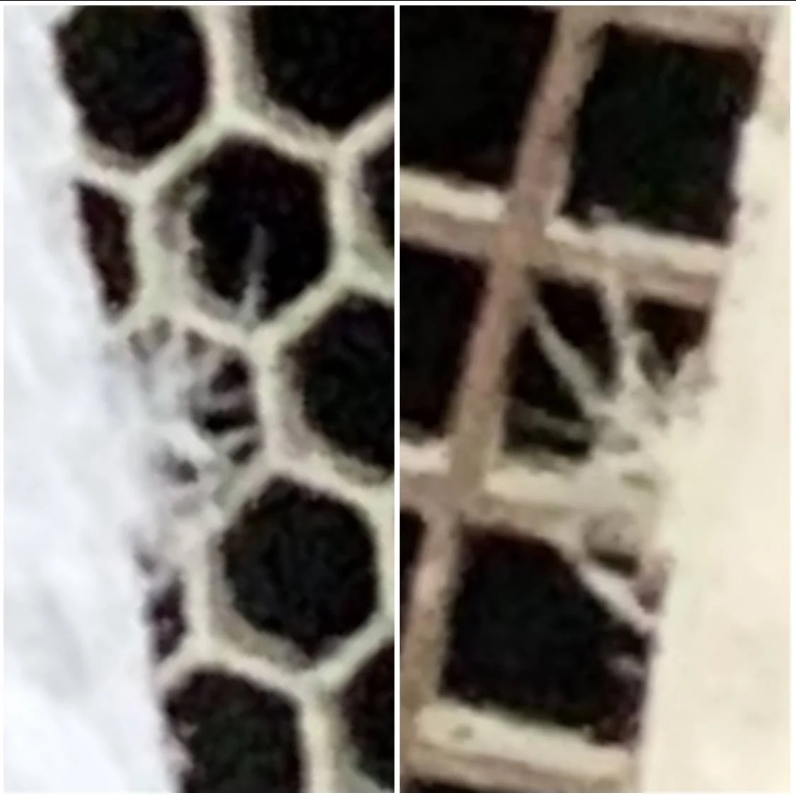

Mesh comparison, gt500 on right. Oh, and they are PRICEY.
