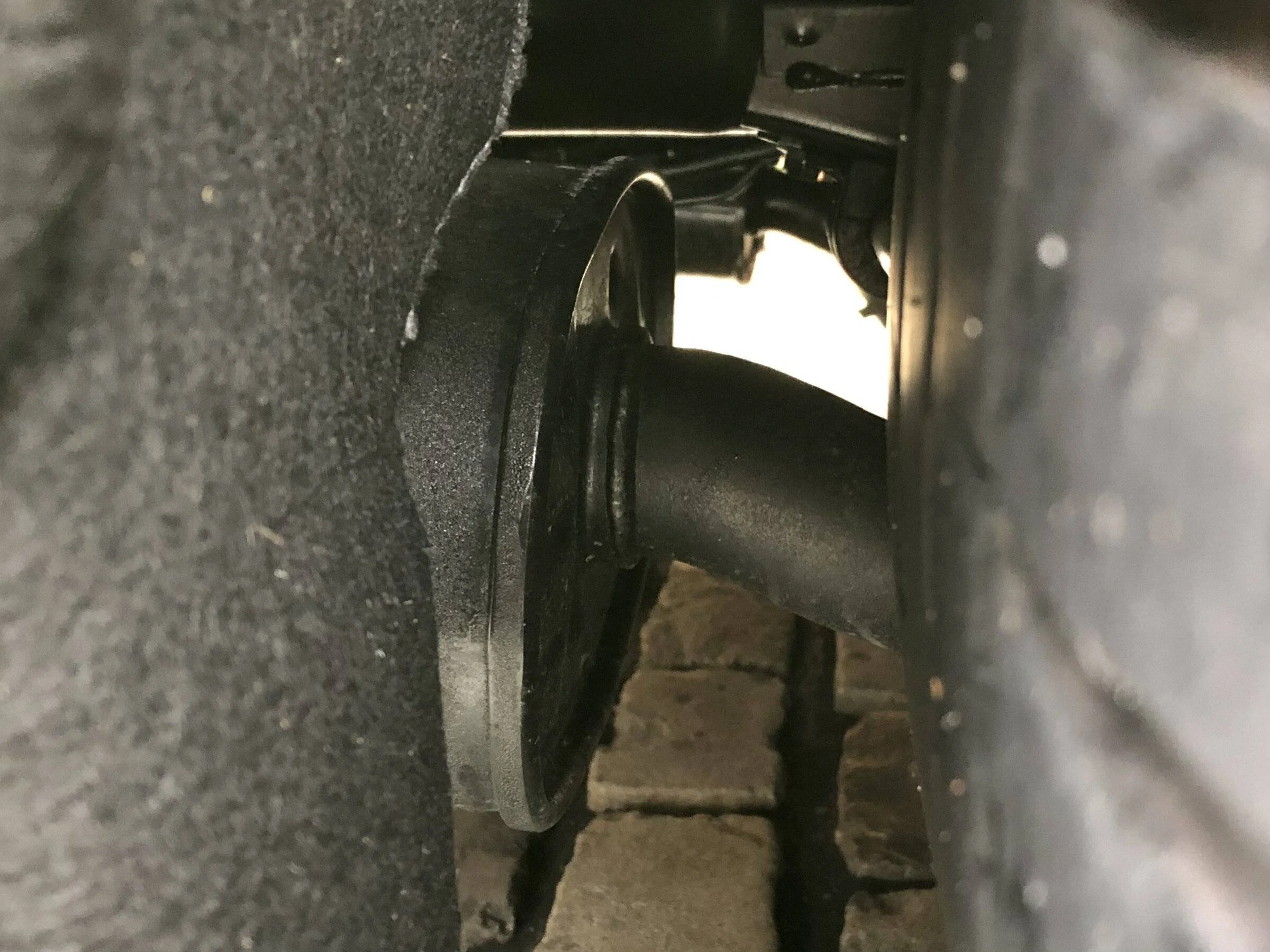

What material are our exhausts made out of and is exhaust corrosion a problem on the S550 (I have active exhaust if that makes a difference) ?
I am asking because our euro cars get a very thick (and inconsistent) coating of black underseal which quite honestly looks a right mess.
It's particularly bad on the exhaust - In some places it has run, partially dripped and then dried. In others it has bubbled due to heat before it has cured, then cured with the bubbles set like mini craters.
As I want to fit the H pipe soon, I'm thinking of taking the opportunity whilst the exhaust is off to paint strip it back to its OE finish. IMHO it will look nicer that way then the 'can't be arsed just spray everything' coating that we currently get ...
